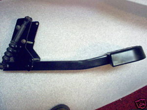

Next time you see a Land Rover Discovery look at the rear step to get in to the trunk. It is a peice of square tubing that runs under the truck in your case to the frame. It has a pivot point at the frame and comes out with a flat step on the end. There is a gas shock that holds it up tight to the body and you just walk up to it a put your toe on it and push down. It drops down and stops a foot or so off the ground. when you get in the gas shock pulls it right back up. It's pretty much the same principal as a stair stepping machine for exercising. They would be very simple to make and you can get cheap short travel gas shocks from SurplusCenter.com.
