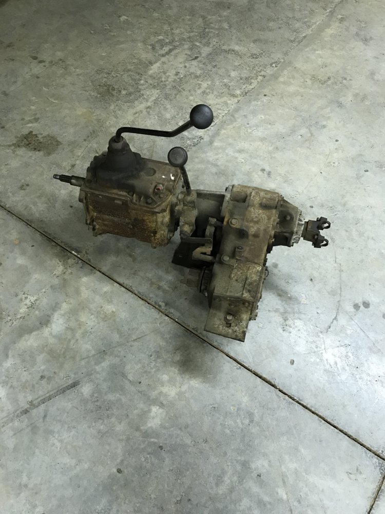

Starting a new build and have both of these transmissions.
Which one should I run?
They both have an NP205 attached
I will be running a Chevy 5.3 engine.
I will likely run a 203 doubler down the road.

Here is the T18
