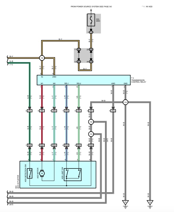

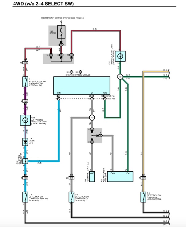

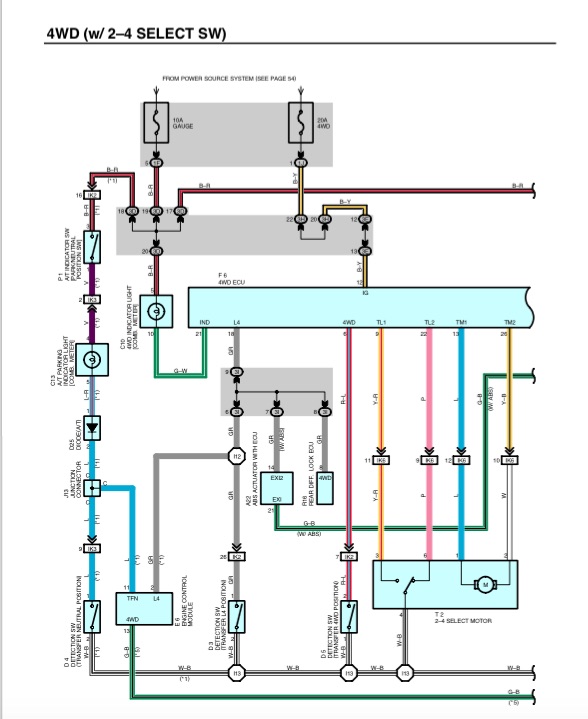

Recently swapped an r150f 5 speed into my 02 v6 4x4 tacoma. Truck came from the factory with a auto and a push button t-case. When I swapped in the manual trans I put in a manual j-shift case. To get the truck running I spliced the park safety switch. I ran the 4low switch to the side of the tcase and the 4wd position switch to the other side. (red blue wire in diagram). The 4wd light is stuck blinking on the dash. It won't turn off. And the front diff won't engage. Anybody have any ideas? Here are the wiring diagrams
Look on Tacoma World. A few have done manual delta on dc and would have to have done the same stuff.
