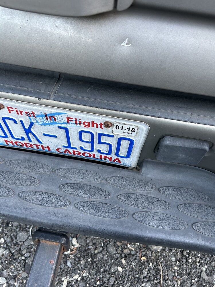

Sure enough I walked in with no line and walked out with the first tag since 2016 for $45 with no questions asked!
