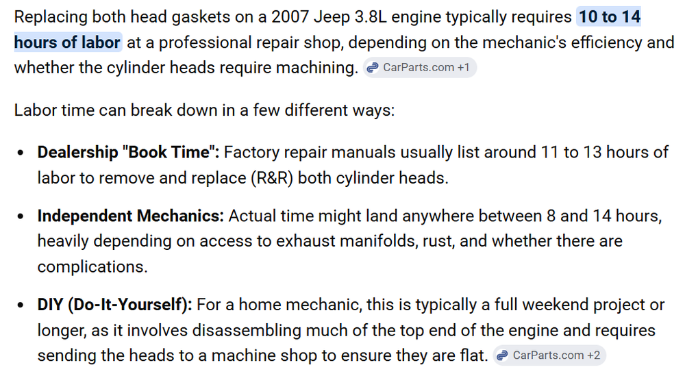

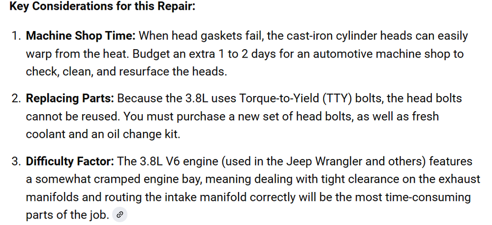

Head gaskets a pretty common problem on it.

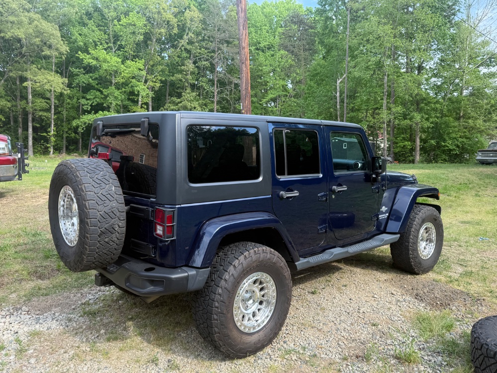

Head gaskets on a 3.8 isn't a bad job. The 3.8 is plenty zippy in a 2 door. Way better than the jku. Id straight up trade my 2012 jku for a 3.8 2 door. Im in the minority in the jeep world but I like the 3.8 better than the pentastar.
Talk you out of it .....?
It's a Jeep.
3.8 has a lot less problems for sure.
