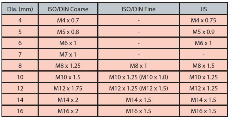

Something like M10, which could be 1mm, 1.25mm, or 1.5mm thread pitch.
Like ^ said, M10 is the one that came to mind without researching. One of them uses M10x1.5 and the other uses M10x1.25. Good quick read on it here with charts:

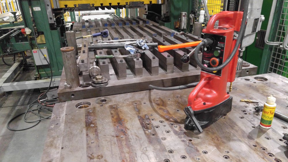

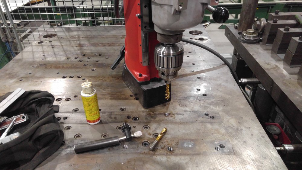

Anything I'm doing production gets higher end machining quality stuff.
This type is really efficient.
Particularly when you need to do stuff like this:
2 inch thick. Bottom tapping. One lid a night. One new tap per lid, times 12.
Bout 480 holes total. All power tapped with the magnetic drill.

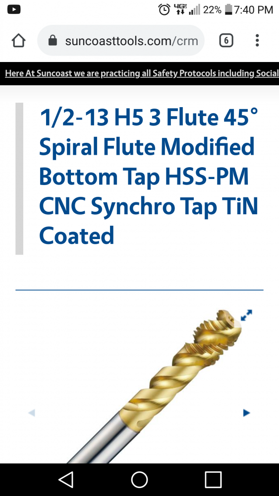

The best part about spiral flute taps is pulling the chip out the top instead of pushing it. They are really designed for blind holes, but work pretty well in most materials depending on the grade of tap. They definitely aren't what shawn is looking for, ha!
Those of us w/ Jap vehicle, and sepcifically 80/90s Toyota knows this pain well.
Basically m6 and m8 are the only ones that are the same between a Eupoean and Japanese spec bolt. Anything bigger or smaller is different. And also, not so relevant to this thread but an equal PITA is that the hex socket head sizes are different (e.g. m8 = 12 J spec and 13mm E spec)
95% of the time you just go to a ardware store and get a 10mm (M10) bolt, its goin gto be E-spec. And most non-auotomotive metric applications encountered in daily life are E spec.
My experience with also huntin gto tap & die sets is that if it is both SAE & metric it it is rarely J spec metric, and rarely does a single Metric set include both unless it is an exhaustive set of everything.
Also - that chart is wrong. JIS M8 is definitely not 1.5 thread pitch, it is 1.25,

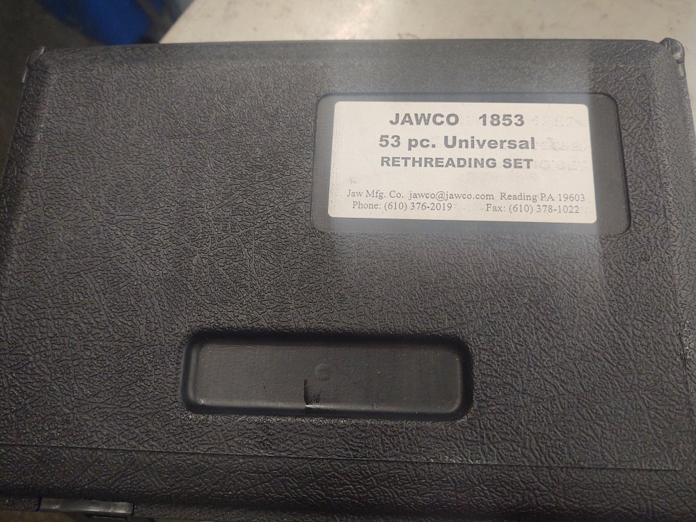

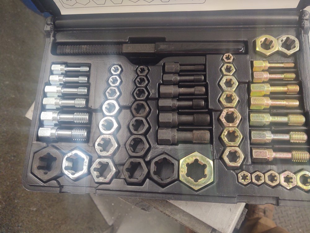

I really like this Jawco set for doing thread repair, saves more of the threads than a typical tap/die set.

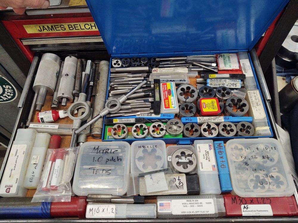

Some of my metric taps and dies.
