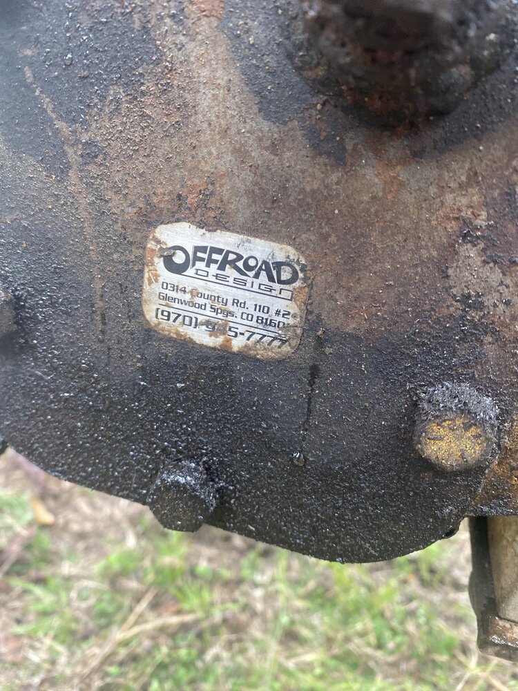

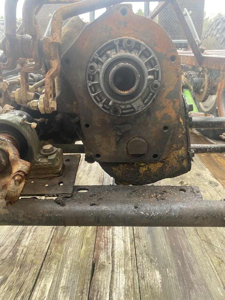

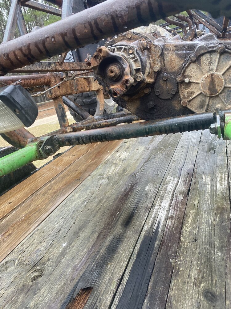

Can anyone tell me what this setup is?

Looks like a 203/205 doubler
Yeah its a 203/205 doubler.Looks to be a 32 spline input on the 203 rangebox which would be for a Th400 or post 1981 SM465.The easiest way to tell a 205 in the future is by the round plate on the back w three bolts in a triangle shape.
