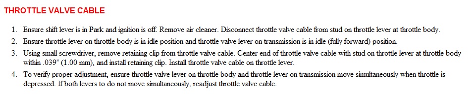

clear as mud. directions for 98 1500.

With the throttle fully closed, unhook the TV cable from the ball stud. Pull the slack out and note if the retaining clip (where it connects to the ball stud) aligns with the stud or if it is fore or aft of it. It should align exactly beside the stud. Adjust it until it aligns perfectly.
If you want to quicken the shifts and add a little additional line pressure, adjust it so it takes just a ____ hair of throttle opening to align.
Let me know if this helps and I'll do my best ol' buddy

Jody, what you printed was mainly how to adjust the throttle cable. By combining your info with what I saw on AllData I found that my throttle cable is slightly out of adjustment, and I need to correct that before going on to the TV cable adjustment. So, your info was very helpful and I thank you for steering me in another direction.
Once I get throttle adjustment right the TV cable should adjust easy. Now that I understand what all is involved it seems relatively simple. I believe the main problem was my being so focused on one particular tree that I simply couldn't see rest of the woods.

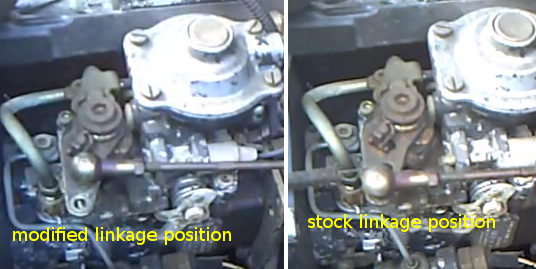

Following the manual, I had to backtrack into the linkage adjustment as far as the low-idle setting and work my way up from there. With the low-idle setting tweaked in I moved on to the throttle cable settings which had obviously been modified at some point before I owned the truck.
First of all, was a linkage modification that I returned back to stock position (just a picture, not my truck).
A youtube video shows it as a performance modification. I have been driving it that way for a long time, but after putting it back to stock position I have no idea what, if any, the advantage is. The throttle pedal is much smoother, and at my age I like comfort far better than performance.
