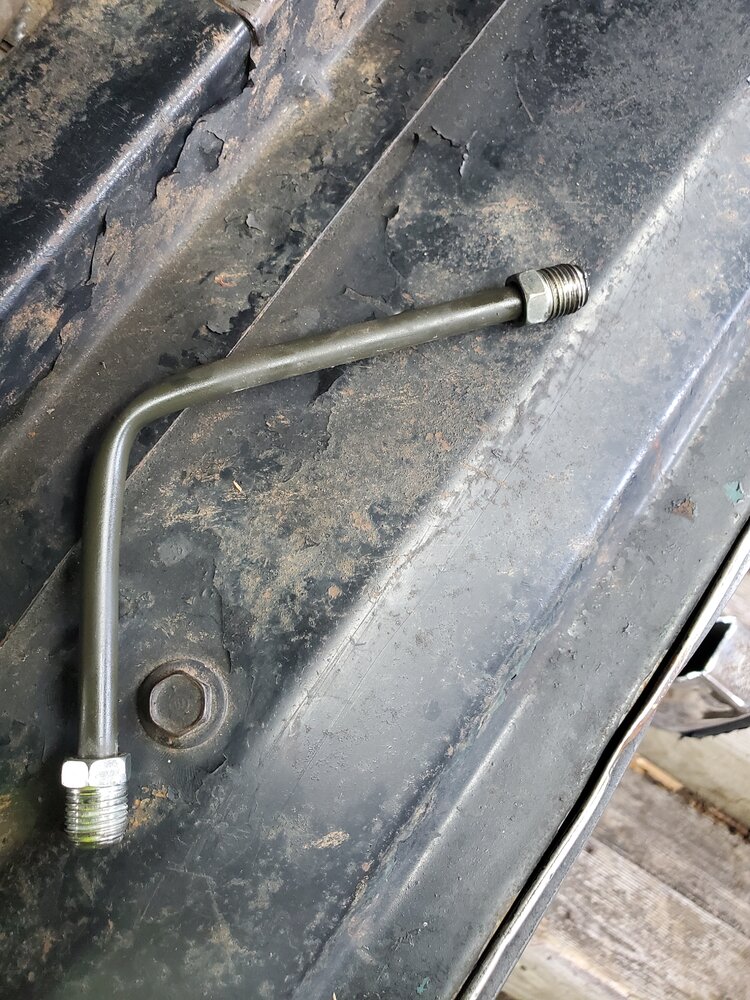

Pulled it in the shop tonight to look it over. Vent is clear. Dipstick is tight, but im not sure it's seated all the way. I'm not seeing any pinched lines, but it looks like a coupler is dripping a little.
Hmmm
