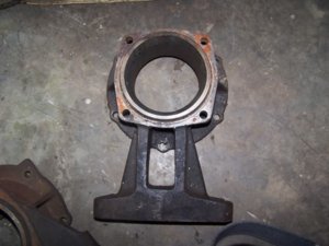

Here is what I have. Probably 2.5" to 3" thick Im guessing without it sitting in front of me.

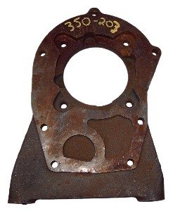

And here is a 203 to 350 adapter and its supposedly 1 3/8 thick so I guess thats the difference provided that the 208 and 203 inputs are similar in length. Looks like I'll be buying an output shaft.

The 350 for the 208 has it's own output shaft.It was a one or two year only deal iirc,like 1981/82.The 203 adapter is only about an inch or so thick so the shaft for that trans will be shorter.
Then it would have 6 bolts and not 4. Most 208's came behind a 700r4, same bolt patern, different input length.
Your correct on the bolt count but most Th400's had 208's behind until the 241's came out.All the Mil CUCV's had Th400's and almost all of those had 208's.
