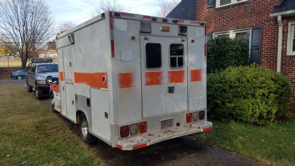

So I'm purposely not calling this an RV conversion (for now) because I don't know how close it will end up being to an RV. The full scope is still coalescing, but here's whats firm.
This rig will be a base camp for outdoor activities. It will have Jeep towing capabilities, room for motorcycles inside, be a dry place to sleep when the rains make tenting miserable, and storage for all the equipment and tools needed for an extended back country trip.
It will be RV enough to be titled as an RV though.

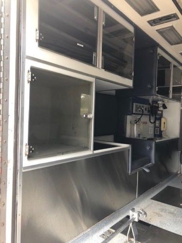

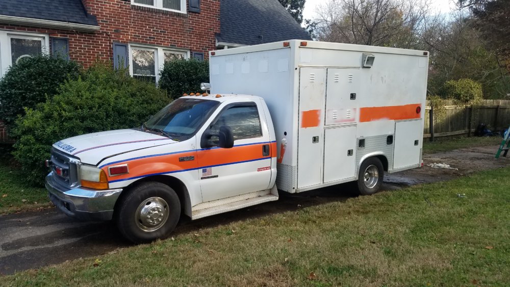

Here's what showed up:

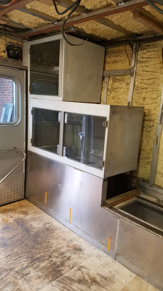

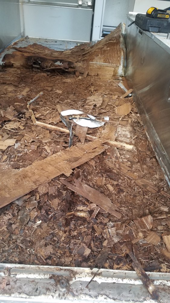

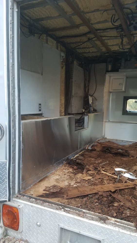

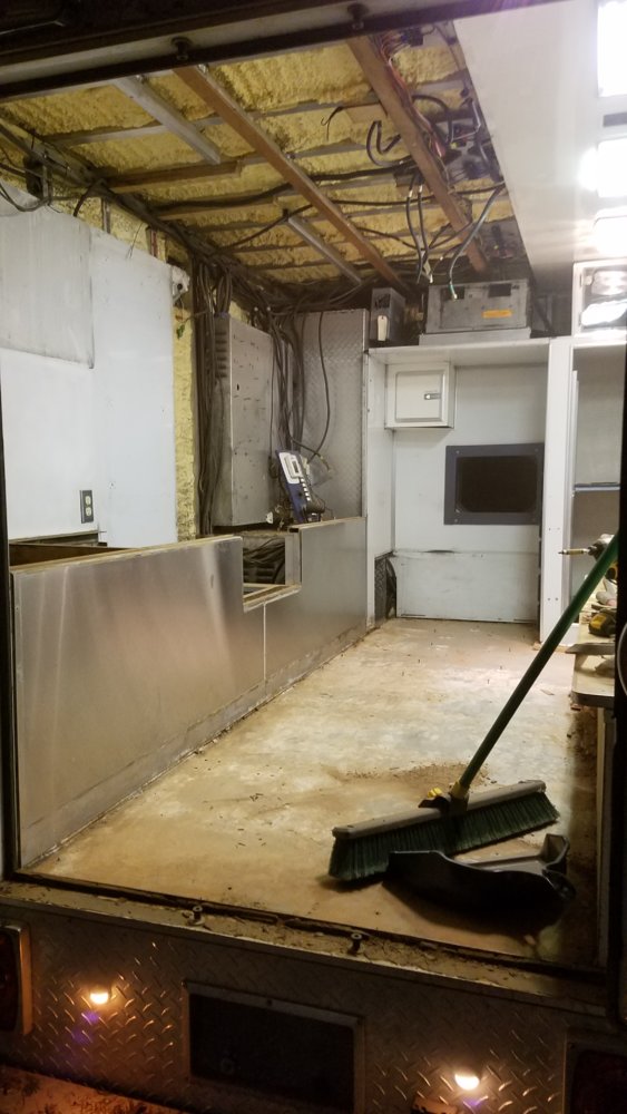

Then the real work begins. Full interior gut:
As you can see, I pulled a @Dylan W. and managed to find rotten wood in a box made completely of aluminum.
I got all of that cleaned out, but likely have the HIV from whatever liquid soaked into the floor enough to rot it all out:

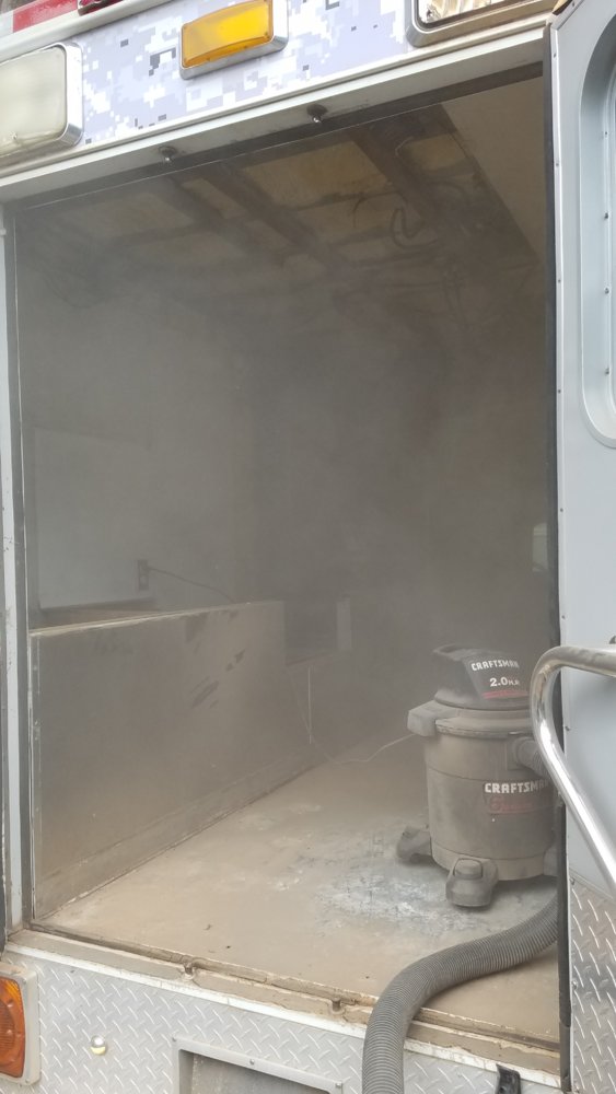

This unit was originally built for San Angelo, TX. all of the hidden areas behind everything was filled with super fine dust; well beyond the filtration capability of my shop vac:

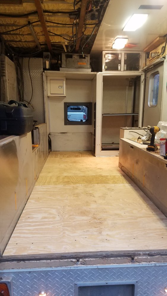

Then today I put in a fresh floor:
The interior build starts tomorrow.

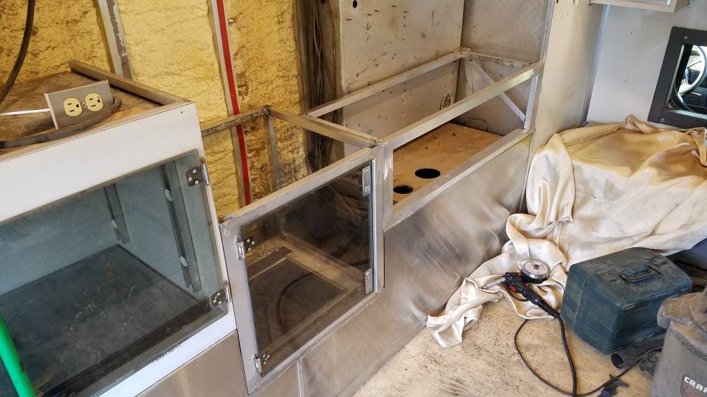

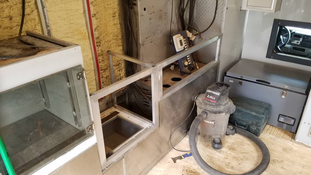

Didn't get as much done this weekend as I'd hoped; my metal order for the rest of the cabinets was delayed and then I promptly ran out of splatter gun wire on Saturday morning.

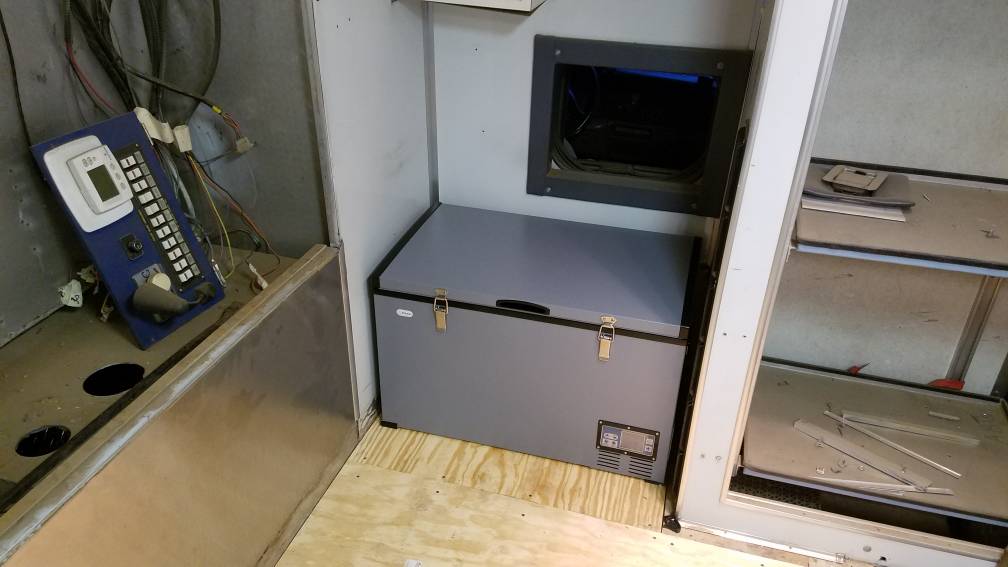

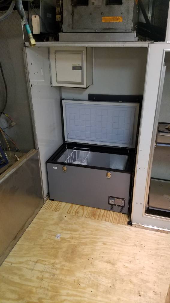

A few updates... the beer fridge arrived. Still needs to be bolted down.
And I redid the main lighting to cut power consumption and gain back some headroom. The ceiling is temporary screwed in until I can trim it out better. Will end up getting painted as well.

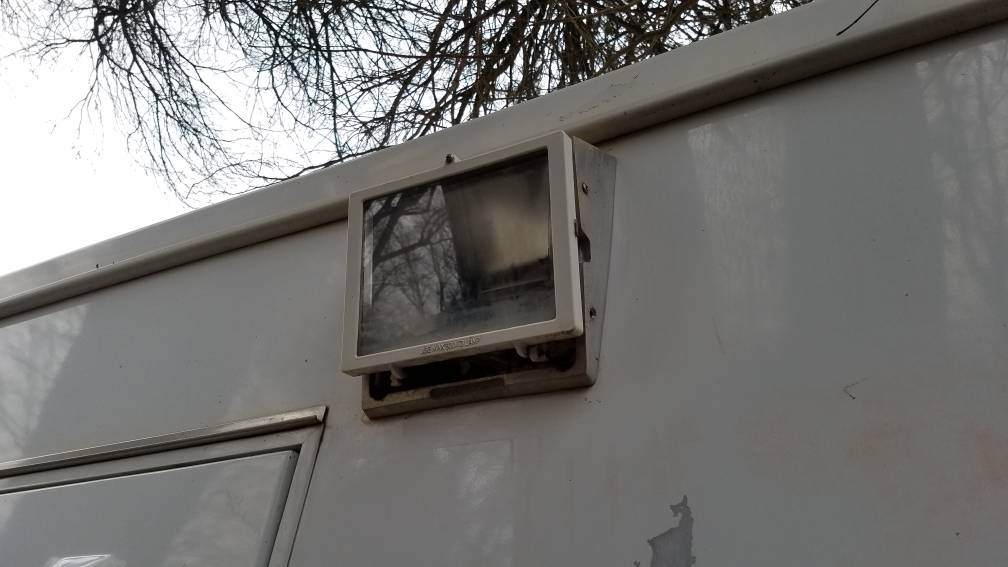

The box has work lights on both sides. They are halogen, and only work on shore power or generator.
They also don't seal in any way, and was the source of a rodent infestation prior.

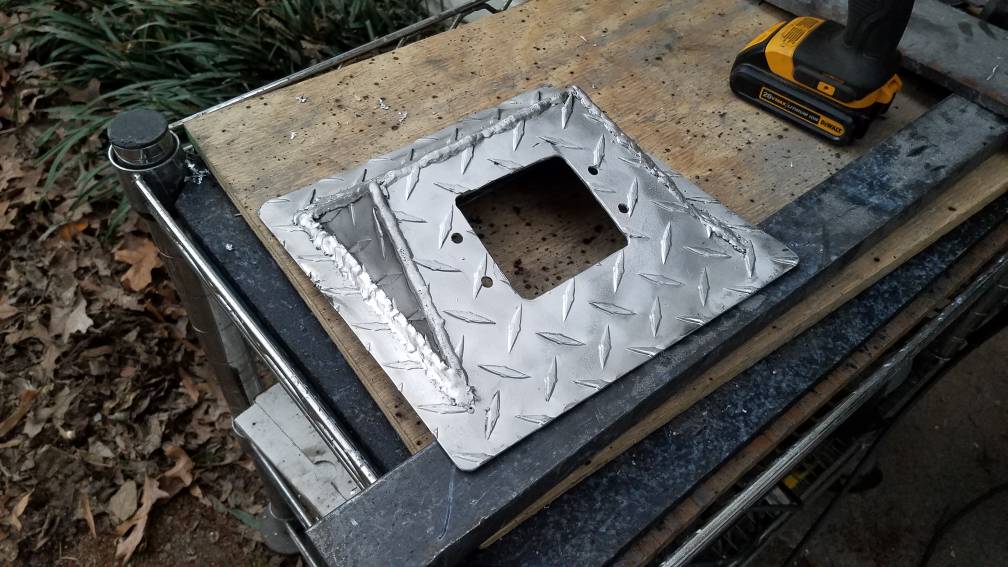

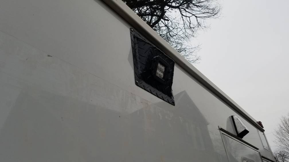

I decided to make some housings to put cheapo LEDs in so I could run them via the battery only
Ignore the art project quality aluminum welding.
And installed to seal it up:

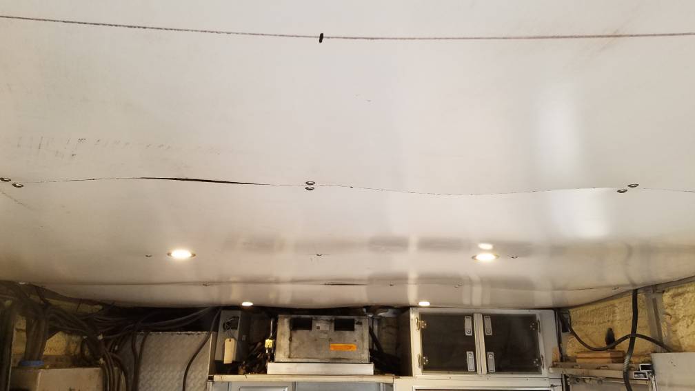

The hardboard that I put in originally was reasonably flat when it went up, but a few temperature and humidity cycles have it looking hella wavy:
The issue is that the ceiling frame height is 6'1". With boots on I am 6'63/64". I'm trying to retain the ability to stand up fully, so I need a stiff yet thin covering. I'm debating a tensioned fabric, but I'm having trouble visualizing how to execute it, and to mount the lights through it.
The original ceiling was fiberglass. This is an option but will be fairly expensive.
Any ideas?
