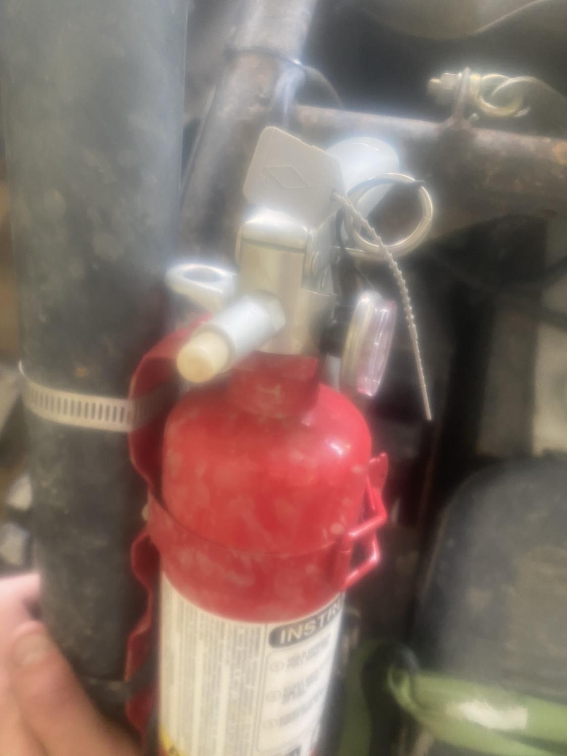

I use small flexible plastic vacuum cap inside the nozzle to keep mud and wasps out of the business end of my extinguishers.
I was worried I’d forget to pull it in an emergency and it would get stuck.
That extract thing happened, it blew the vacuum cap directly where I was aiming like the wad from a shotgun shell haha.
Sorry for the blurry pic, I need a new case.
I check all my extinguishers once a year, remove them, shake them, if the chemical has settled, I smack them with a dead blow to get it moving again.
