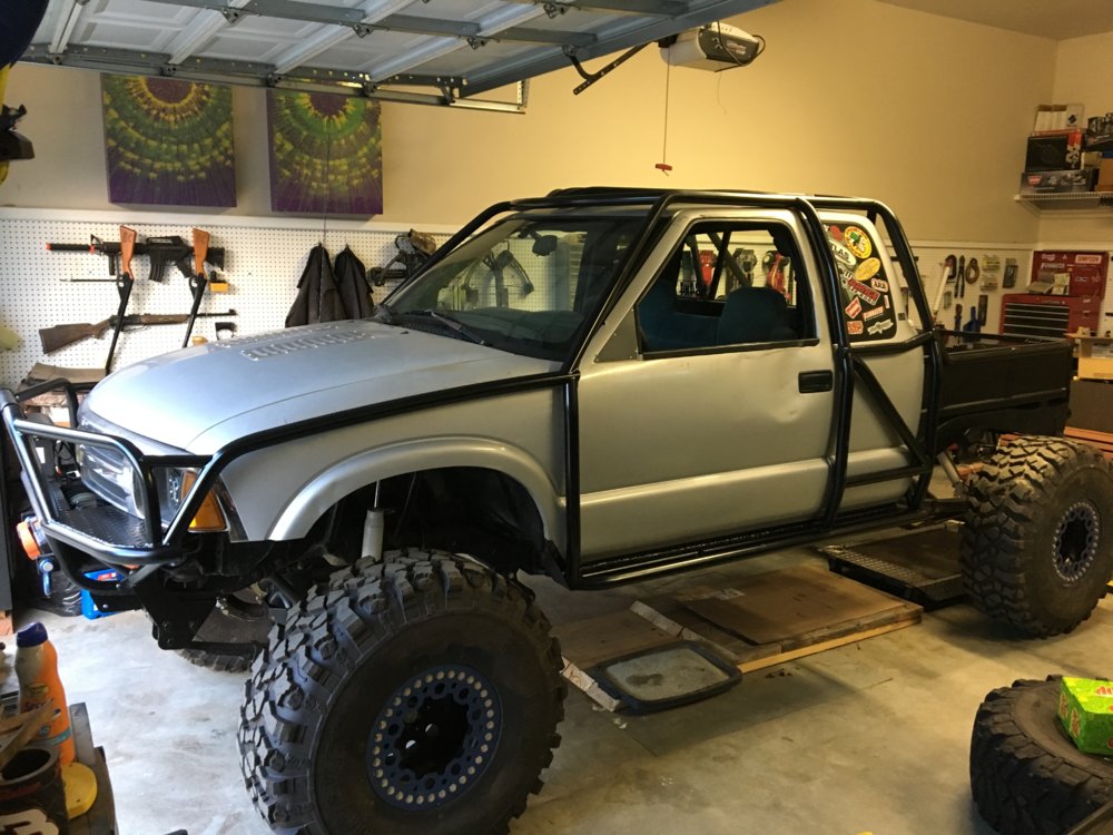

Current status before the tear down.
Already have a built 4L60E in the truck backed by a 4.3 Atlas II. Both of those will be retained to mate to an LS (yet to be sourced). I also already have a pair of CUCV tons I bought a couple months ago.
They’re poster children for Blue Torch Fab already decked out with trusses, diff covers, and hi-steer arms. More to follow over the next 2 years or so...

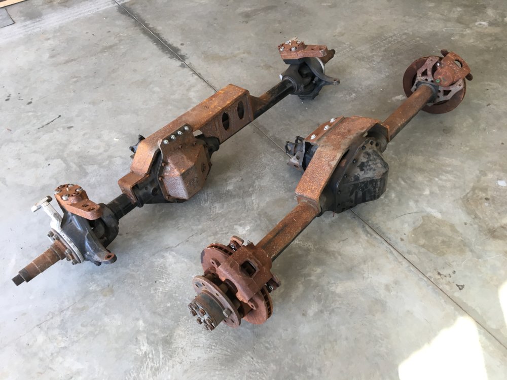

Specs on yota's
FRONT
1985 Toyota front axle with 1995 IFS hub conversion, 58" WMS-WMS.
Trail Gear diff armor.
RCV Performance Ultimate 30 spline CV axles.
ARP Hub studs with AISIN hubs and RCV hub gears.
Trail Gear Knuckle Safe Wiper Kit.
Front Range Offroad Fab brake mounting kit.
1996 V6 Tacoma Duralast Rotors, Calipers.
Trail Gear high steer arms.
Barnes 4wd perches, 5/8” U bolt flip kits, and spring plates.
Hi Pinion V6 Third Member from Trail Gear with Nitro 4.56 reverse cut gears and a Spartan Locker. Grizzly 29 spline yoke double drilled.
All the seals and gaskets were replaced when I built the axle with Marlin Crawler stuff.
REAR
1994 4Runner rear axle.
Rear disk swap using Sky's offroad brackets, K1500 front rotors, and GM G-body front calipers/pads.
Barnes 4wd perches, U bolts, and spring plates.
V6 Third Member from 4Runner with 4.56 gears and a Spartan Locker.
I also have a spare V6 third, 4.56 gears, open carrier as a trail spare.

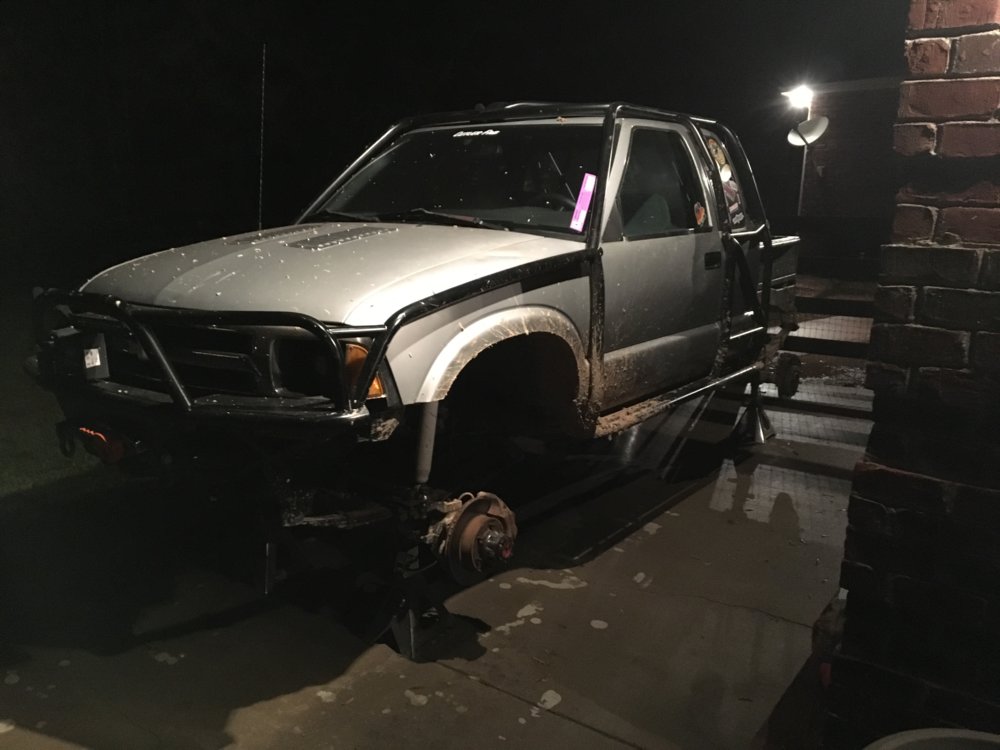

Sad day in the neighborhood. Back on jack stands. Tires and wheels are gone!

About had me going crazy for a moment...
Thought some grab your wheels and tires...
Went back and figured it out.
What size wheels are you going to use next?

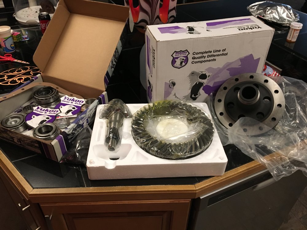

FedEx dropped off lots of purple parts today! Yukon spool, 5.13 thick cut gears, 12 new R&P bolts, and the master install kit. ECGS got me headed in the right direction for my 14 bolt.
