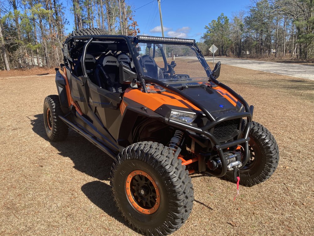

Figured I would make a thread on this. Bought it awhile back to try the side by side thing. It is a 2016, has over $12k in add on parts, gear reductions, Hill killer front diff, custom cage, bead locks, 32” Evil tires, lights inside and out, HD prop shafts, billet carrier bearing, aftermarket assassin's clutch, 2.0 axles with spares, high clearance arms, HD ball joints, LED headlights, fire suppression system, winch, windshield, stereo with sub, 6 way harnesses to name a few. It has been well cared for and service regularly according to previous owner. From tear down, it appears he was correct.

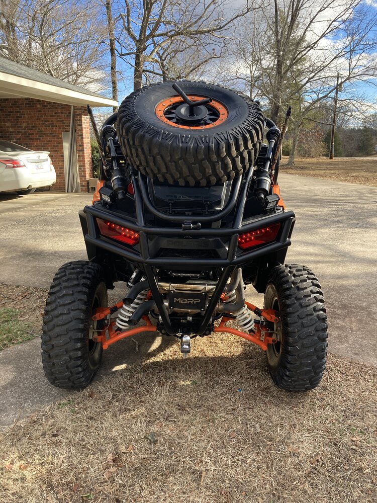

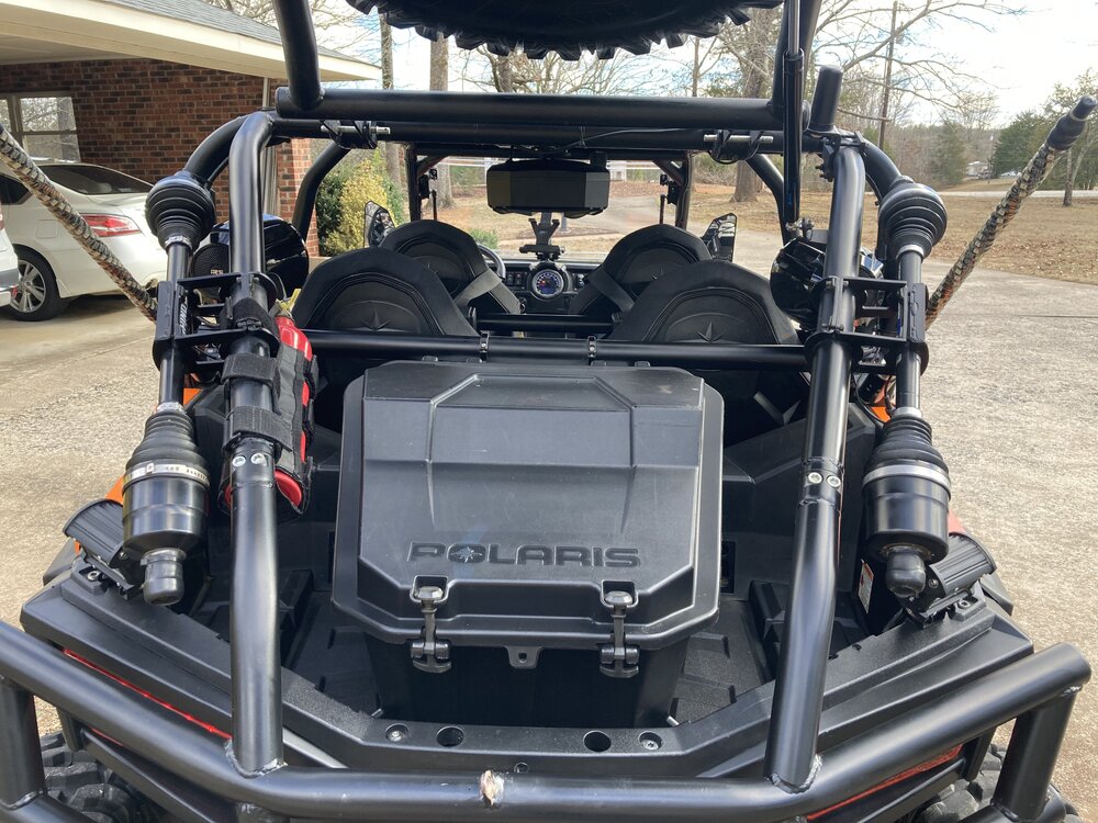

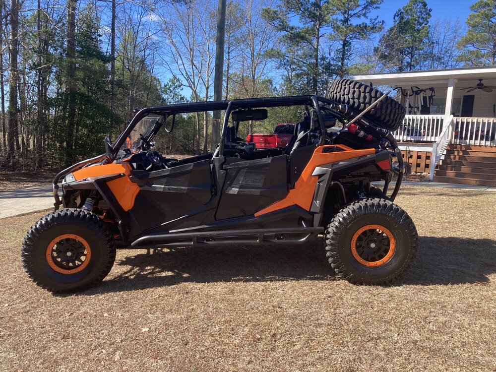

Here are a few pic
Thought about buying a cheaper one and building, but getting older and too many projects and this one was priced in line with most stock one I was looking at that were a couple years newer. Overall it was a smoking deal with all the mods.
Stay tuned, to see how the “first get to know it” ride went. Most probably know from another thread, but we get more in depth in this thread.

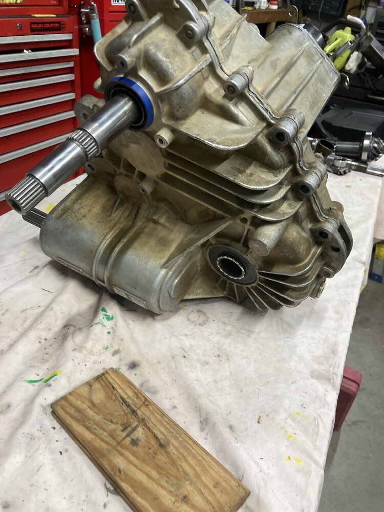

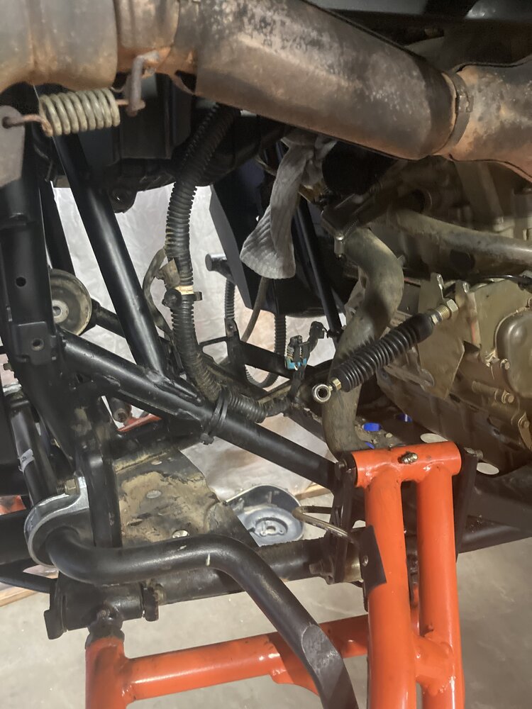

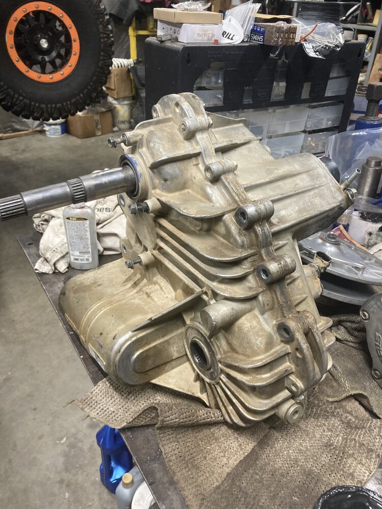

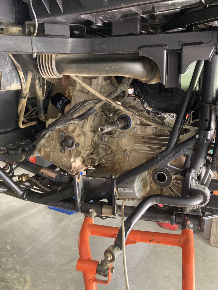

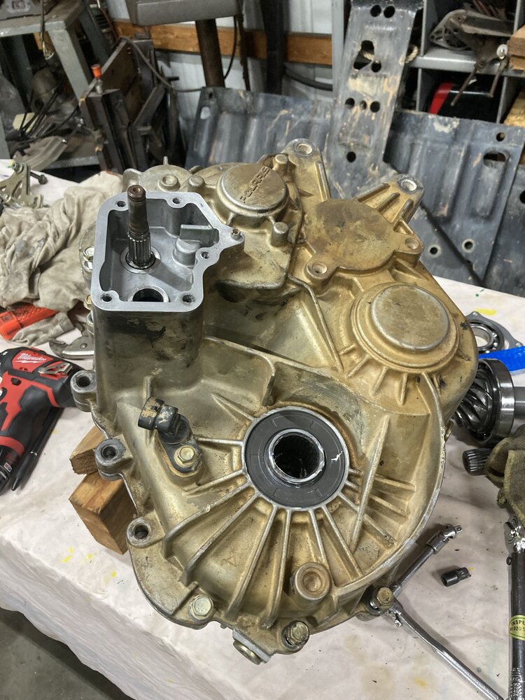

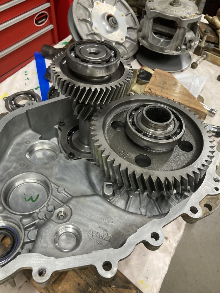

Back at home, after more investigation, determined it was in the transmission. After some utube videos, out comes the transmission which is not a fun job.

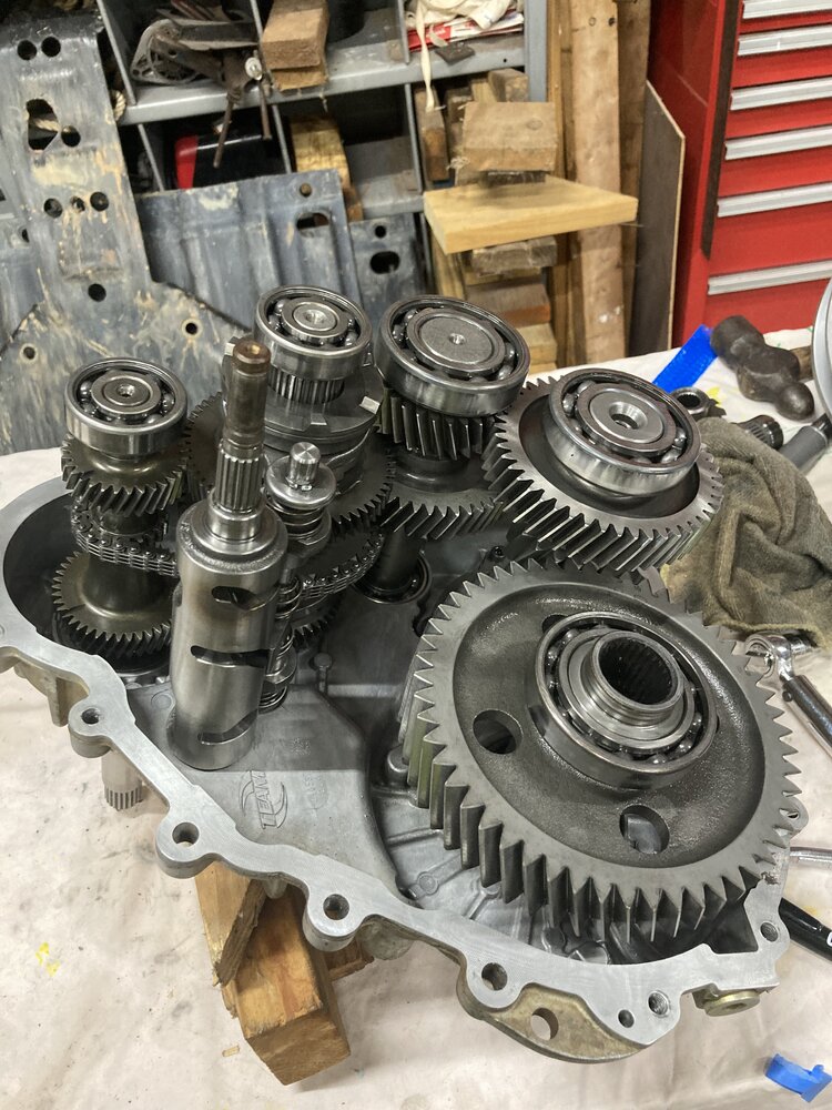

After the tear down

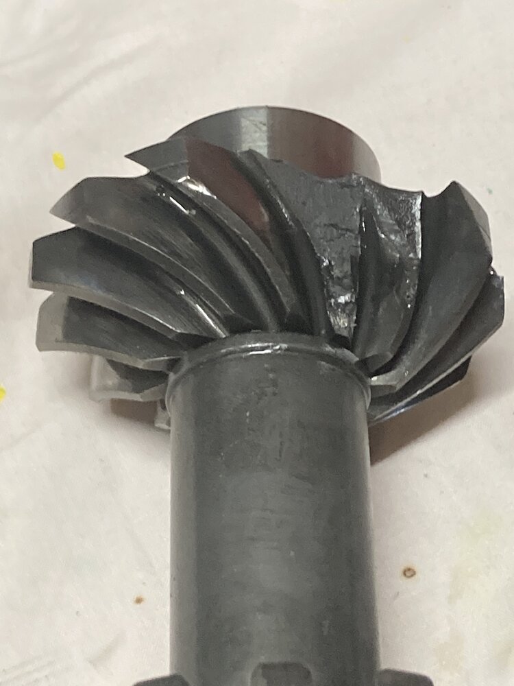

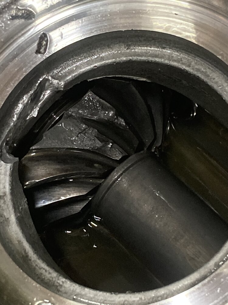

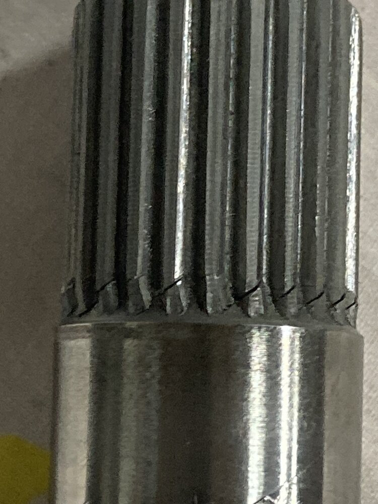

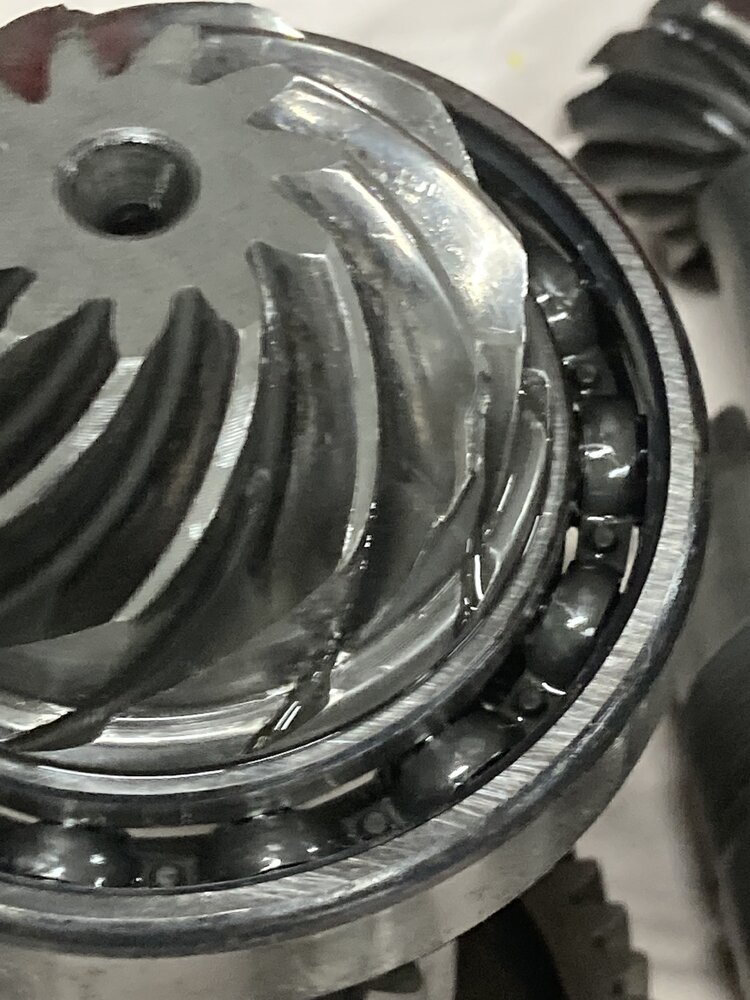

I find this.

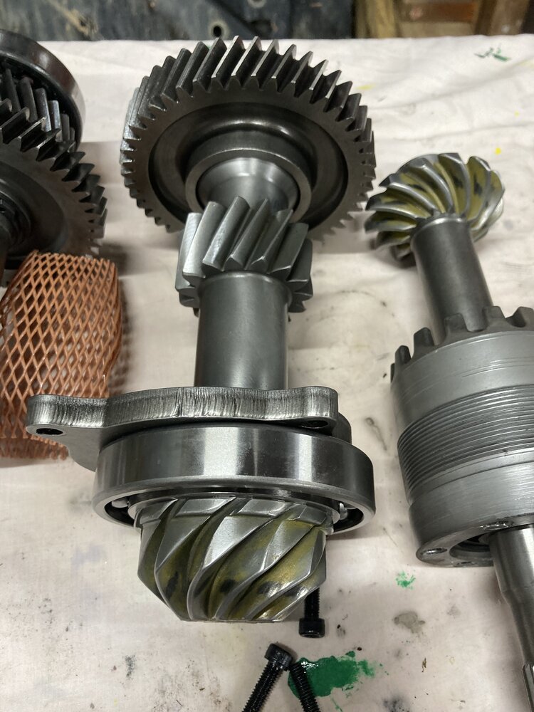

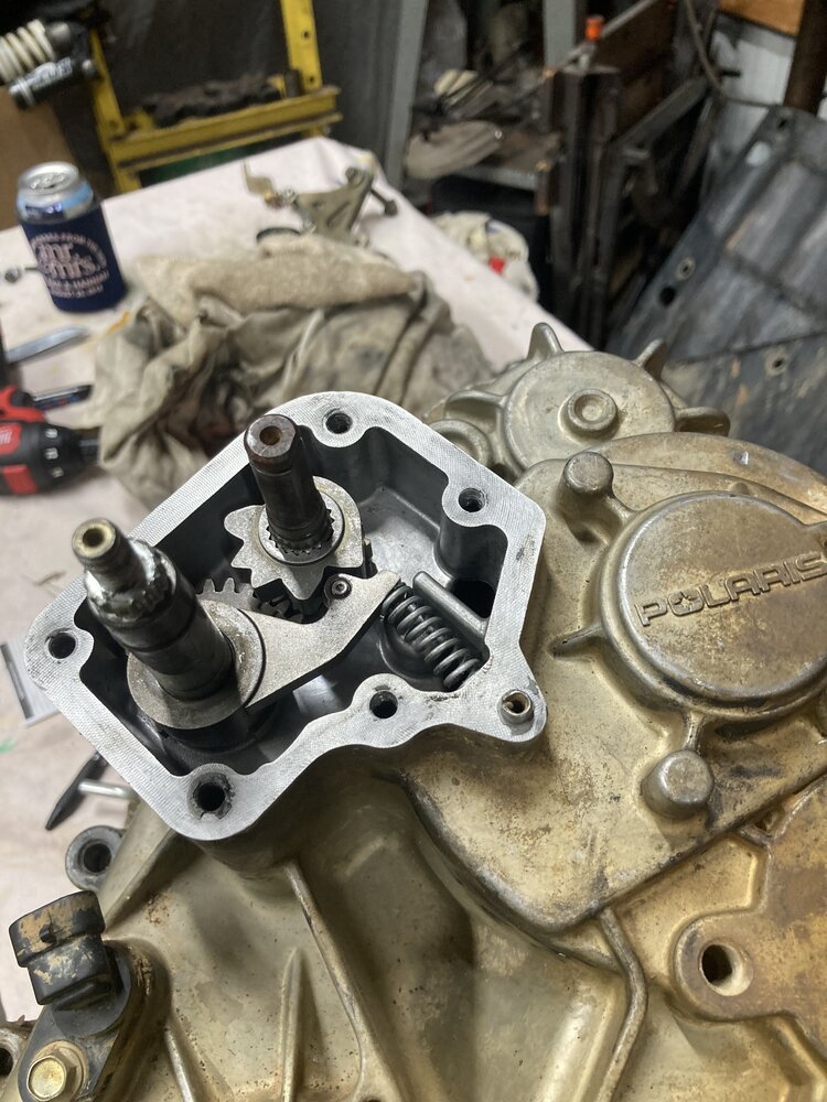

Then, after disassembly of the snorkel gear on the output shaft I find this.
This just got extremely expensive. Stay tuned.

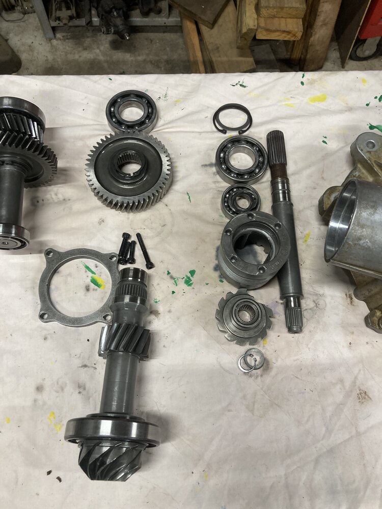

Yup, I know that very well now. Not sure it there was not a small issue prior to the failure. I ordered new HD shafts and gears along with a new snorkel bearing and all new seals.

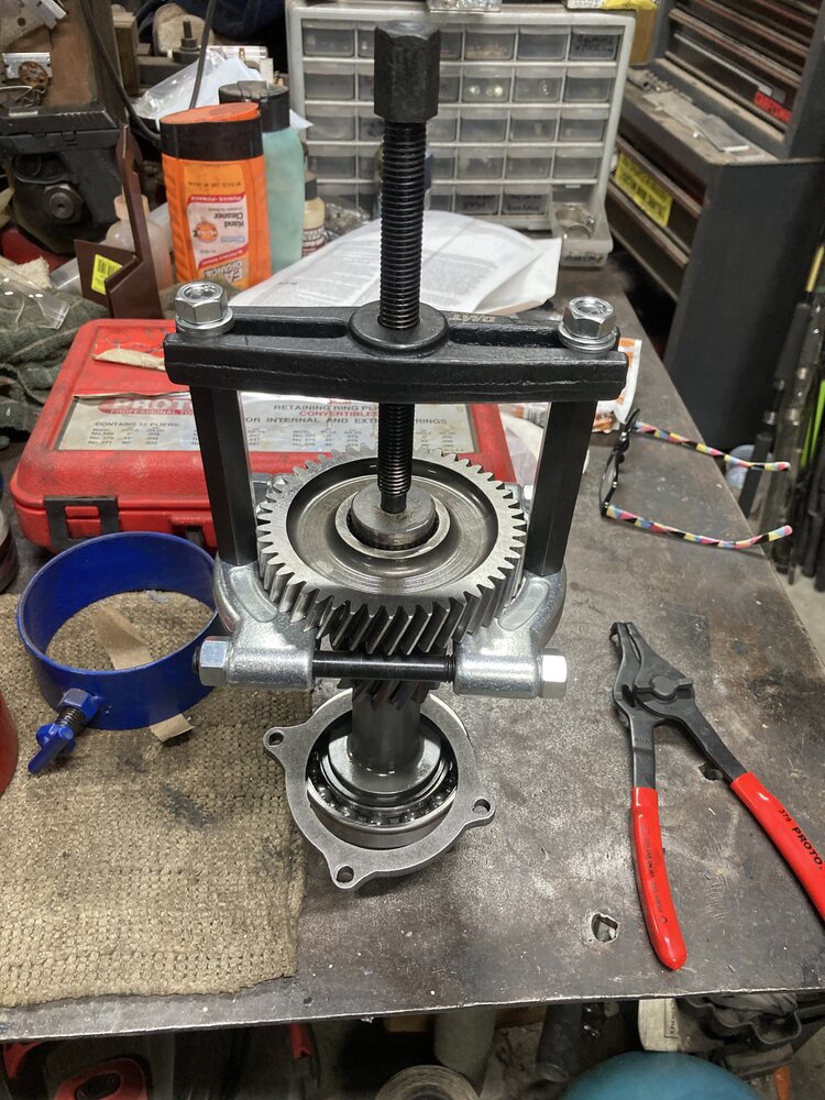

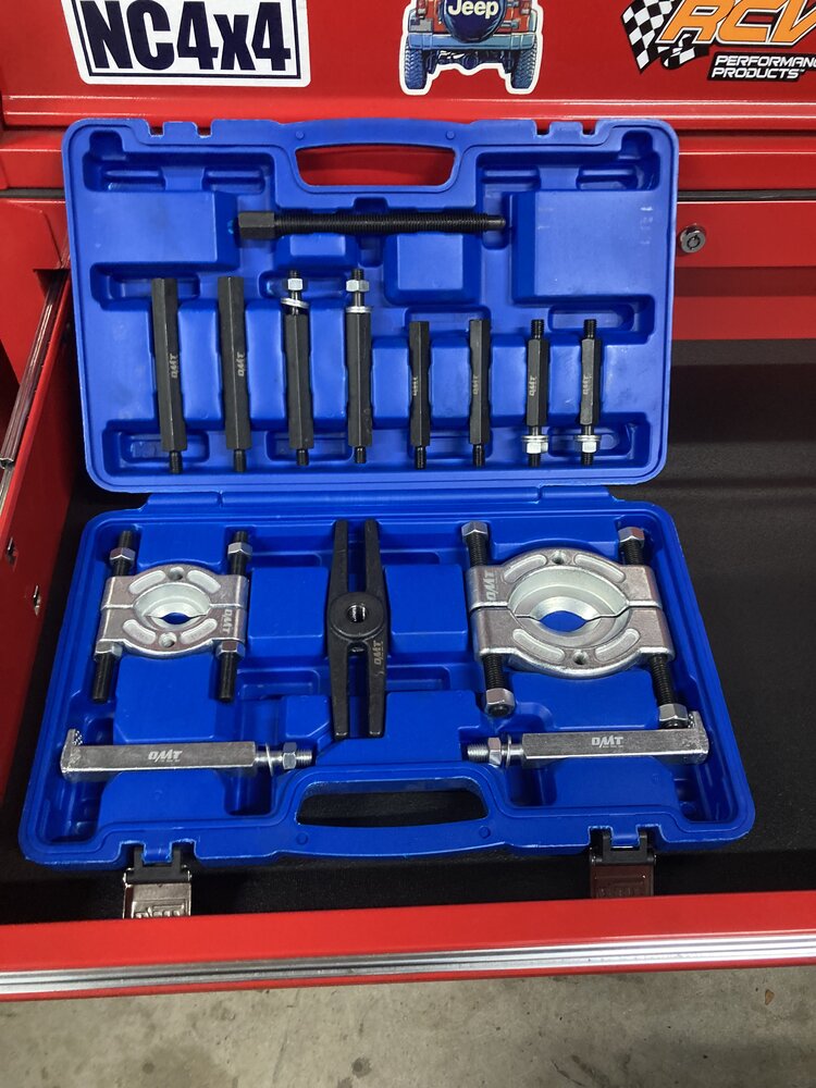

Had to pulled the gear gear and bearing off the main shaft. This $40 Amazon gear puller is nice. Good quality.

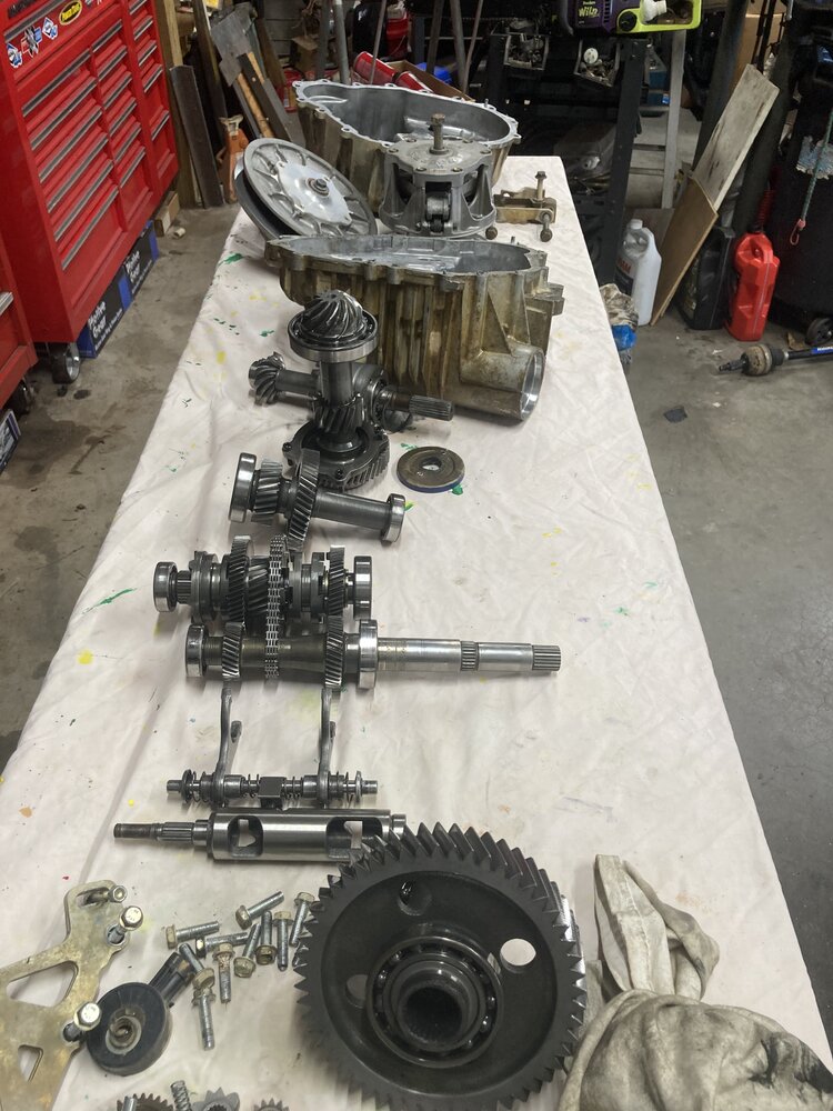

Got everything dissembled.
New parts assembled and ready to go back in.

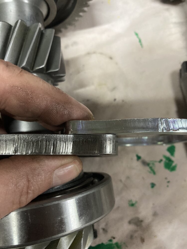

Here is the "heavy duty" retainer ring they sent for "free" . Must have sent the wrong one as it was only a 1/4" thick and mine was 3/8".
Assembly and install.

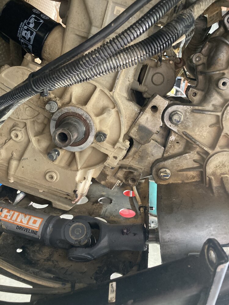

Note to self or anyone else. Hook up your prop shaft prior to bolting up transmission. If not you will have to remove it from the front diff to get it installed. :rolleyes:
All buttoned up, no noises or vibrations and ready to ride again. Hope next rides goes a little better :laughing:
After the tear down
I find this.

no, just watched a couple of U tube vids and took some pics along the way. it is actually pretty straight forward when you get it apart.

Never hammer on a RZR in reverse they are weak.

The turbo models have a gear driven reverse!
