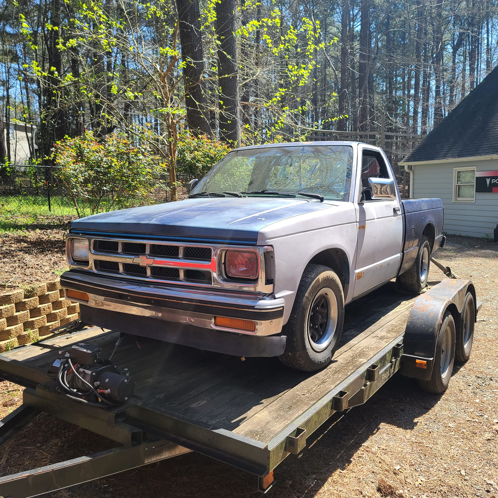

So it's not really a 4wd, but still fun. And our next $500 build IS a 4wd and something you guys will like.....
I've had a YouTube channel for a few years now and just recently started really putting some time into it. One of my good friends and I were thinking of new videos to do (see the post in the Garage about old hot rodder myths we are going to do videos on) and we came up with the idea of a $500 challenge. We buy a $500 car, try and spend under $500 fixing it up and then try and sell it and make at least a $500 profit. Our first one is an 88 S10 we picked up in the middle of the sticks in Rougemont.

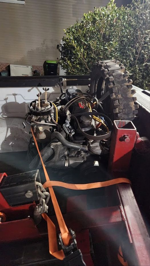

Got all the parts we need for this thing! Managed to score this mint dook from a guy off of FB super dirt cheap. He was doing an LS swap into his S10 and dumped the drivetrain cheap. Hoping it works as good as it looks like it will!

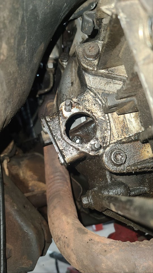

Almost done with this little turd and shit just keeps popping up. The clutch worked....for about two pushes and then nothing. Pulled slave off and we see this. WTF man. Rod pushed right through the fork. New one on the way, there's another $17 down the drain. We're right at our limit right now for our $500 so fingers crossed we don't have any more major expenses.
Now that is impressive
Might be a thing with that clutch pushrod. I’ve had a few s10 manuals and I have ran into this before.
We looked back at the video where we installed it and the hole was there when we reinstalled it, we just failed to notice it. We had to put a new slave on it anyway, so pretty much the entire clutch system is going to be new.
