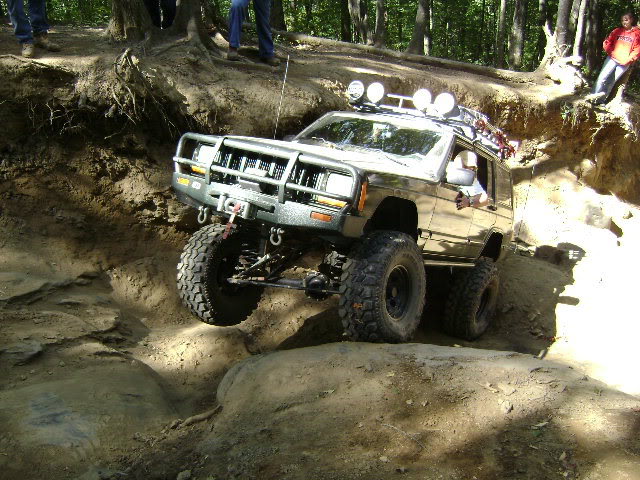

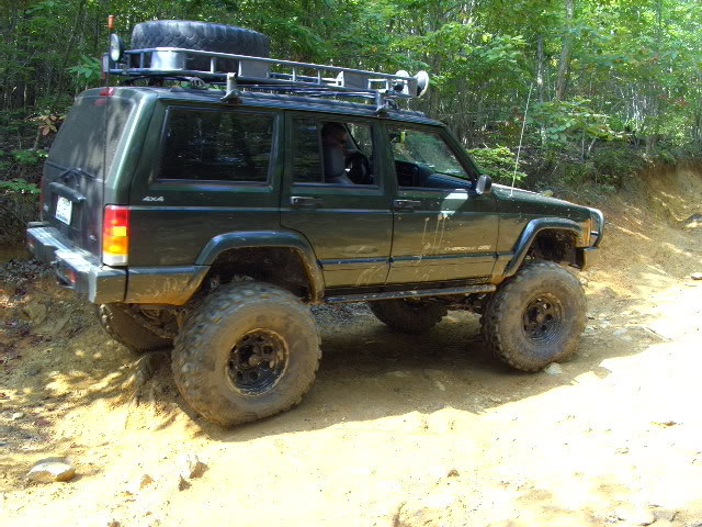

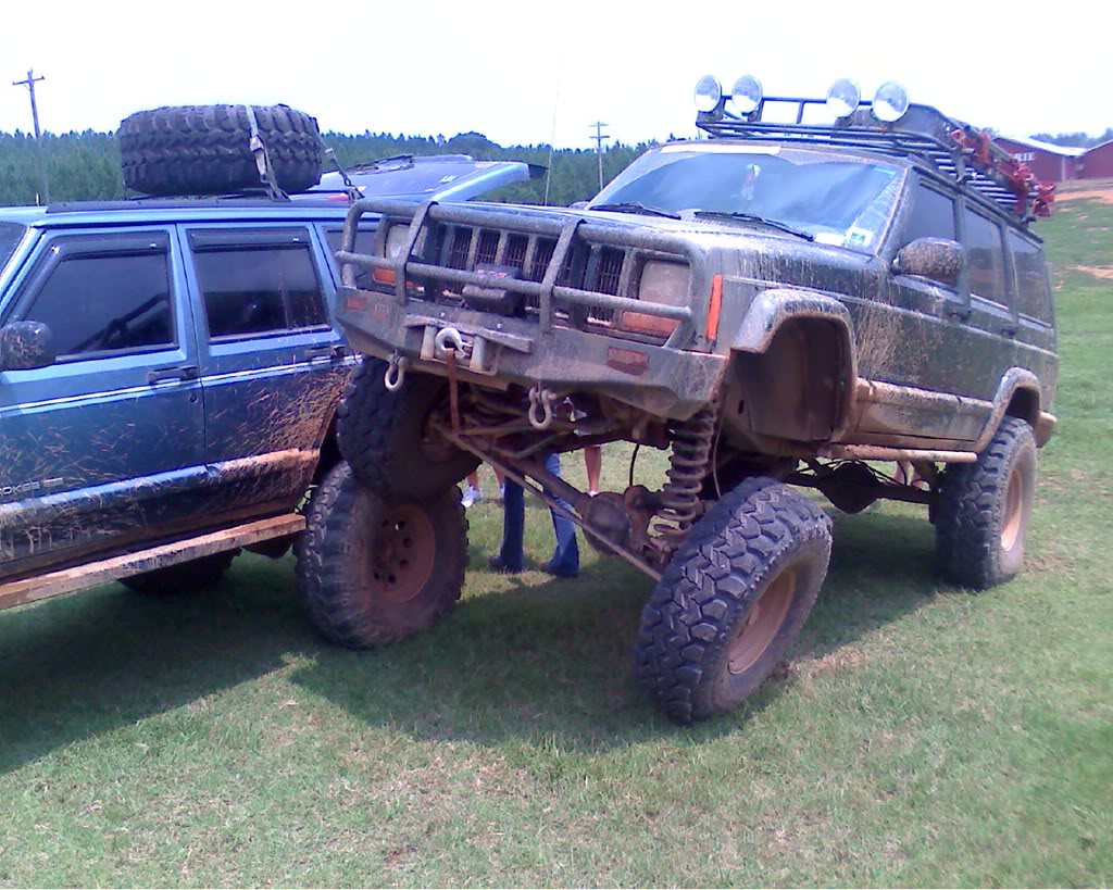

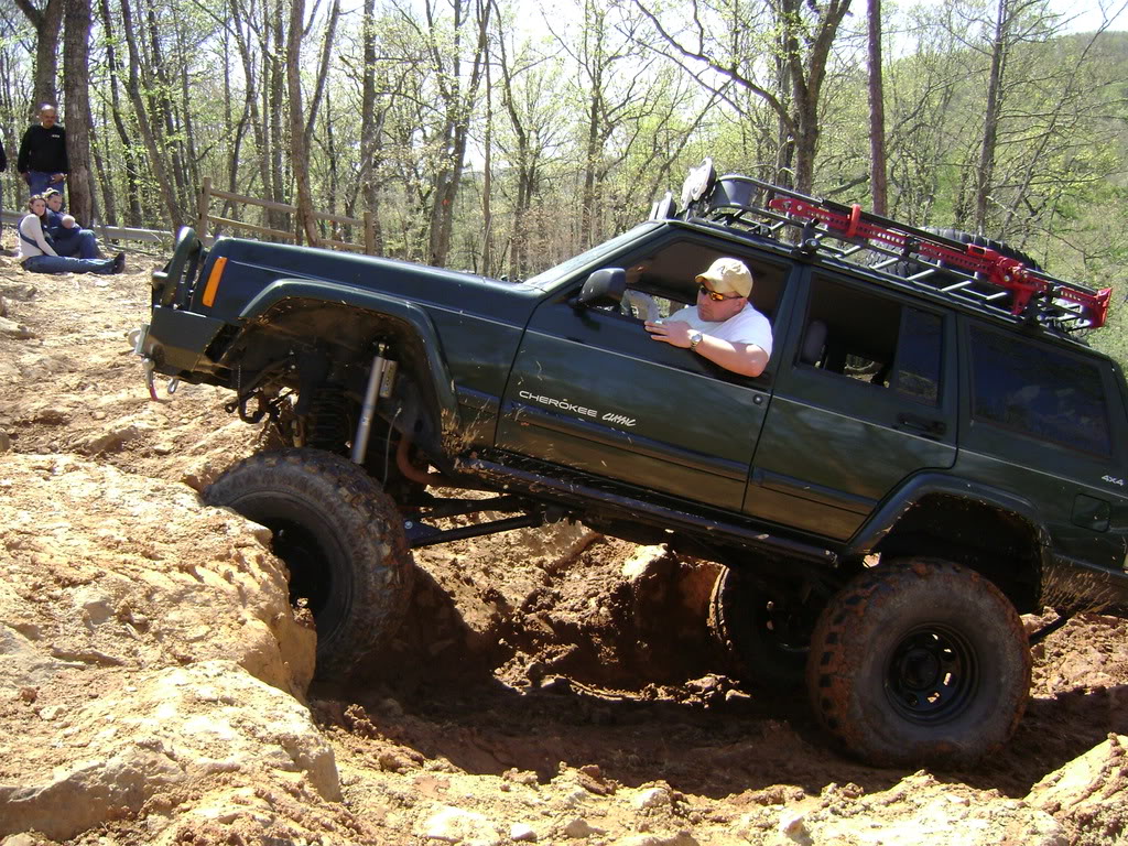

Specs as requested:
8-9" Rustys coils, 2" coil spacers, rustys long arm kit, Custom Bigg off road rear leafs, rock krawler boomerang shackles in the rear (best money spent) At that time it had Bilstin 5150's that rode great, but were too long. E locker in the rear, open in the front. D44 from a older XJ in the rear, stock D30 up front. JKS sliders, rustys steering and braces. Swamper SSR Radials 35X12.50's It was built to clear 37's and for the most part would. It dosnt have the roof rack now, I took it off to paint it and it looked much better without it.
