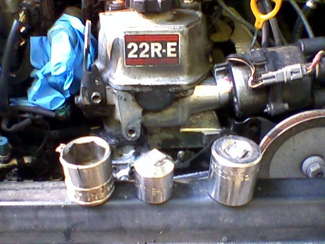

Chapter 1 and 2...............The Shadetree vs the 22R ballancer bolt
( 1 the long persuader and the 3/8" socket. 2; the 1/2-3/8" reducer )
......and the carnage .......the bolt was bathed in the blood of the Kroil and left to die, both times the shadetree was sure the bolt broke loose w the snap and the sound..........but alas it was his inferior weapons that failed him each battle and his rejoicing quickly ended.....

Chapter 3 ................ The clan of Joe brings more powerful weapons to the battle while the losses of the socket and adapter are mourned.......they were old friends who fought bravely in what would be their last fight.
Your doing it the hard way, socket on breaker bar, lay bar against frame, bump ignition , whala, your done.
There were more than several attempts w the starter, it's force was used in the first 5- 7 attacks.....first few were snug up to the frame, just a clank each time the starter was unleashed........then several blows w the breaker backed off about 8" before the starter spun and the breaker swung and struck the mighty frame w a loud blow and ring...........then 90* and more to almost 180* w a few more solid blows to the frame that all stopped the starter like a stone............and still the bolt held tight..............then the 4' "persuader" joined w the breaker and the muscle of the mighty shadetree who quickly destroyed the 3/8 socket and then the 1/2-3/8"s adapter....they will always be remembered for their hard work during many years of faithful service to the shadetrees cause. ...helpless w the loss of the all the 19mms a 1/2" socket was quickly brought to the battle by an ally from the west, it fought bravely but was killed in the fierce fight.
The shadetree then traveled far to the kingdom of the the advance auto and returned soon w a massive 1/2" impact socket.
the impact socket was strong and held the bolt tightly as the persuader wrought down a hellstorm of strength and mighty blows that almost rendered the bolt useless..... but the bolt will not be broken..........the battle will continue at dawn or after the shadetree returns from the hellish battle that is his first duty to protect his family and castle ............the fight will likely continue sometime in the afternoon............
