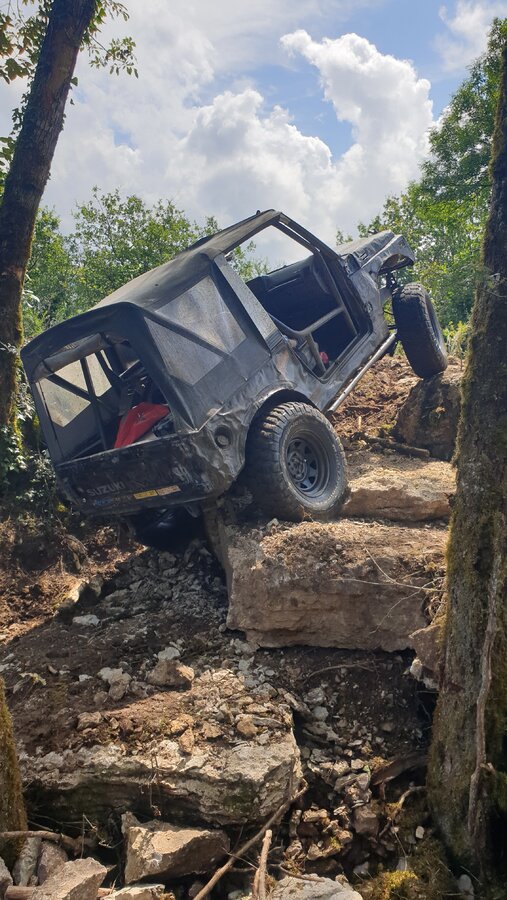

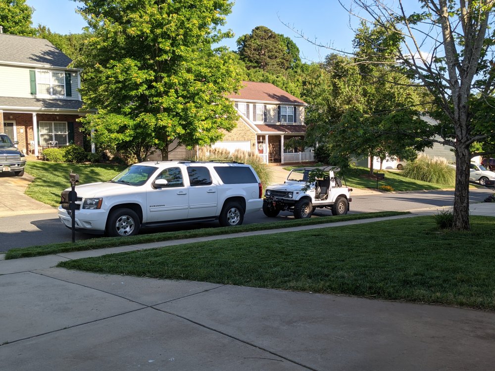

Couldn't have asked for a nicer day and a basically otherwise empty park than Sunday at the Gulches with CORE. Hooked the sami up to the burb and took my middle son Luke with me for the first wheelin trip with me, just the two of us.
He's been with the whole fam to Uwharrie in the trooper before, but we don't usually get a lot of just us time. I figured it would be a great opportunity since I would be taking it easy regardless since it's a shakedown run.
We had a great mixed group with 4-5 guys that were hitting all the crazy lines and the moderate rigs able to sit back and watch.

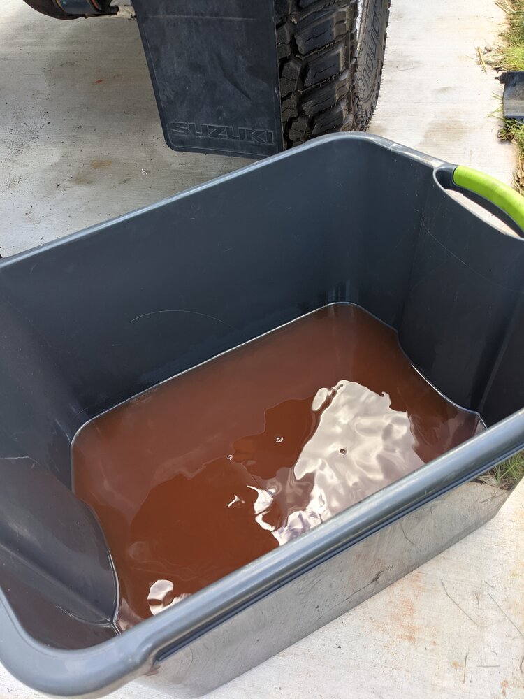

Unfortunately the fuel issues reemerged. I must have rust and gunk in the top half of the tank. Every time I fill it past half full, the sputtering hesitating BS comes back. So anytime I had to give it some beans up hill or through an obstacle, if it put a load on the engine, it would try to die. So like the first little gulch section we hit, I almost didn't make it out. Had to back out and clutch dump in low 2nd and use momentum. Needless to say, I had to avoid most obstacles, and had to pray it would make it up even fairly easy hills. It wouldn't stay running very well without staying on the gas, but I tried to keep it running to burn off the fuel so maybe it would improve. Also discovered a small coolant leak at the lower rad hose, so I have some more stuff to buy.
I can't find a good EFI tank new in stock (yet) except out of India, which I'm not interested in waiting on and potentially discovering issues. I may give low range or petroworks a call and ask about actual lead times on one of the extended range tanks that come with a skid as well. It's more than I want to spend, but if it's a viable option, I want to get this done sooner than later.

Pulled the fuel filter and it definitely had some rusty gas. Checked the plugs today and they looked ok. I got it running and started messing with some vacuum lines and when I pulled the line off the VSV and the throttle opener thingy, it would finally stay running at idle, but if reconnected to the VSV, it would die. Pulled the hose off and test drove it, but it would still sputter and hesistate under load. So I probably need to clean our the vacuum system as well. The fun never ends!
Replaced all vacuum hoses with new stuff, ran some seafoam through everything and it will run and idle better, but still experiencing issues with the pump and or trash in the tank. It will drive fine downhill, but as soon as the motor is under load, i.e., taking off from a stop, lugging it uphill at all, and it starts starving. I assume it will be a bit of a disaster in the tank when I pull it out. I've got my name on a petroworks tank as soon as they have their shipment of sending units in (in the next week or so). Hopefully I have the tank and have it installed by end of next month.

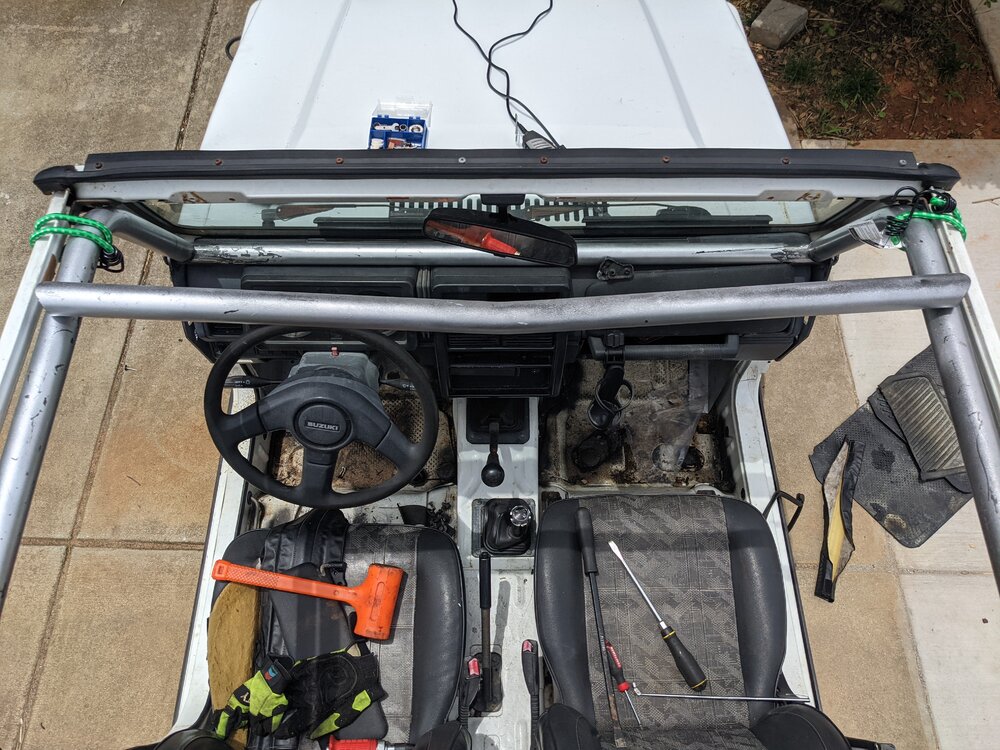

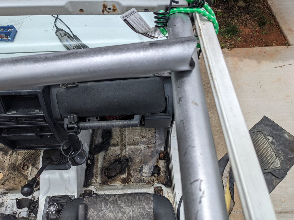

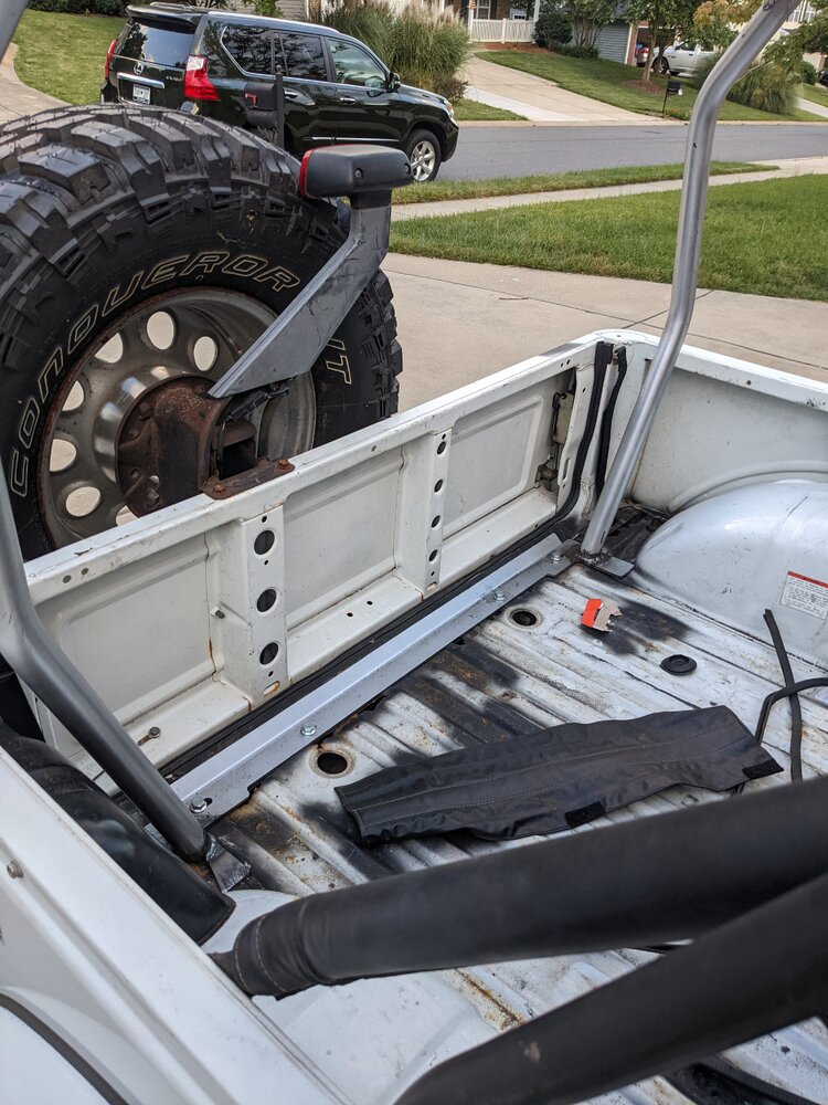

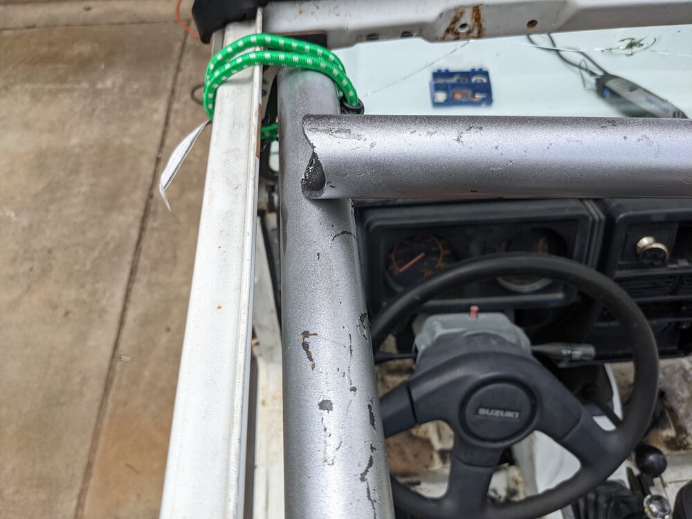

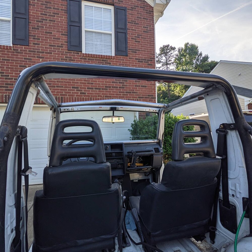

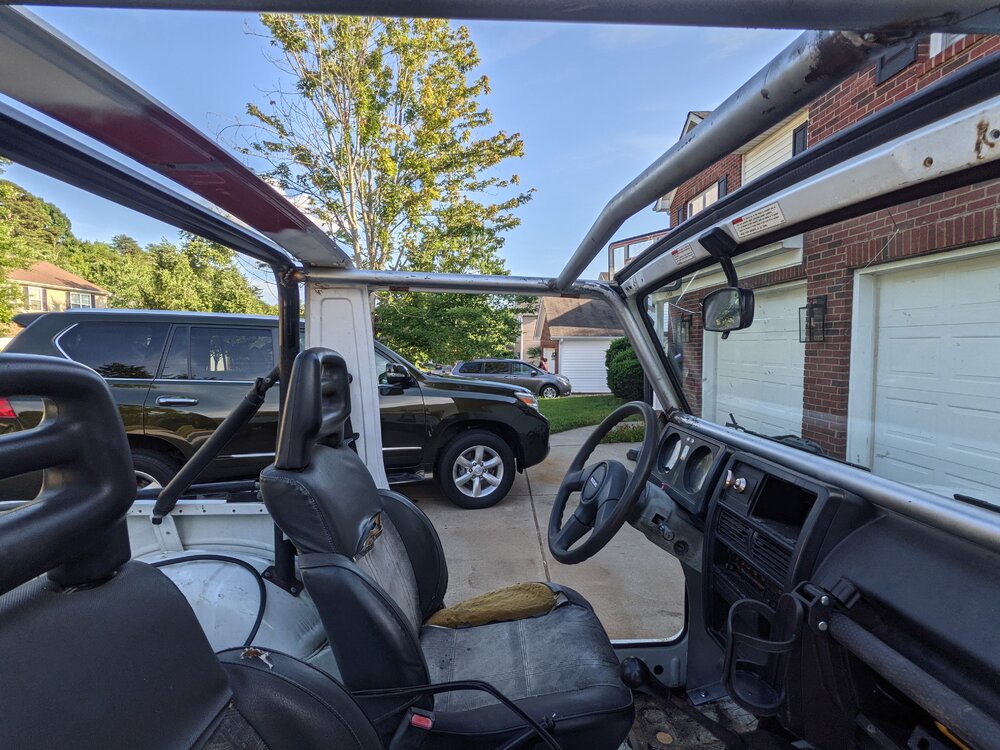

Next I pulled the LROR cage out of the boxes and started cleaning the tube and painting the front section. Once I started mocking things up, I realized I had 2 side pieces (the A pillar uprights + horizontal to the stock bar) and neither of the A pillar to B pillar braces. I bought it from Jeg's almost a year ago, so nobody can do anything about it. Oh well - I didn't really like the braces design anyway, so I will try and make it more betterer.

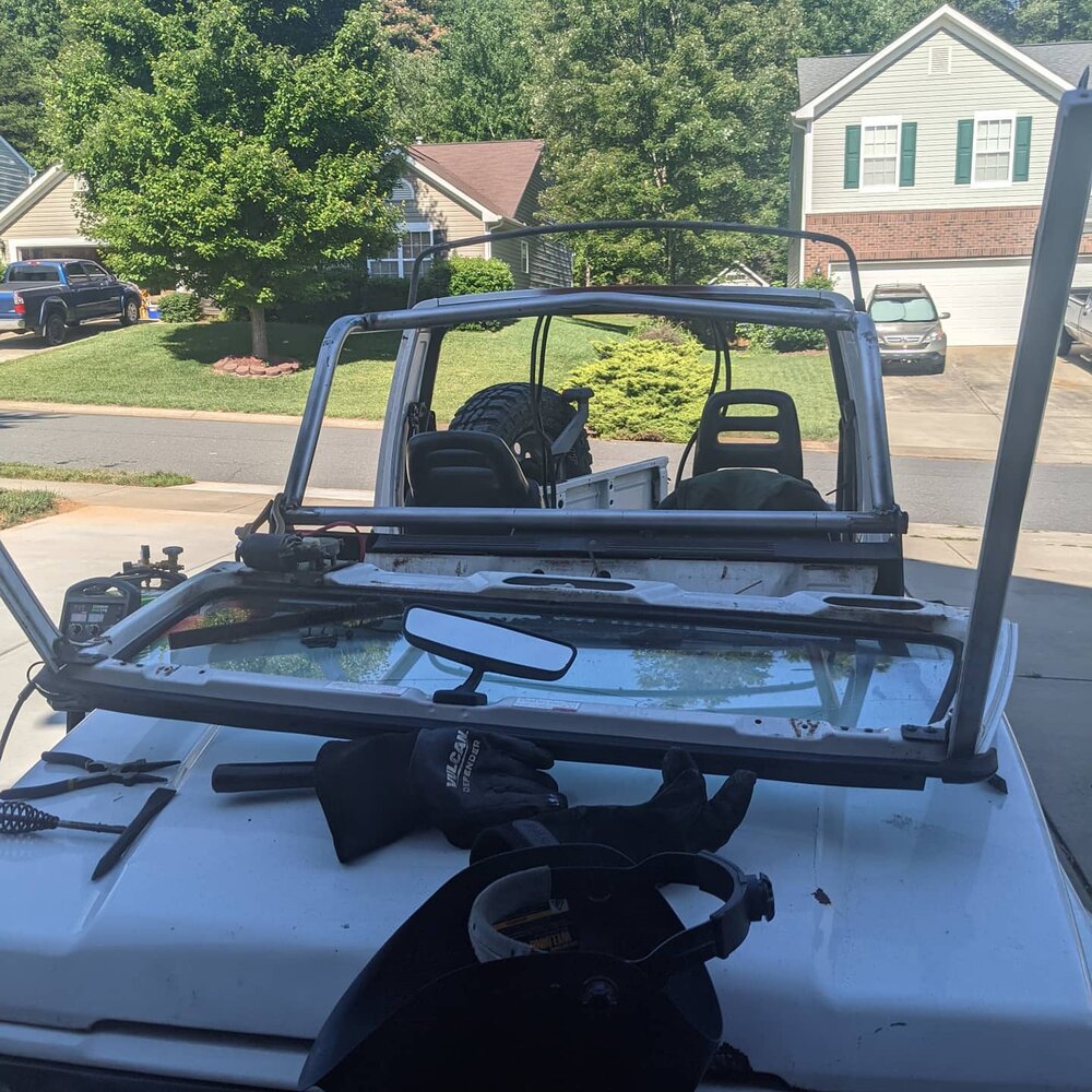

The top spreader was at least an inch too wide. Like no way in hell this would fit. So I had to bust out the portaband table and make adjustments:
Dropped the windshield to get at the dash bar welds more better.
So I'll next do the rear section, and then get some triangulating braces in, cut the handles for size and buzz those in, and then touch all the paint back up. Going with a metallic silver with custom runs and heavy/light spots.
Anyway, this was a bigass pain and I am sore in new and exciting places after contorting to get to all the welds, but it's my first cage project, so I'm diggin' it.

Got the back half of the cage done. It's straight enough if you aren't looking at it straight on. Good enough for government work.
I'm gonna rig in some triangulation this weekend.

Tank showed up. I got the old one out without catching my neighborhood on fire, thankfully. Pretty cool that the EFI sami tank doesn't have a drain plug. So I had to dump the top half out of the fill while it was still in the rig. It came out mostly clear. This was what was in it after I got the tank completely out and dumped it:

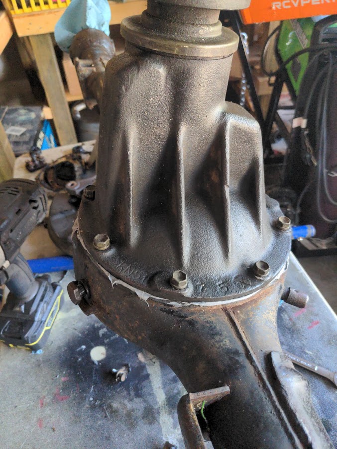

In the meantime I got my spare axle torn down and the spartan locked 3rd installed. RCVs are next, followed by a freshening of seals, bearings, and whatnot from the knuckle balls out.

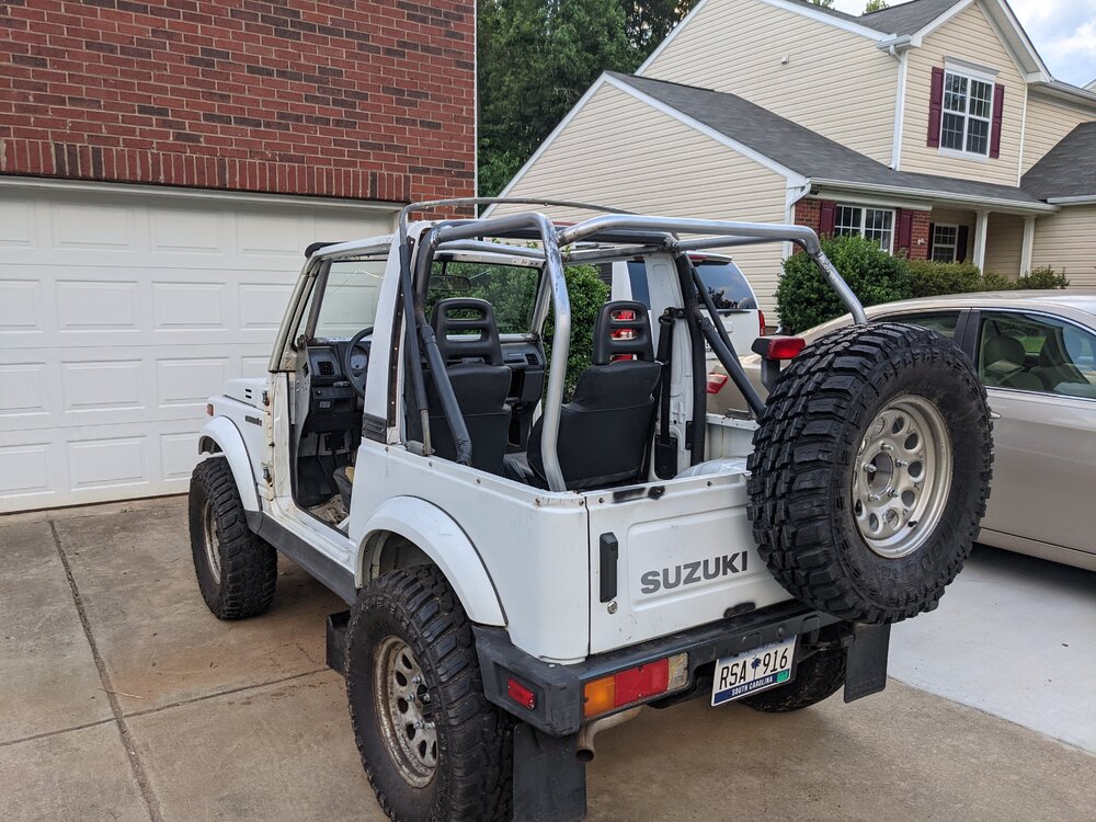

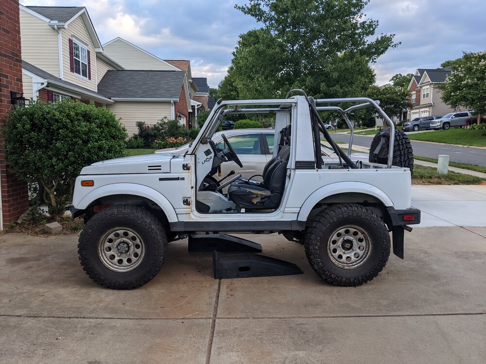

Got a couple triangles booger'd in added to the cage. Was going to add a harness bar but I will wait until I have the seats I'm going to end up using so I don't end up having to move anything. I got everything painted but didn't remember to take photos, probably because the heat had my brain near about boiled.
You can see the new tank in the pic below as well
Put the top back on and the rear panel is toight against the cage about a 1/3 of the way down. Hopefully it will stretch to fit to make zipping that panel easier.

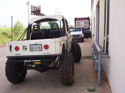

I know, big sidetrack but the current owner of my old samurai sent me a pic of it from last weekend.
Pimpin! Any sidetracks are A-OK in here. Otherwise it will be mediocre progress pics every few weeks type boring.

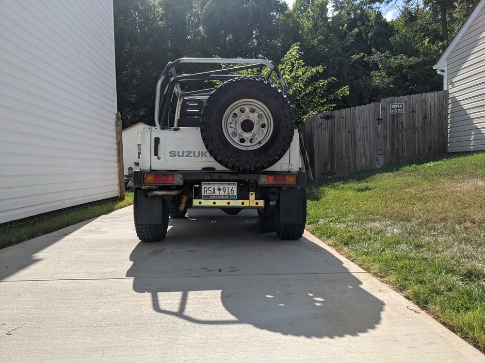

I gotta figure out rear bumper and rocker stuff, may just put some angle on the body, may get fancy with some poop pipe. Also I was eyeballin' a LED strip for the rear brake lights and blinkers and whatnot whenever I pull the stock bumper off.
Look at mine. No bumper. Never missed it.
Mine was never driven on the road so it had no lights, but I really like the old school round trailer lights in the trail gate look:
lights-2-jpg.157886
I can dig it. I think I'm going to try keeping the spare on the tailgate for now. So what I'm hunting for is a cheapo race style 5 or 6 section light bar (red/amber/white/amber/red or some such) and see if I can slip that between the tailgate and whatever I end up with as a bumper.
