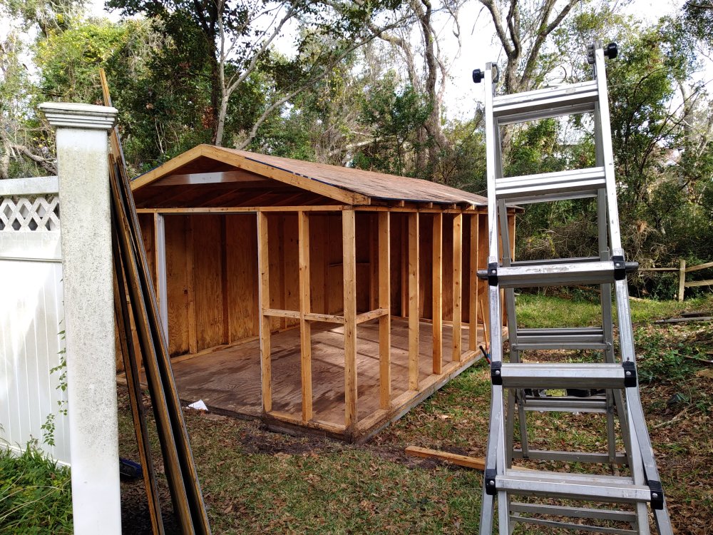

Turned out the guy was having a swimming pool put in the back yard of a vacation rental house he had and needed the shed gone by the following week. I told him it would be gone by the end of the weekend. The next morning my father-in-law gave me a hand and we went to the place and started taking it apart. I stripped the roof to find a few areas where the OSB was damaged from leaks. No big deal.

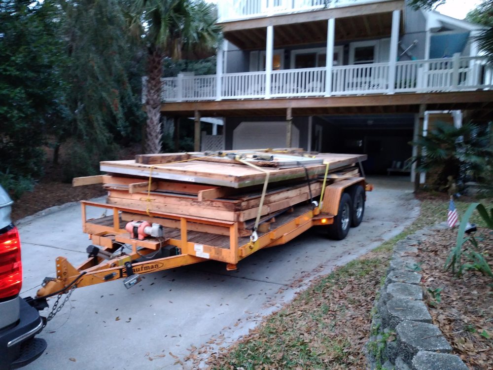

There was some T1-11 siding tattered all along the bottom and some minor rot at the very front where erosion had pushed a bunch of soil up against the base but overall it was very dry and clean. We stripped the T1-11 with a sawzall and generally used a couple demolition type blades to sever the nails. Once the frame was exposed we sliced the roof in half, dropped it over the sides, then sliced those into halves, effectively cutting the roof into four pieces. The walls came apart as units, then the floor was sectioned into four pieces following seam lines. It was stacked on my trailer to haul home; we spent about 6-1/2 hours taking it apart.

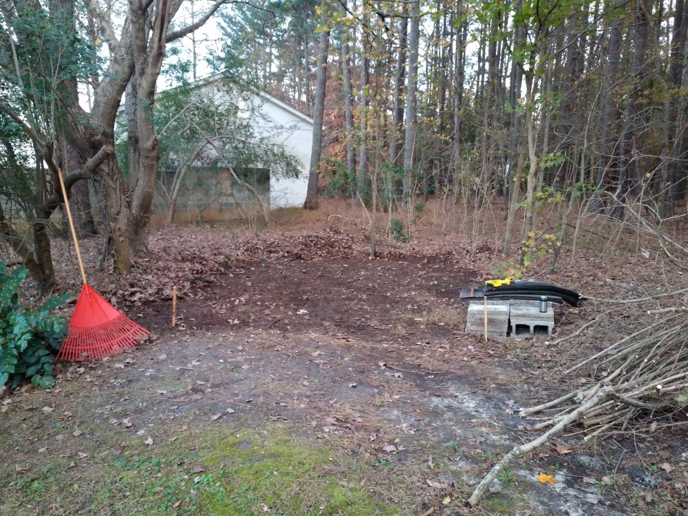

It sat on the trailer covered with tarps until early March while I wrapped up the house addition I posted in another thread. I did select the site off the side of the backyard and clear some small trees and brush.

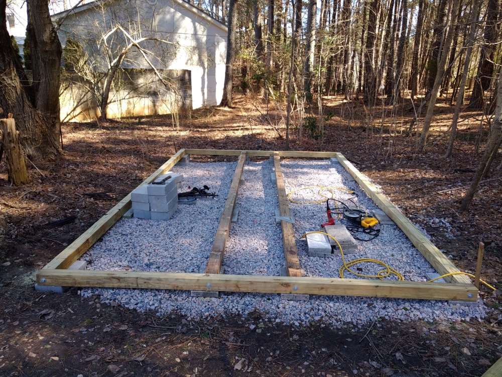

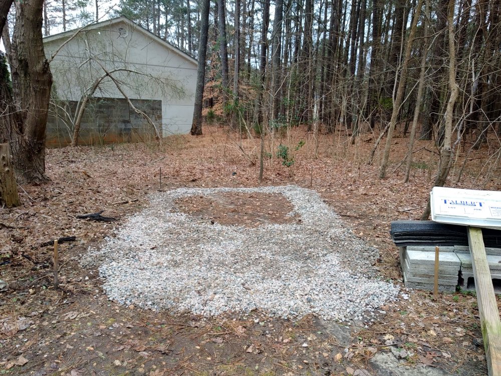

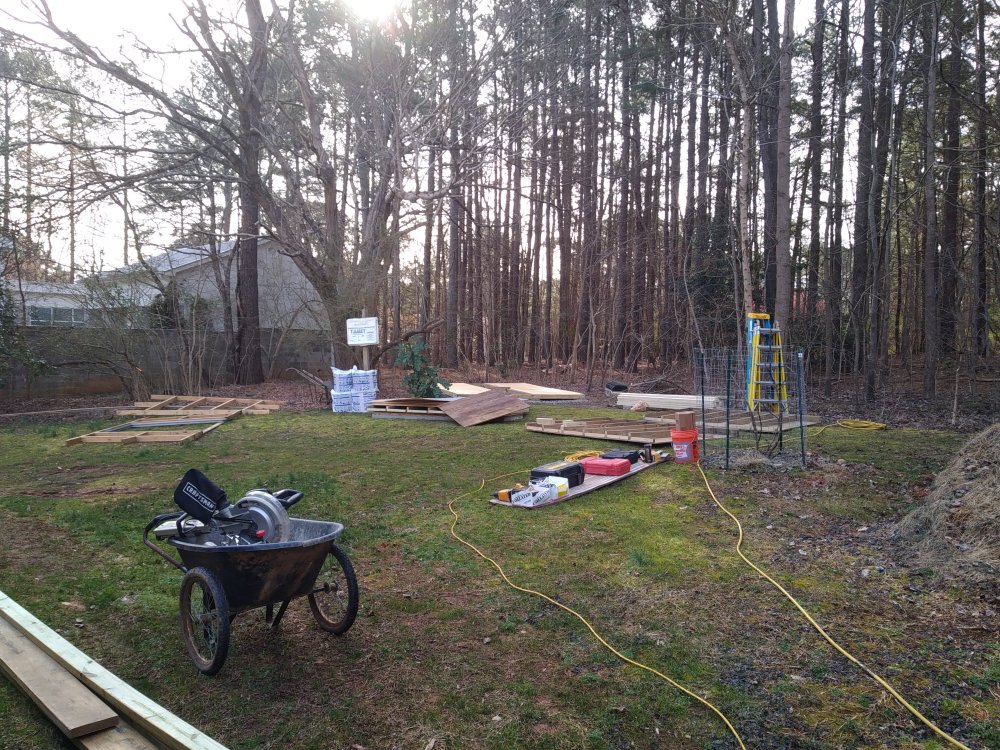

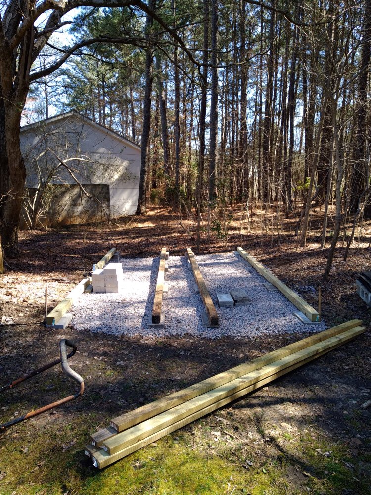

With the addition basically done I turned to this project. I dropped about 3 yards of #57 washed stone over the area and setup solid concrete blocks where I was going to lay a new sub-frame to support the old shed floor.
Since I literally sawed all the cross-members I needed to rebuild support under where those seams were going to be. Good thing was the shedactually had two 16' 4x4s under it that were on blocks on the original site and were dry and solid so I only had a purchase a couple more. For the ends I used some doubled-up 2x4x10s I had left over from another project; I lag bolted all the ends together. The pictures are a little deceiving, there is about 8" drop on one corner, all the blocks were leveled with a laser.
Frame put together.

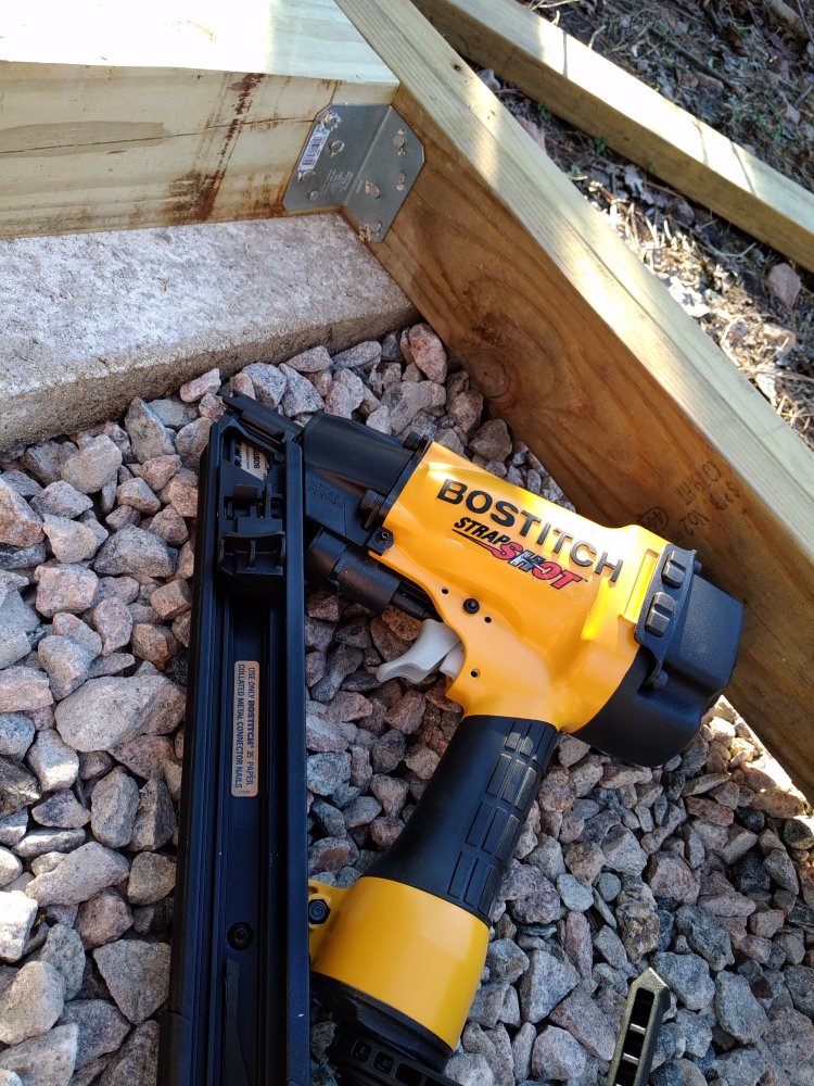

I did use my new framing connnector nailer to add metal supports to prevent board twisting at the ends. This is an amazing tool (not sold at the big box stores) and over the course of construction it nailed over 1000 nails into the shed.

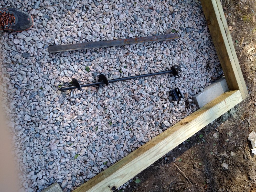

The county said I also needed to have tie downs in the corners so 30" mobile-home tie-downs and straps were installed.

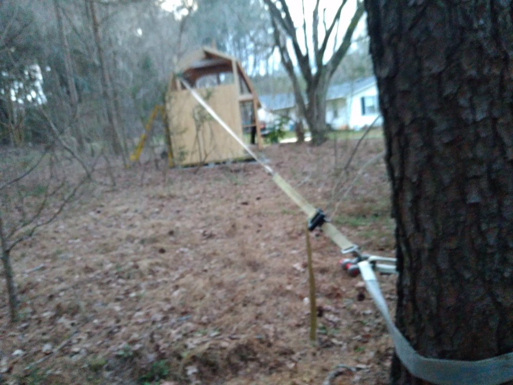

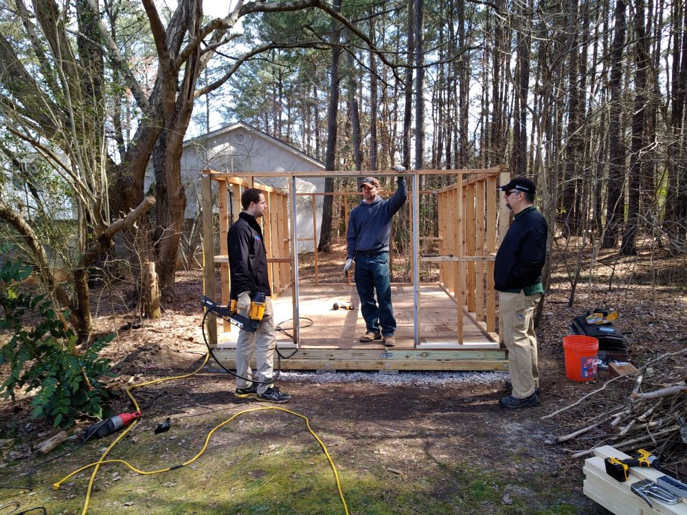

On a Saturday in early March a handful of friends (including Bryan and Wayne) came over and helped me with the barn-raising. I tried to stage everything and have donuts at the ready...
Folks helped with nailing down the sub-frame sheathing, stuffing the floor with R-13, re-aligning the floor sections upside-down and mending them with plates, flipping everything over and seaming it together. Then the wall sections were squared and re-nailed to the floor frame. By lunch it looked like this.

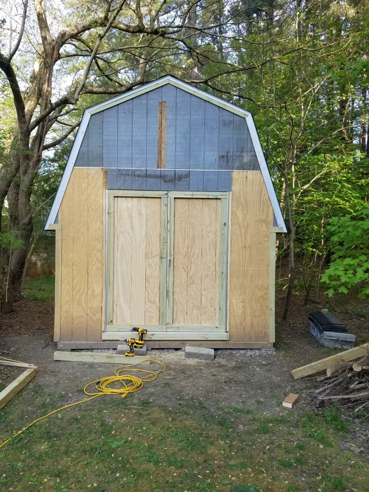

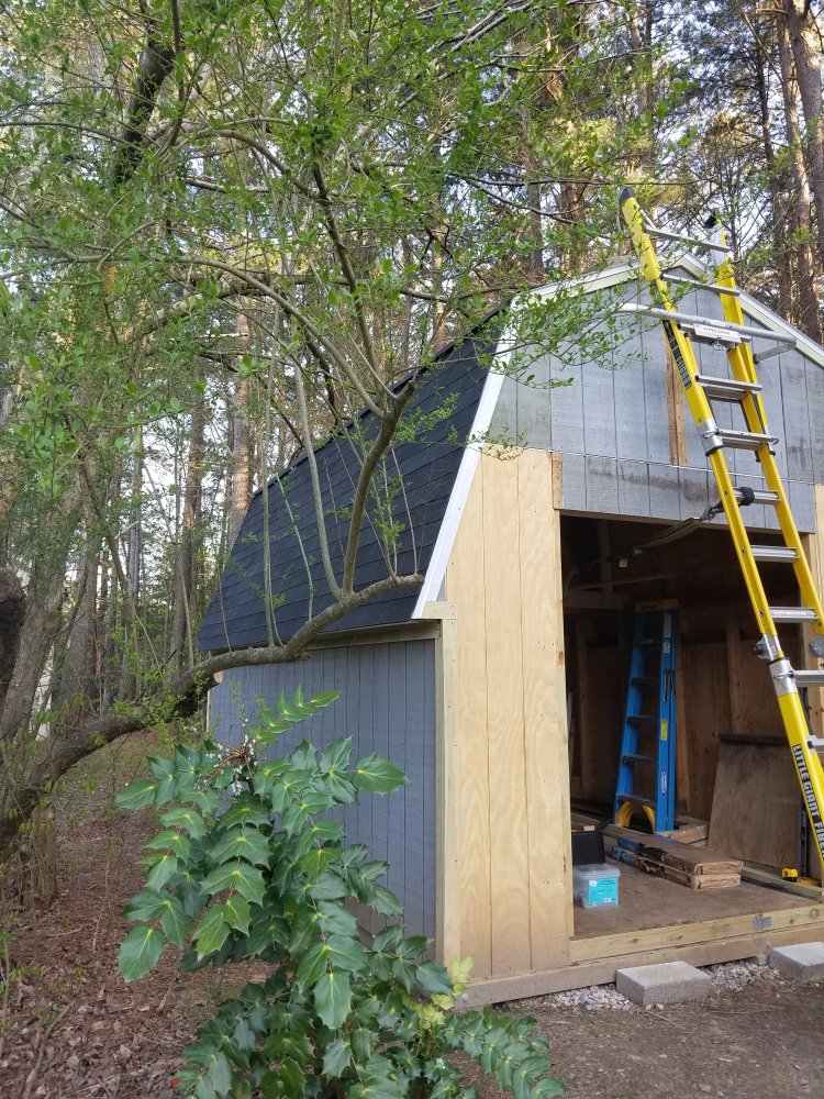

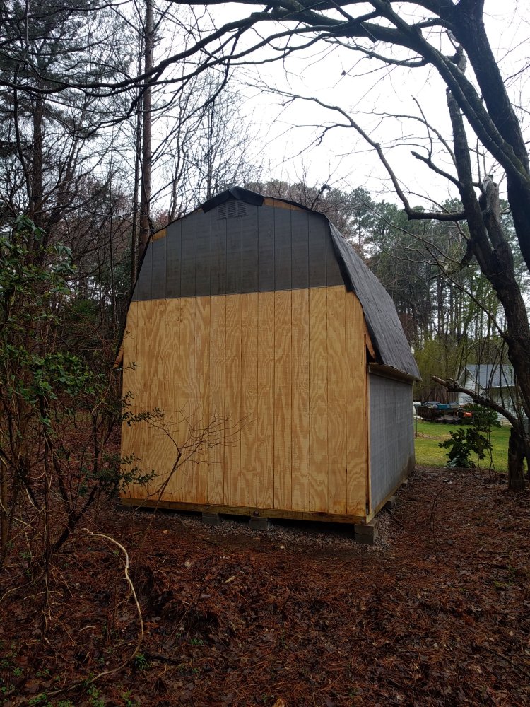

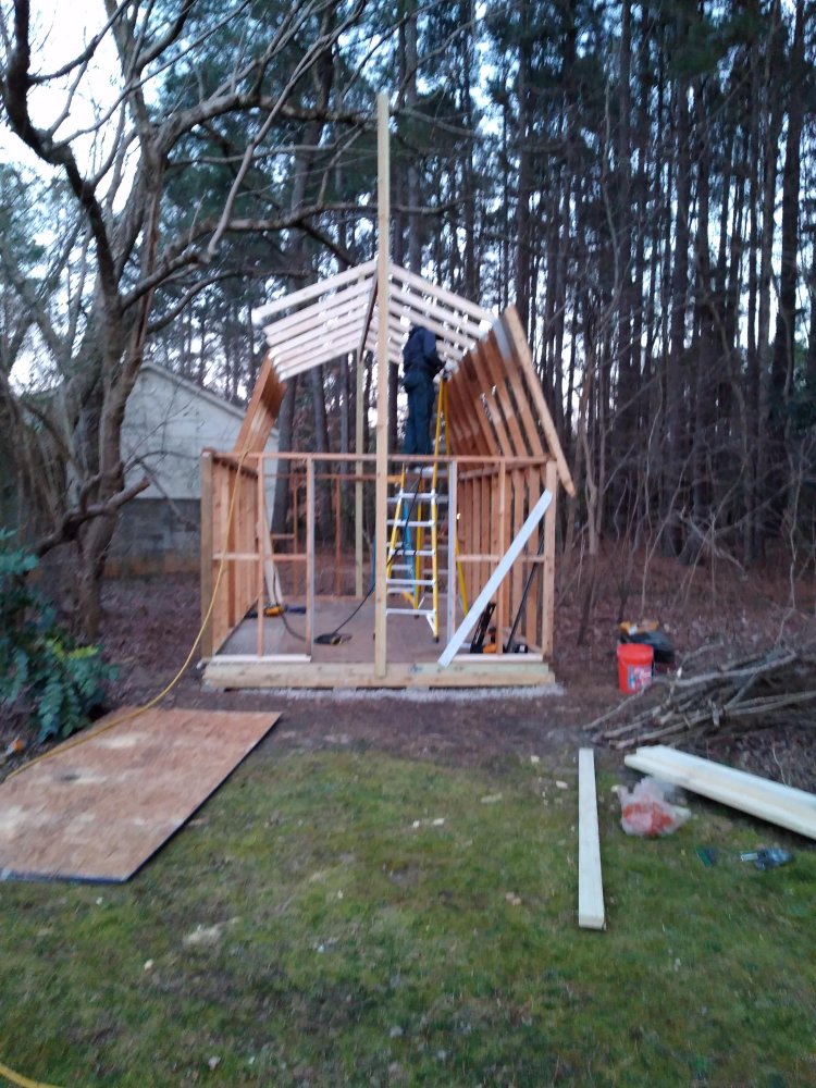

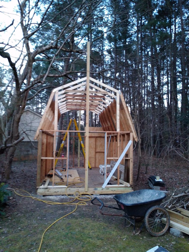

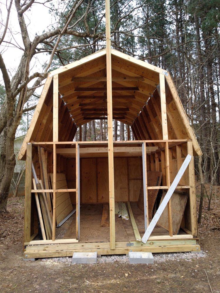

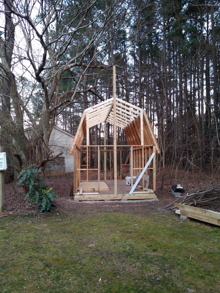

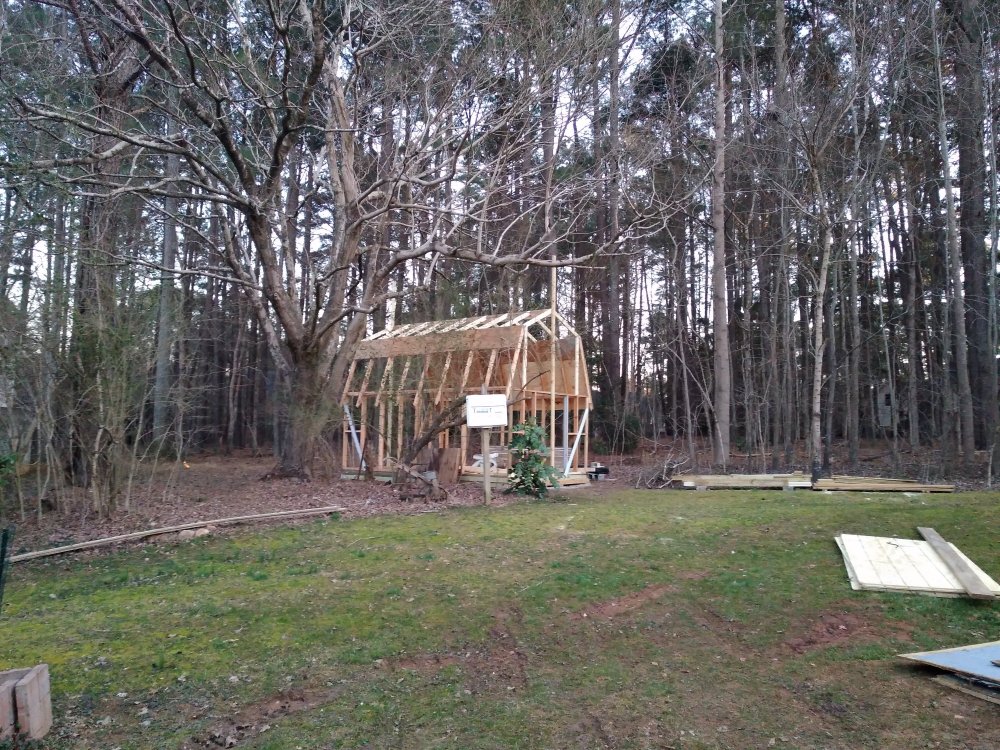

Bryan stuck around until after dark; I think because he was really keen on getting the roof frame put together. This took a bit of extra time as I planned to change the roof line from a gable to a high gambrel to gain loft space over half of the floor. We had to temporarily nail a new ridge beam after ridge connectors were installed and do some figuring and cleaning up of the original roof panels to make it work. We nailed in hurricane ties on both wall plates to make placement easy and then used mending plates at the joints of the rafters to tie it all together. We stripped off the damaged OSB sheating before putting the pieces up.
This is where it ended up by the end of the day (picture taken the following morning).
