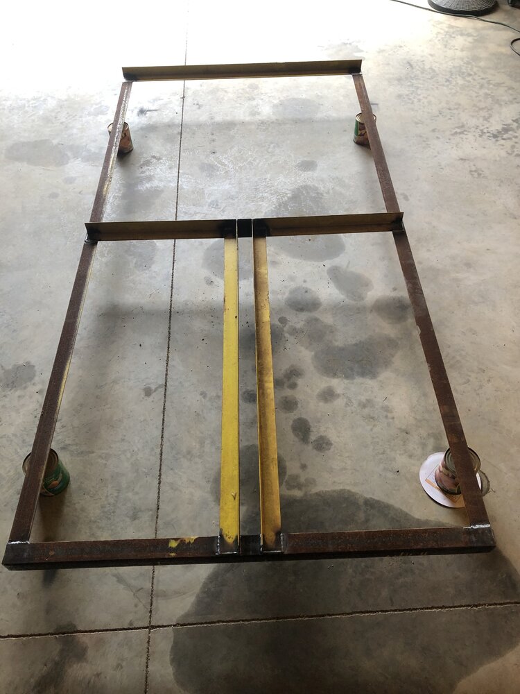

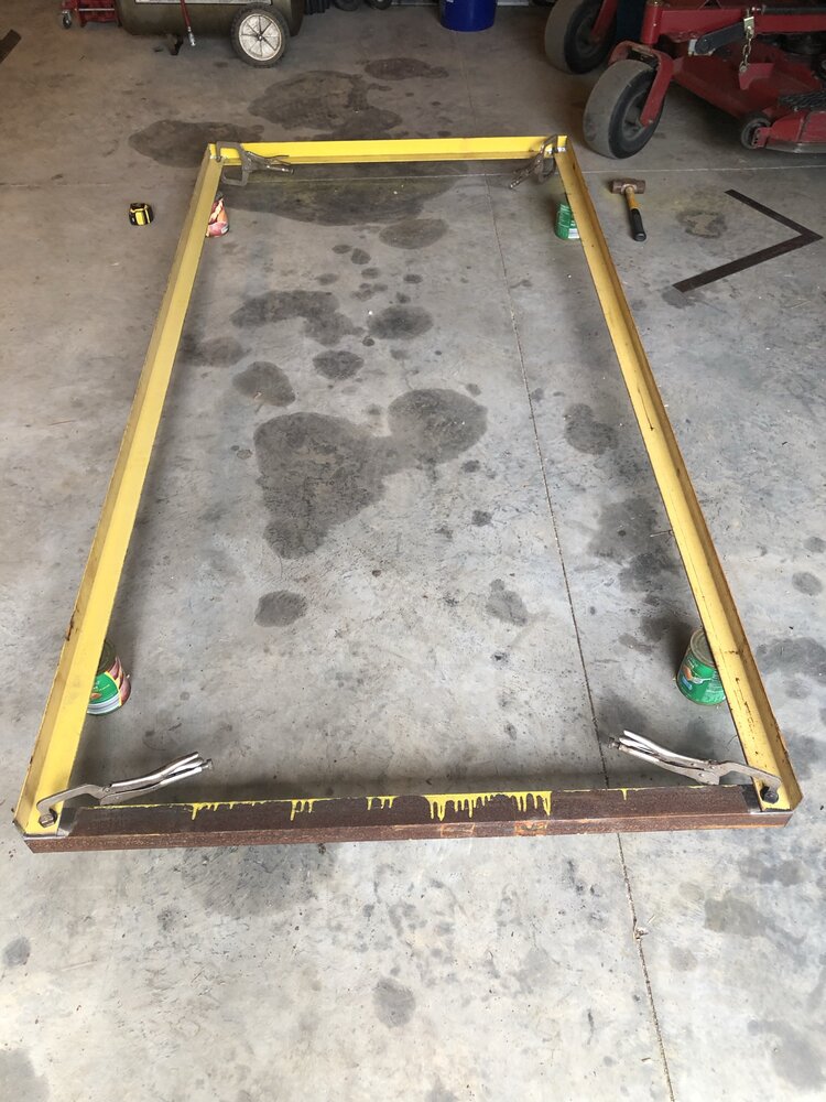

I decided on a simple tilt 4x8 like I’ve had in the past. It’ll be like most utility trailers with an upper and lower rail and expanded steel floor.

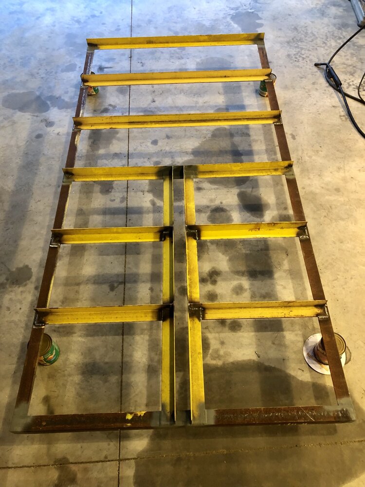

This is where I’m at after a day of working on it. I am so damn sore today and it’s raining so hard I decided to take a sabbatical but will get back on it soon. I’ll have Lucky sand blast it and get it painted up after it’s done.
I need better stands than my cans of yams…. I have jack stands but different heights LOL. Guess I’ll buy some blocks from Lowe’s 😄
The short rails were notched where they meet the center where the tongue will go so they’re the same height/level as the other rails.

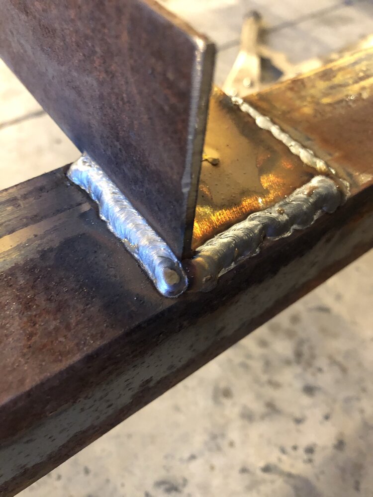

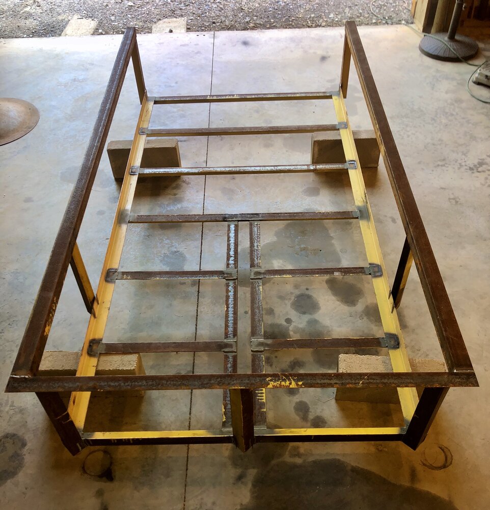

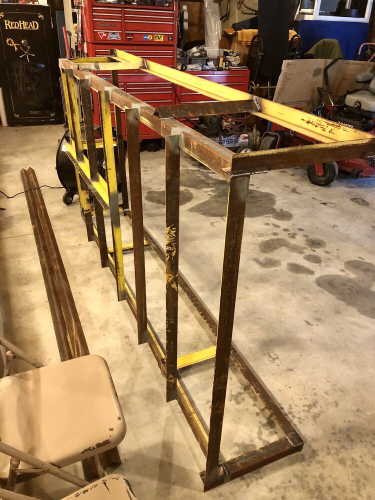

I made a little progress today. A few more uprights and then flip it over again to weld some things from the bottom. After this I’ll work on the tailgate assembly.
I made the sides 16” so one sheet of expanded steel will do all the sides and the tailgate.
Added 2 more uprights aprox 24” from the rear like those toward the front. I’m leaving the middle empty for now til I mock up an axle and fenders. All welding for what I’ve done is complete from top and bottom.

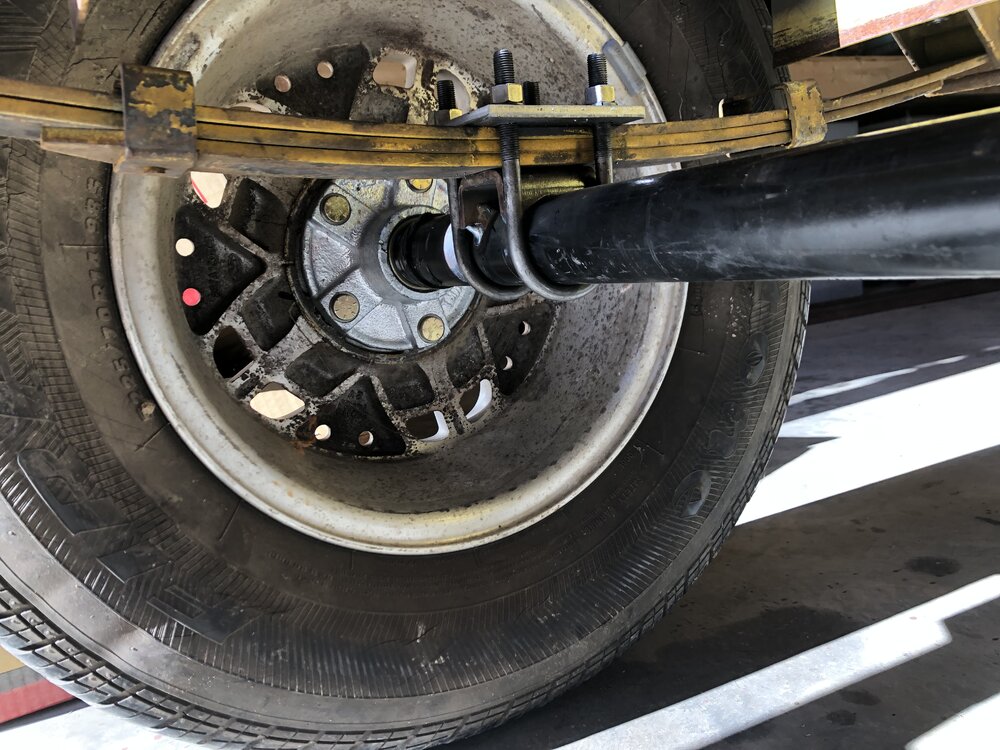

After measurements and trial fitting, the torsion axle isn’t ideal. It is a HEAVY beeotch, at least a 3500lb rated axle and the deal killer is it needs 16” wheels due to how the arm/link comes off the axle to the spindle.

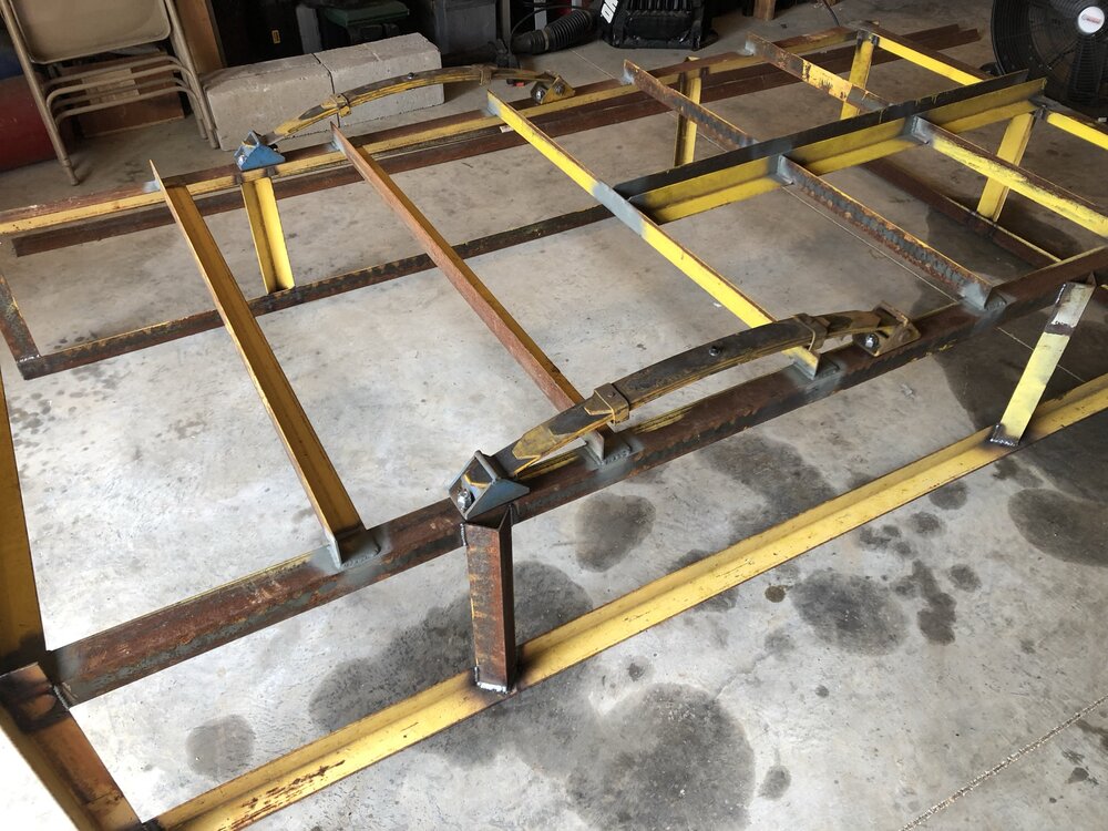

Don had also brought me some leaf springs and hangers/sliders but they were 7 leaf packs of 2” springs. I removed the centering pin and got it down to 3 leaves and got it all mocked up on the frame. Holes are drilled and I just need eight 1/2”x1” bolts/nuts to bolt the springs on. Everything is squared to the centering pins.
So an axle and some plates and U bolts needed. Probably get em at Agri-Supply next trip.

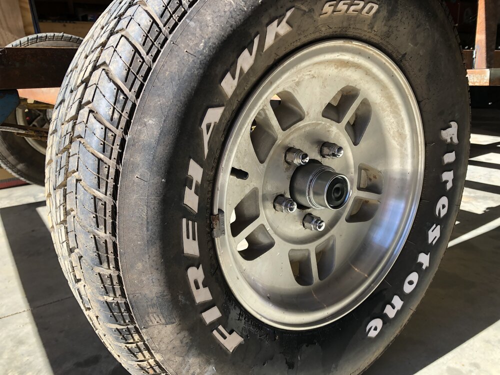

Well I picked up the wheels and tires from @doc today and holy moly the tires are new tread if a little old. Will be great on this light trailer. I found a place called Out Of The Box Parts and bought a 62” (hub face to hub face) non-cambered axle with non welded spring seats (so you can place them where you want) and galvanized hub/bearing kits plus the U-bolts/plates for under $200 with free shipping. Says it’ll all be here Friday 🤠

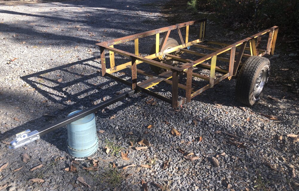

Trailer is turning out great!
Thanks brother 🙂

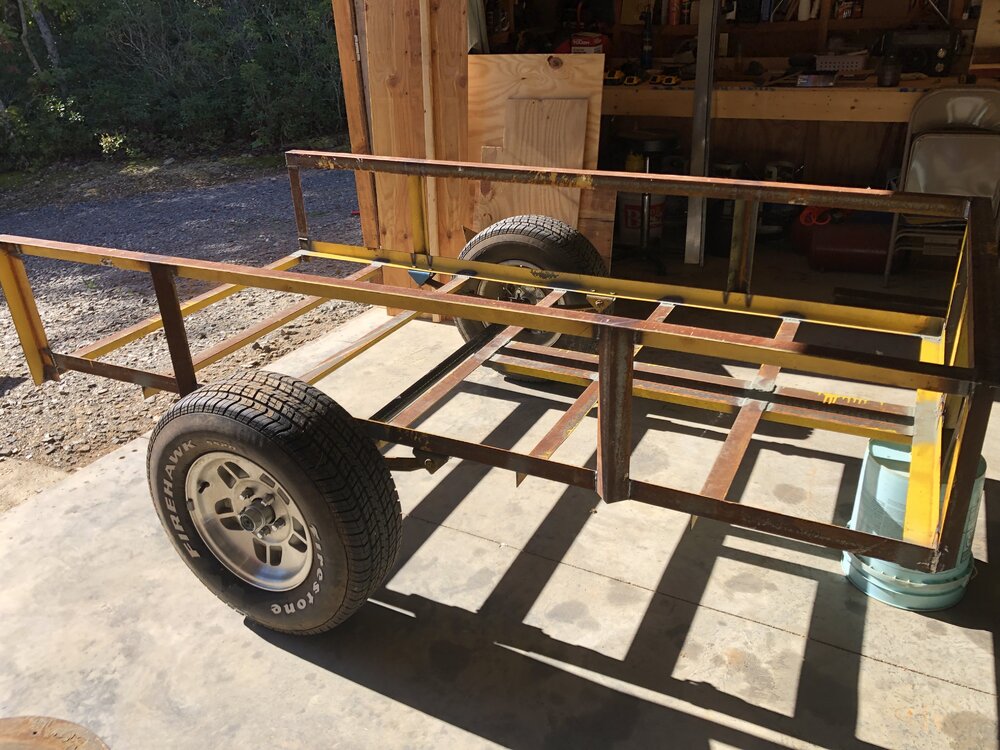

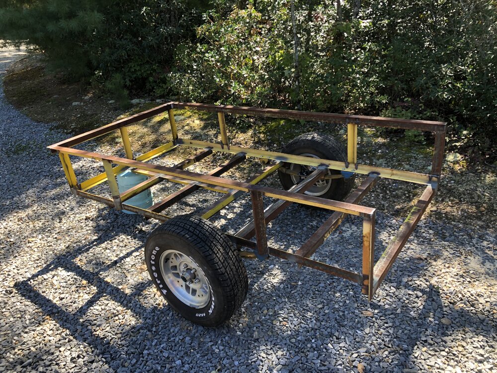

I need the tongue, tailgate and now that the wheels are on I can finish the uprights and figure out the fenders.
I plan to make a pickup type tailgate that will lock in the flat position so when I tilt it something can roll right up on it. It will be 90% for garbage duty though.

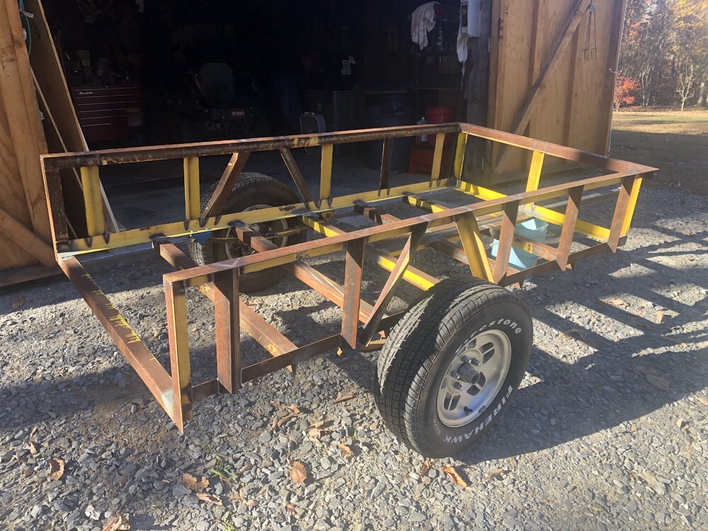

Forgot to post any updates. Added the rest of the uprights and the tongue. The angled uprights over the tires will be where the fenders go. Tongue is 54” to tip of coupler so it’ll back well. Doubled the amount of uprights so the spacing at each end looks odd but it all should be really stiff and strong.
Sides and floor as soon as I can get over this pancreatitis.
