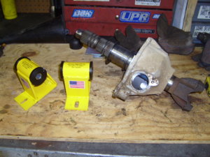

1" motor mounts from Brown Dog Offroad

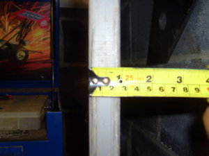

Big chunk of plastic cutting board for the flat belly

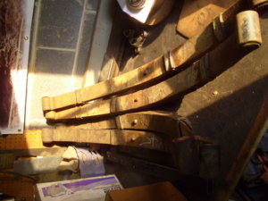

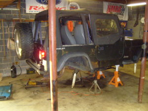

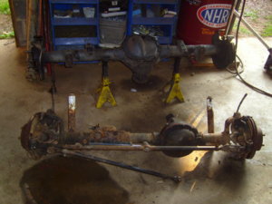

Everything is here and the YJ is stripped down awaiting re-assembly. Here's some pics...

I built a separate tranny/ transfer case crossmember with tabs and bushings from Brad at www.Barnes4wd.com. I then cut a big ol' chunk of 3/4" HDPE and used that as my belly skid. I have a flat skid aside from the thickness of the HDPE.

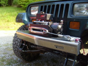

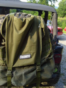

A little horse trading with Greg Slade at 4WP Raleigh got me a new Smittybilt winch and Smittybilt bikini top. A winch is only as good as it's mount, so once again a slow talking dude named Brad Barnes delivered one of his awesome aluminum stubby YJ winch bumpers. Out back a used Smittybilt swing out tire carrier/ bumper combo holds my spare tire and my Trasharoo.

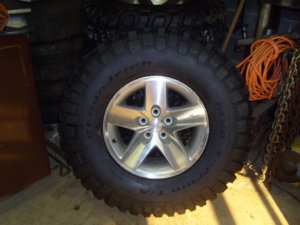

Finally a call to BFG got me a set of 305 KM2's wrapped around a set of used TJ Rubi wheels. UJOR braided front brake lines help the tires come to a stop.
