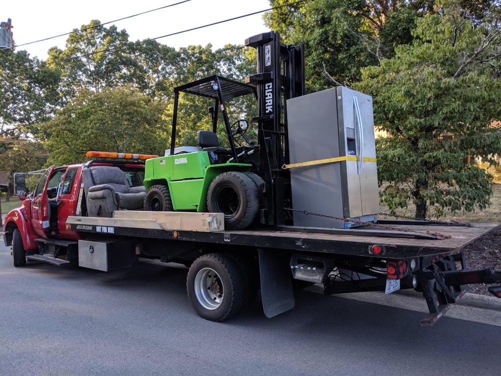

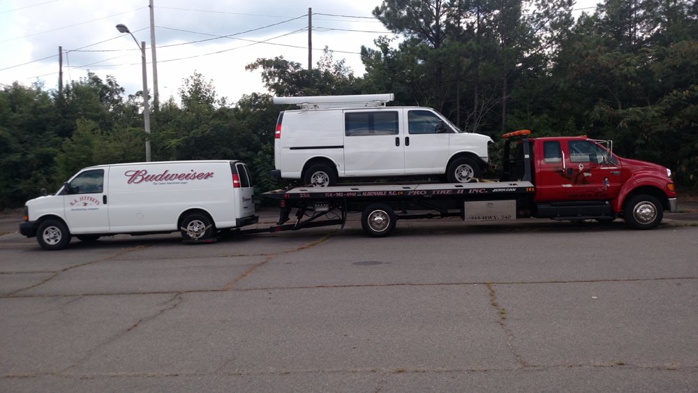

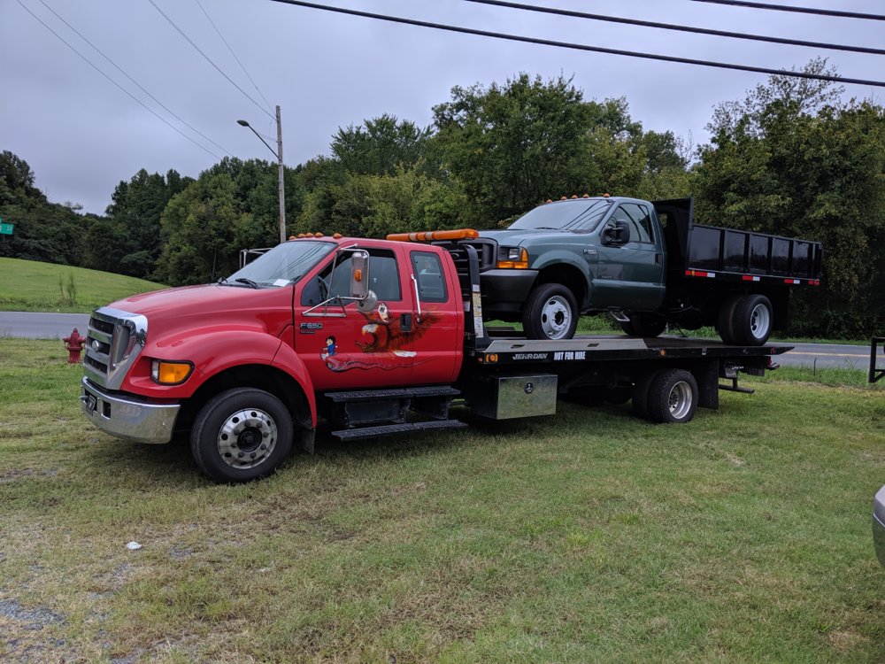

Right, which is why I showed the pictures of mine. I used to move trucks around on a 20'+5' dove deckover equipment trailer. Let me tell you, pulling a wrecked F550 dump truck up on that trailer with an electric winch SUCKED. And I doubt I could even get my forklift on my old trailer (didn't have the forklift at that time though). I also move some wrecked cars around, and the rollback is better than any trailer at doing that imo. But yeah, they're more expensive to purchase and maintain in most cases. Fwiw, a tilt trailer heavy enough for my uses would be $12k+ new. Add the cost of the diesel 1 ton truck needed to pull it and that's more than I paid for my rollback.
Not trying to argue that a trailer isn't better for your situation, from what I can tell a trailer is a much better fit for you. For most people that just need to move one car around at a time a rollback is unnecessary. Just giving a different perspective.

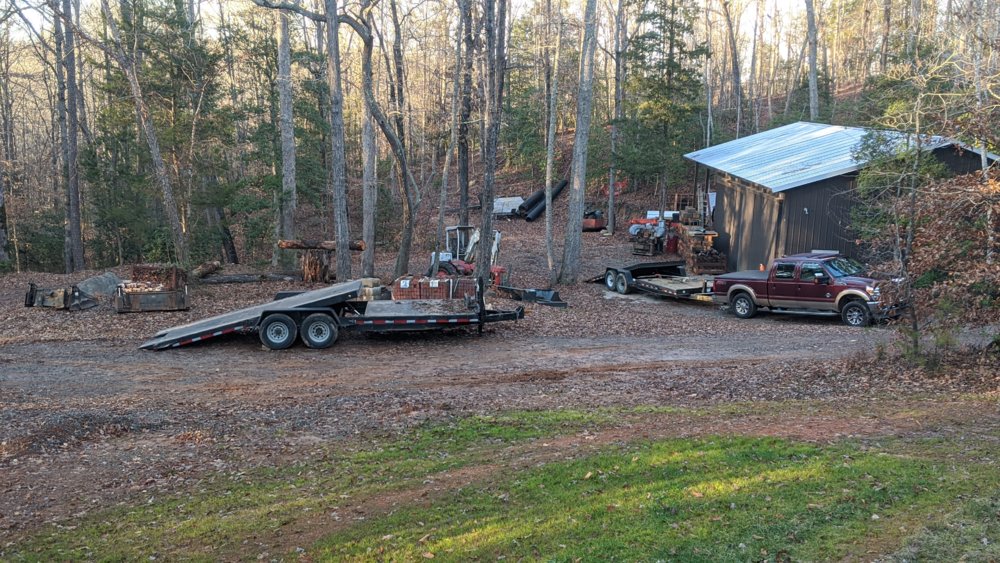

In your video you say that you pull the trailer almost everyday but you also say in this thread that a rollback would sit in the yard too many days to pay for itself. That doesn't add up. I have an 18ft steel deck tilt trailer myself. There are times it is used once or twice a week and other times it will sit for a month or two. I completely understand not wanting to keep up another running vehicle.
Why not fix the problems with trailer? Weld up the floor seams, move the spare, strengthen the tail piece, and install a double acting cylinder and power unit. My trailer was also a manual tilt when I bought it. I added a battery, hydraulic power unit, and winch among other things to suit me. I have loaded many rolling non-running vehicles in a matter of minutes. Of course, I have had vehicles that required two snatch blocks just get them on the trailer.
A wireless remote for the winch has been very useful especially when loading by myself.
