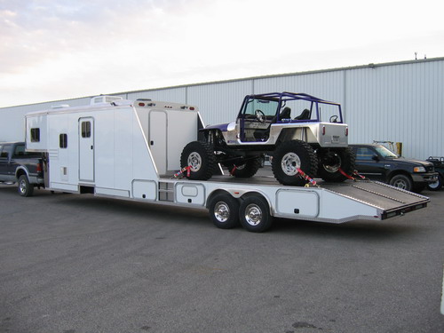

here ya go
Yep Brandon thats pretty much what I'm planning. Little longer than I'd like but thats the idea.
