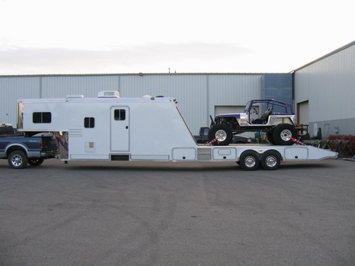

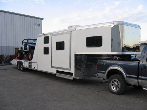

If all you're going to be hauling is a 4400 car, get a regular enclosed. More useable space and easier to sell when the time comes. So long as one end is narrower than 81-82", you can fit between the wheel tubs in a 30-40ft enclosed. If you go for 44ft or longer (which that one looks to be), the rig will be behind the wheel tubs and should go 94-96" wide pretty easily. You can go over the tubs too, depending on headroom.
The nice thing about the one in the photos is the nose is tapered, so you should be able to tow it with a shortbed truck. But ... I'm betting the rear tires on that Ford are seriously overloaded.
I'd pimp the shit outta that! Might be a little more than I want to spend though lol. can't even imagine the tongue weight on that thing!

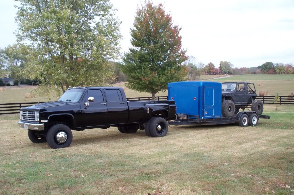

Heres a pic of a sleeper on a car trailer. Would look slicker on a goose.
Sent via telegraph
Thats a cool setup. I could handle something like that. Even better would be a double sleeper. I was going to say earlier that it would have to be a sleeper with a flat roof for sure. The ones with the wing or sky lights built in are backwards for what I need.
