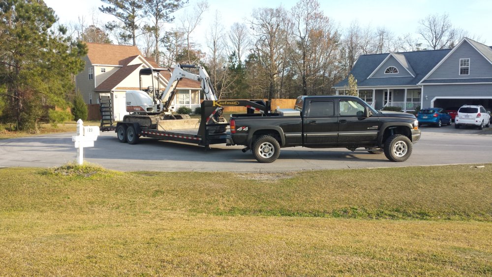

Hell, I run them on my tow rig. No loctite, just torqued like they should be. I forgot they're there most of the time... I DO check them every time I rotate the tires or have the back tires off for any reason. I've never had them loosen up even a little.
