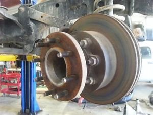

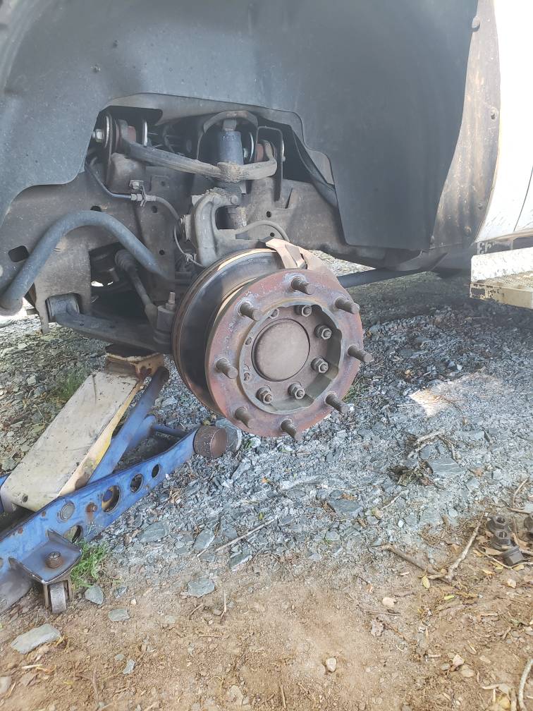

Just asking for discussion. Don’t all dually trucks have a spacer in the front?
Big spacer, had to run 3 inch spacers on the rear to match the track width
