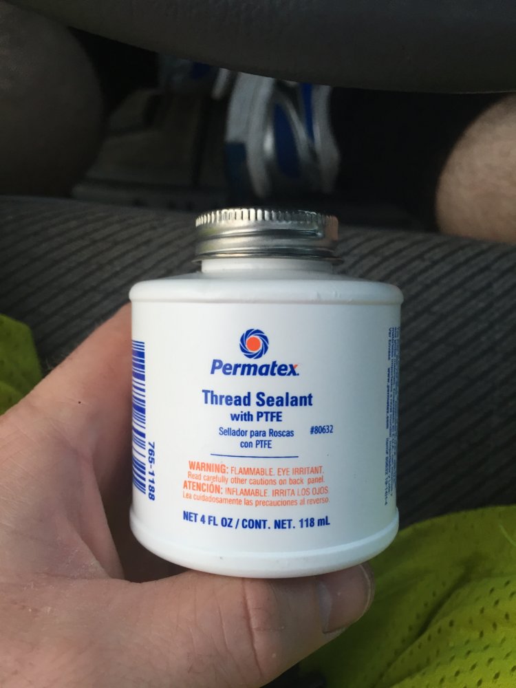

I have a number pretty incredible leaks at my orbital. At the orbital going to the reservoir and coming from the pump. I'm hoping I can reseal everything without getting new hoses. I didn't build this steering set up so I don't know what was used previously, but will this Permatex Thread sealant with ptfe do the trick. I saw lock tite makes some stuff that's like 40 bucks. I've read up on the Teflon tape as well. I'm conflicted and don't want to piss hydraulic fluid all over the shop this weekend. Any tips or suggestions welcome.

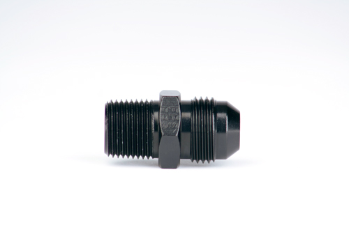

Make sure you havent used NPT fitting in it. Like this...

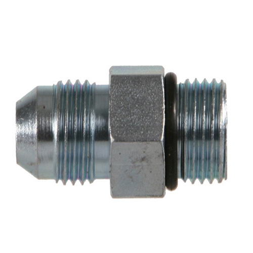

It should look like this...

Replace that o'ring and it wont leak anymore!
Ya I had to replace my o rings I just grabbed some out of my harbor freight kit been working for the last year just fine
