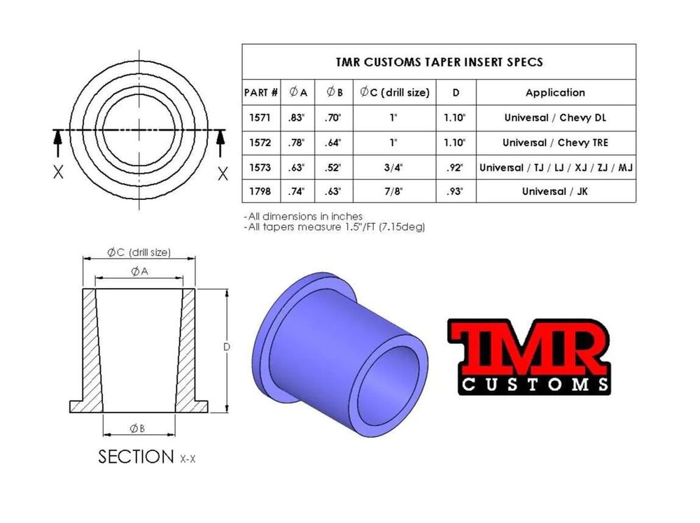

I bought a tapered insert from Summit or Jegs, can’t remember. I used it for a track bar application cause it had been drilled for a 3/4 hiem and I needed it to be stock again.
I don’t remember the exact size, but there were options.

Its much better to have a tapered fitting for on street use, then drilling a 3/4" hole.

This from above?
"In excellent option when using a larger GM 1 ton taper (.75" large end of taper, .68" small end) without buying an expensive tapered reamer. All you need is a 7/8" drill bit, drill your knuckles to 7/8" bore and drop these in. Can be used for either over the knuckle or under the knuckle steering. You will need 1 insert per tie rod end to complete your steering installation."

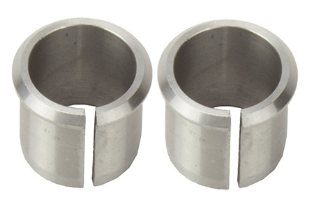

Just drill it out bigger and drive in a sleeve and tack it in if you're worried about it coming loose.
I think I would drill a 3/4" hole in the knuckle, then use a 1" drill bit to drill a very small taper on the top. Insert a 3/4" OD x 9/16" ID spacer in the hole and tack weld it in place.

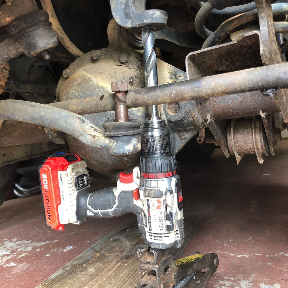

Was that on a tan tj? Drilling that out nearly broke my wrists.lol
Trying to do the opposite of that.
Trying to put a 9/16" bolt where a 1/7 taper used to be. The hole is a fair bit bigger than 9/16", though
No, the current TJ that I own (soon to sell)
I used my drill and a jack lol.
