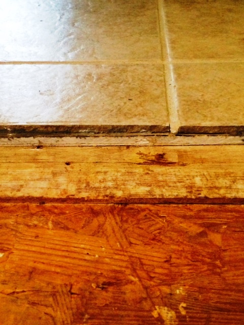

I'm redoing the old floors in my house and currently removing the old flooring which consist of some engineered HW, carpet, and tile.
I have a questions about the easiest, most proficient way to remove the tile. It's tile/grout on top of backer bored, the backer bored is on top of some cheap vinyl flooring, the vinyl flooring is on top of 1/4in underlayment, then the sub flooring.
I want to remove everything down to the subflooring. Would I do that in sections meaning start under the backer bored and once that stuff is removed, then remove the vinyl and 1/4in underlayment? Or would I just go in all the way and pry up from the 1/4 underlayment?
Another question is what us the best tool(s) for that? I have a good 15in pry bar. Would I need to get something with more leverage like a Pro Pry Bar, 46in? Is there a good tool to rent? I don't want to mess up the subflooring.
Here is a pic of what I'm removing.
Did they put the backer board down with mortar? That'd make a big difference in the way I'd go about it.
I'm gonna guess NO, but I'm not 100% on that.

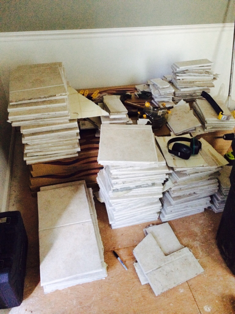

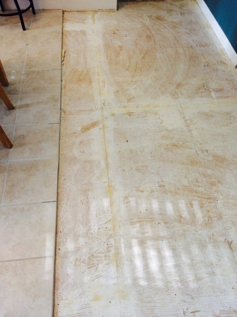

Thought I'd update and share my experience so far.
I bought the kobalt 4in saw with vacuum attachment and have been cutting the grout lines. At first I was doing every tile and now I'm doing every two tiles... So far so good!
The tile, backer board and vinyl come right up leaving the screws in the sub flooring.
To get the screws out I just use my screw gun and back them out.
Thanks for the help and the suggestions.
You are lucky. In a little over 8 years of doing tile, I have only pulled up 1 floor that easy. The clown used roofing nails and I was pulling up 3x5 sheets of the floor. Tile was still stuck to the underlayment. Every other floor that I had to pull up was broken in little tiny pieces.
