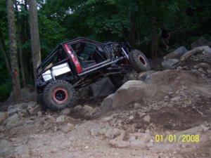

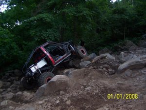

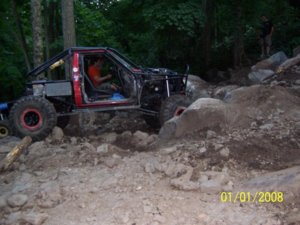

Uppers are 34", lowers are 36" and there is 7" at the frame and 9" at the axle. There is insignificant flex steer, works like a dream.

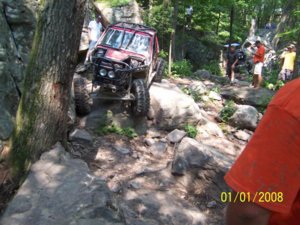

Just got back from Harlan and all I can say is I am very pleased with how it preformed.
Made it through lion's den, lower damnation,and mason jar just to name a few. I'll have pics later.

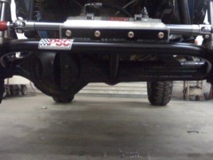

Well after a few years of running the "home made" X-over steering I finally reached the limit of the stock arms and they started to crack at the stud holes, so I decided to get myself an early Christmas gift. I calld up Brandon at RIDES and had him get me a full PSC hydro kit. I got it all put on and took a few pics of the install.....

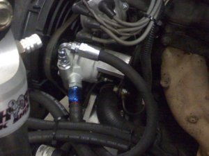

Pump...
attachment.php

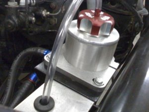

Tank...
attachment.php

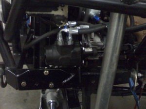

Steering valve and mount....
attachment.php

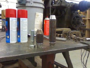

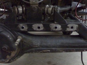

I tried to make most of the stuff bolt on so I drilled and sleeved the front truss so I could bolt on the ram mount......
attachment.php

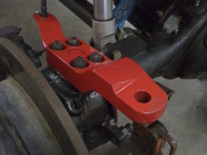

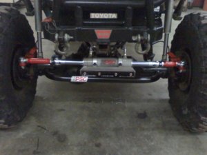

Once I got that all worked out and plumed I put on the new high steer arms from Marlin Crawler and made the tie rods...
I added some brake line mounts to the arms as well as cut down the pass. side arm
attachment.php
Turtle head:flipoff2:.....
attachment.php
The ram ended up being offset to the driver side a little so the tie rods are different lengths...
attachment.php

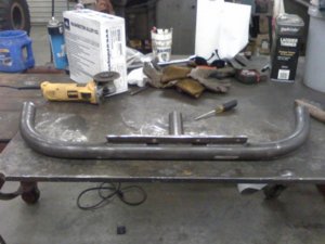

Went over to MUDPRO metal works and bent out a ram guard made out of 1.75" .1875 wall DOM and welded a flange to bolt the front face of the ram mount.....
attachment.php
Got that all welded up and put on.....
attachment.php

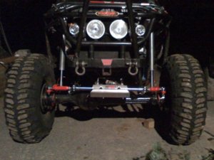

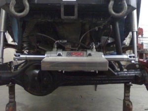

And the finished product.....
attachment.php
Let me just say that the comparison between the two systems is nonexistent. The new kit preforms flawless and I couldn't be happier.
