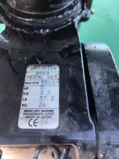

A picture of the plate at the front mounting point of the motor would be helpful. You can then google running issues for that model of motor and someone out there will have already been through this.
It should be similar to this picture
