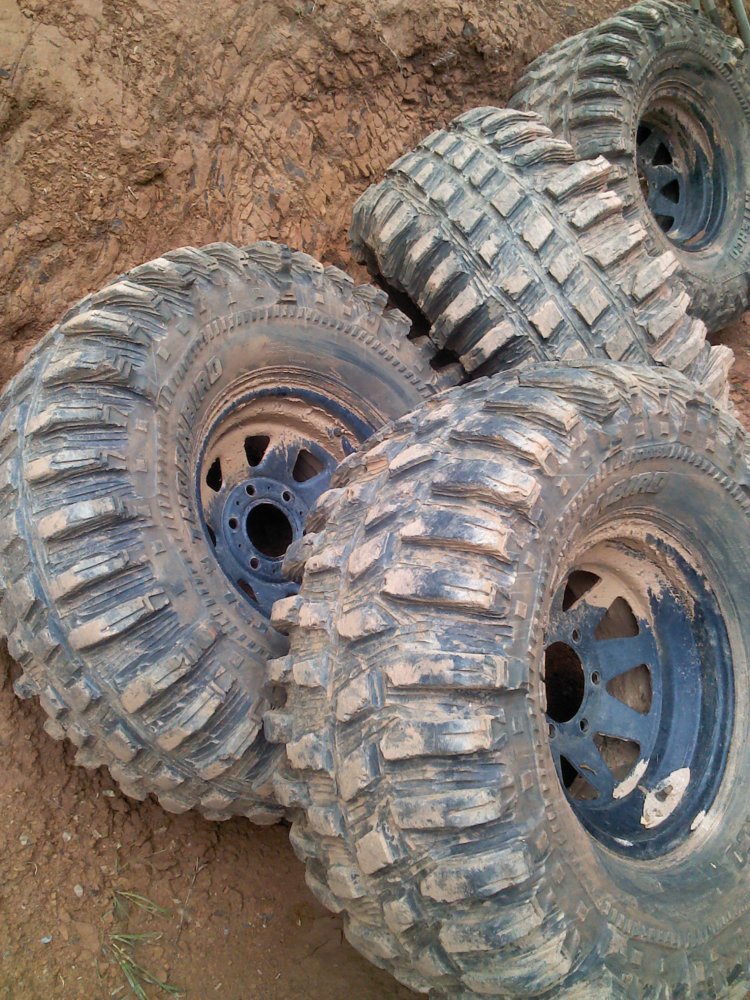

Here's some Thornbirds that I still can't believe I went this far with but WORTH EVERY BIT of the rediculous hours I had in them lol...many saw them in action and they were pretty bad ass

you think that's bad lol, imagine about 60hrs total on those thornbirds I had..hoowey that was fun, not really. I've been doing it about 9yrs now and gotten used to it. What helps me is some music, some cold beers and takes the focus off the job at hand (for me). My wife hates when I do this but I've actually brought them in the house before while watching movie or tv show LMBO all night just grooving away.

Those Thornbirds look like they might somewhat work offroad.
oh trust me, when I was running them, they did a lot of the work for me lol. many were very impressed including myself of how well they performed, even on rocks surprisingly but sold them to a "mud bogger" and he's now getting the designed use out of them!! That was with 1/4"tread starting....imagine a new set of thornbirds that come with 1" in the middle OMG, that's my dream tire someday, a new set of those grooved just like that! (now I'm sitting on plain old pro comp Mt's about 25%tread :( so that's gonna be very interesting wheeling with them...but I bought a winch!:rockon:)

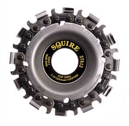

Pick up one of these and matching guard/depth gauge from harbor freight.
Wayyyyyy faster & cheaper than a normal groover.
Just make sure you are fluent with running a grinder, and your insurance is paid up before use
now that right there is something I have yet to try but dang if you ain't got me going now..I'll be picking up one of these bad boys as soon as we move off the mountain where there is Harbor freight!! thanks, looks fun and much much faster than even router
No, no you shouldn't. That's widely known as just about the most dangerous attachment you can put on a power tool. They have quite the reputation of destroying perfectly functioning hands, and fingers, and wrists, and forearms.
If you don't believe me, just Google "grinder Lancelot accident" (the bigger size is called Lancelot instead of Squire). Do not go to the images tab after you Google it though.
Seriously though, it's all the potential flesh-mangling danger of a chainsaw, but with none of the control because it's on a grinder..
You seem like a good guy, please stay far away from those things. Be safe, use common sense, don't buy one.

Not any more dangerous than a thin cut off wheel and sheet metal.
Especially with the guard with the depth gauge.
Definitely more dangerous using that on wood.
The rubber has very little restriction on the wheel, same as using a small chain saw.
Dangerous yes, but no more dangerous than a grinder with a thin cut off wheel.
Again be sure to use common sense and the guard with it.
Another option is a small 16" chain saw, even electric would work.
Another option is one of the multi tools that oscillates like a fein. Sharpen the flat tool like a chisel and scoop the lugs off. This works better for removing entire lugs.

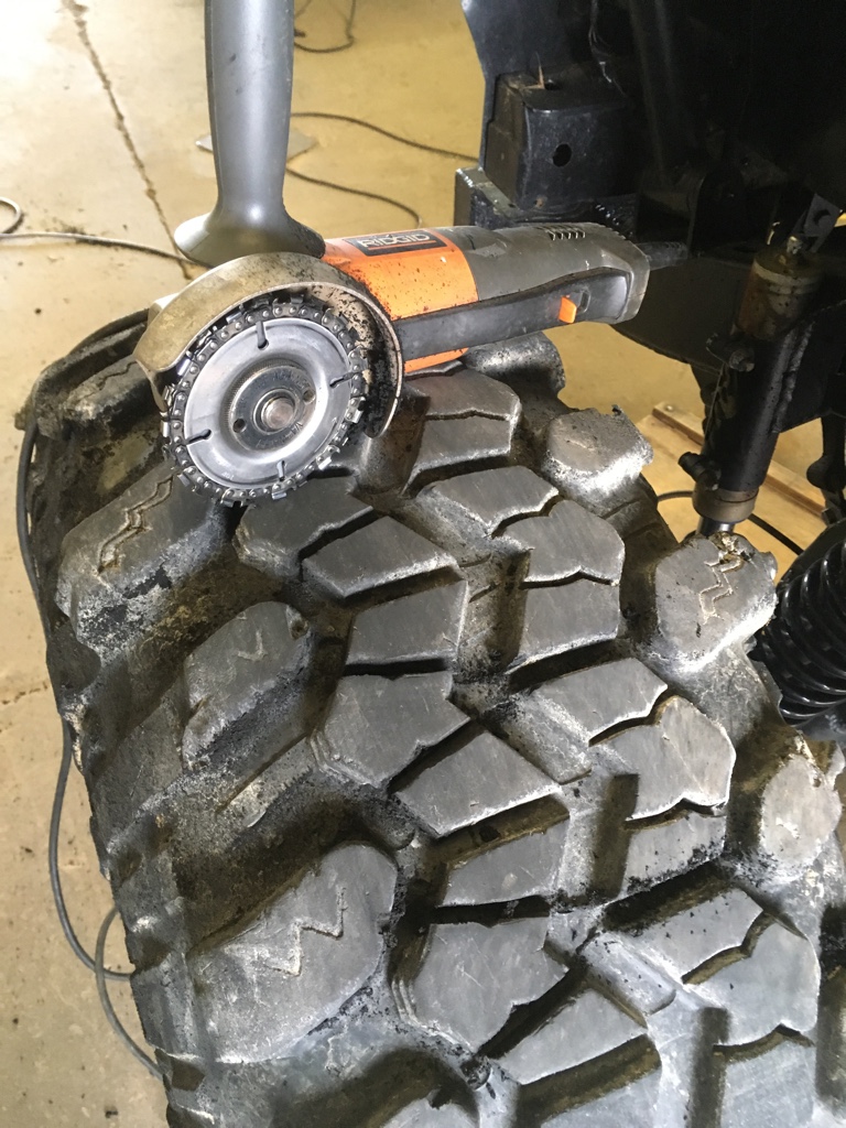

So I got out my harbor freight wheel of death and tried it out. I'm opening up the lugs on my sx2s, similar to how you would cut a tsl.
Groover grinder works great.
Doesn't try to catch, works good and fast. Removes rubber fast, but is a bit messy.
I have on safety glasses, leather gloves, face shield, leather jacket, etc. all similar ppe adequate for stick welding, arc gouging, or all day grinding.
I am running a guard on the grinder and an extra handle.
After reading all the safety concerns, I back up my previous statement that it is no more dangerous than a thin .045 cut off wheel on sheet metal.
In fact this wheel goes through the rubber easily so there is very little yanking of the grinder similar to a thin wheel on sheet metal.
I am very intimidated by it, but it works well.
I would not want to use it on wood. Lol.
