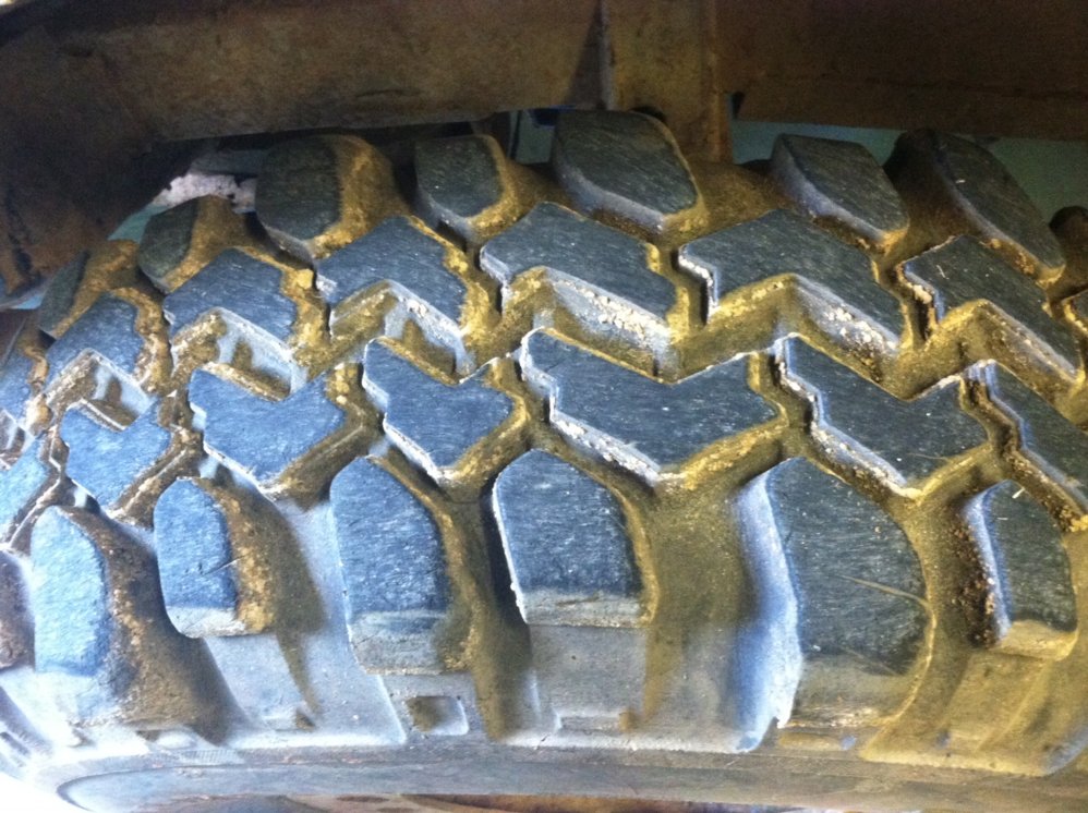

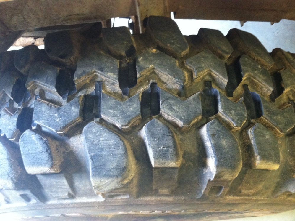

I recently did some grooving on the 34" LTB's I've been running on my Samurai.
The LTB's have sort of an overlapping lug shape on the ends of the middle lugs. I just cut the overlapping parts off to create about a 1" wide gap.

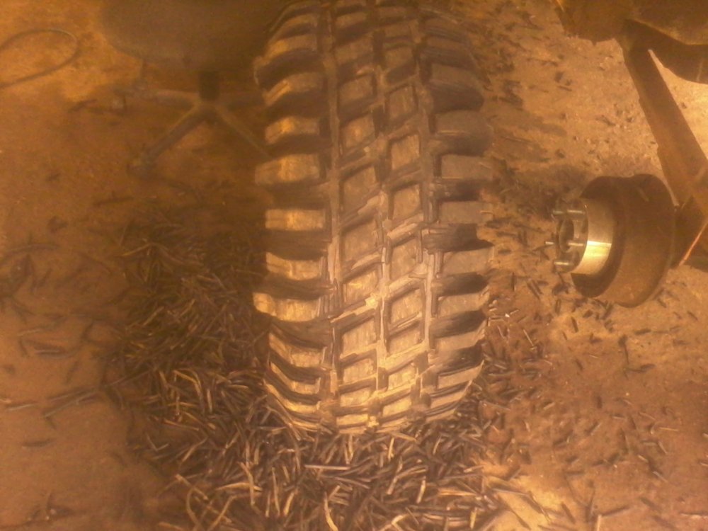

i did new set of 36x12.50 TSLs and WOW..the center was close to 1 1/8 and side lugs were really deep...at 5psi they were the best performing tire i had seen yet until i came across Thronbirds and now i like grooving thornbirds better.....i can't wait to someday groove a new set of them 38.5 would be my dream size in new Thronbird Regrooved!! these started with 1/4" tread and look how deep they are so imagine new set!!
dude hit those lugs an straighten them out and you will really love them...night and day difference when the tsl/ltb lugs are straightened and sharpened similar to what i did on the thornbirds....9yrs of grooving and i've learned the big hunky rounder lugs that TSL/LTB come with don't grab nearly as good as they could so straightened out and sharpened down to 1 1/8wide bites the best in my experience and testing.
