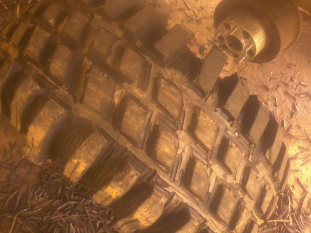

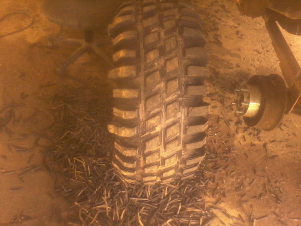

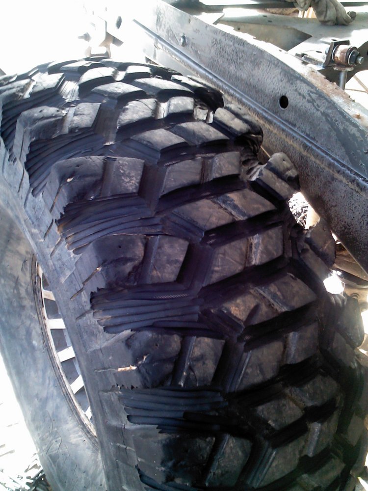

@fordtrucknut , swampers can usually go right at a solid 5/16" in the middle Under the tread itself...then usually close to an 7/8" at the outer most part of the lugs. I've ran MANY tires including a set I'm finally selling all the way down to the chords with no problems of weaknesses. Only on steel belted tires can you NOT got to the belts but swampers that are all nylon belts and be just fine. Here's a set of thornbirds i went ALL the way down everywhere as deep as can go and ran them for almost 2years problem free (minus breaking beads here and there lol) here's some pics for ya..have fun grooving!! oh and IF you do cut into small pieces of the nylon belts here and there, no biggie I've done it many times as long as you just accidentally "skim" it.

I've been grooving for long time and I've not seen any "extra weakness" from loosing that little extra rubber underneath tread. If you are worried about it though (as some customers I've grooved for have been) than just find the deepest you can go down...then set your blade a good 1/8" higher and do it that way. Good luck, ask away any other questions!!
