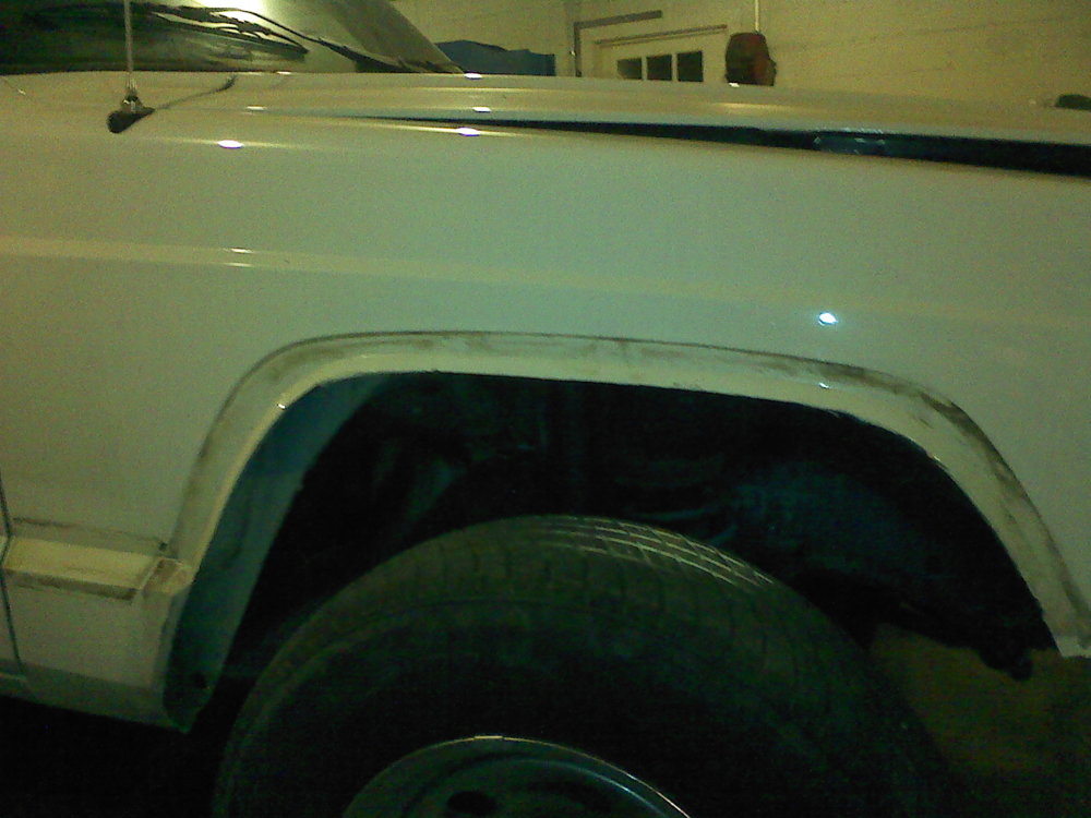

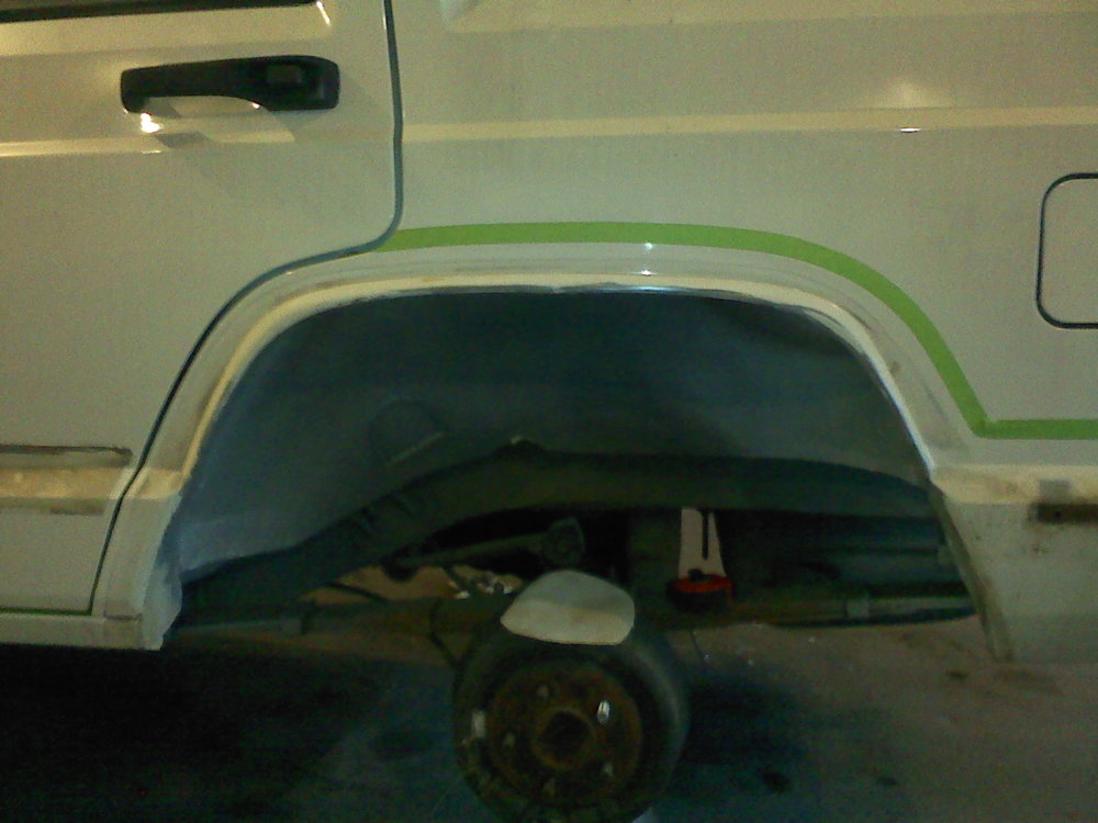

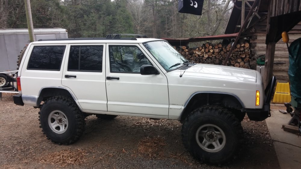

you can stuff 34 x 9.50 with the right offset...even 35's of the right profile....

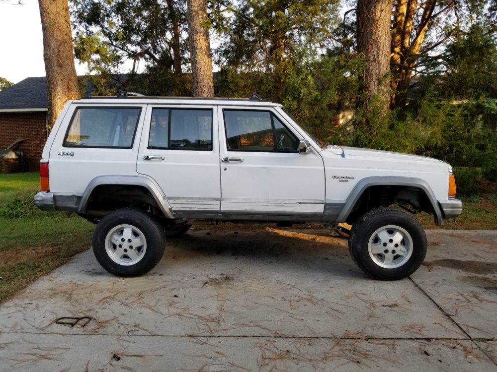

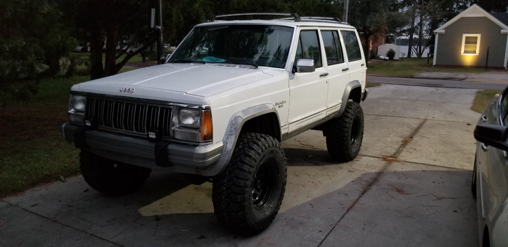

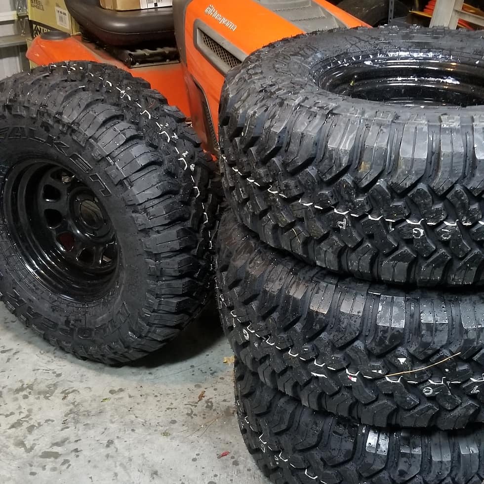

Took the advice to get different wheels and I am glad I did.
what are the wheel specs? brand/part no, backspacing?
