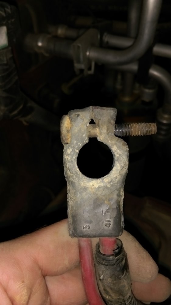

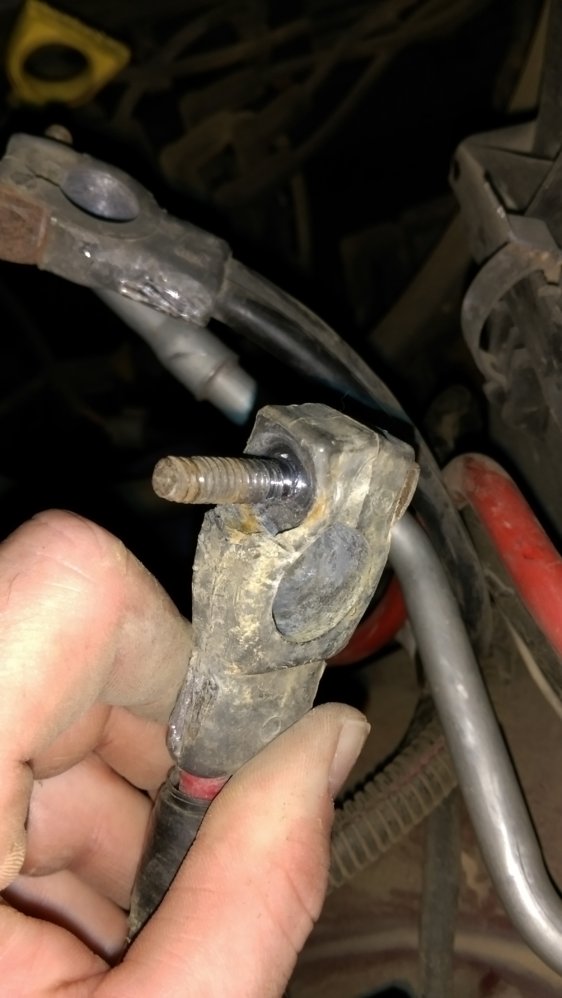

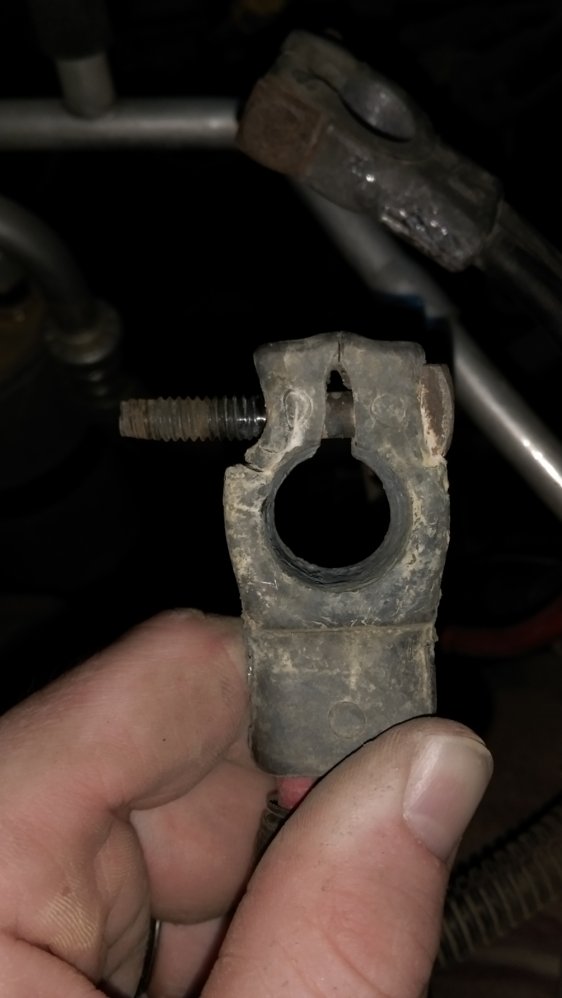

Was taking the battery out of the TJ to replace with a new one and noticed the positive terminal is cracked. Should I replace them while I got the battery out? What kind of terminals do you recommend? Do I just cut the wires just below the terminal or is there a way to get these off without cutting the wires?
Looks like I will be getting the O'Rileys AGM battery.
Replace it. It will fatigue and break and leave you stranded somewhere.
You will need to cut it off if you want to reuse the OEM cable, else you can buy a new OEM cable or a compatible replacement. I just did a quick search and most all of the drop-in replacements are over $100, which is completely ridiculous. You can get aftermarket cables with the stamped terminal type (a lot of cars come with those from the factory) for about $20 for your TJ most likely, but it's not going to be the same quality as the OEM.

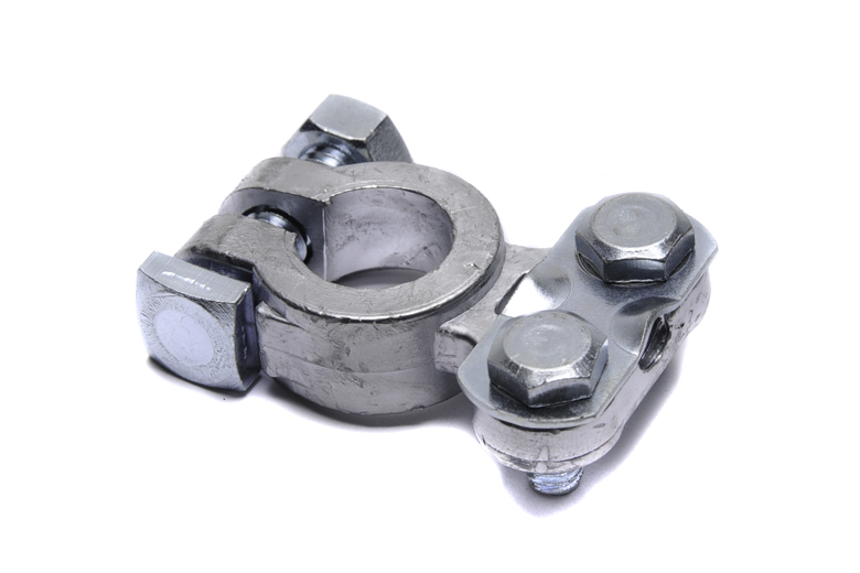

If you have an automotive electrical shop near you, they could likely make a nice set without you having to buy the really expensive crimpers for the nice terminals. There are various types of replacement terminals with screws/bolts/clamps/etc. for the battery cable, but most of them aren't really great solutions.

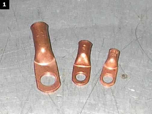

No need to get fancy. Cut the old end off, strip back about 3/4" of the insulation, install one of these and be done.
If you have a soldering iron, bonus points for adding a little solder as well.

Or just buy a $.99 end from the parts store like I showed earlier and attach it with a 7/16 wrench. If you lack the tools or experience, that will work just fine.

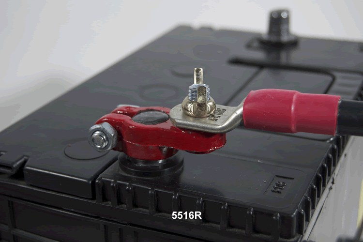

I like to use marine style battery terminals and solder lugs on the ends of my cables. I did that on my Ram about 6-7 years ago with great success. Still working fine today. I also did it on my Samurai several years ago.
Like this:
