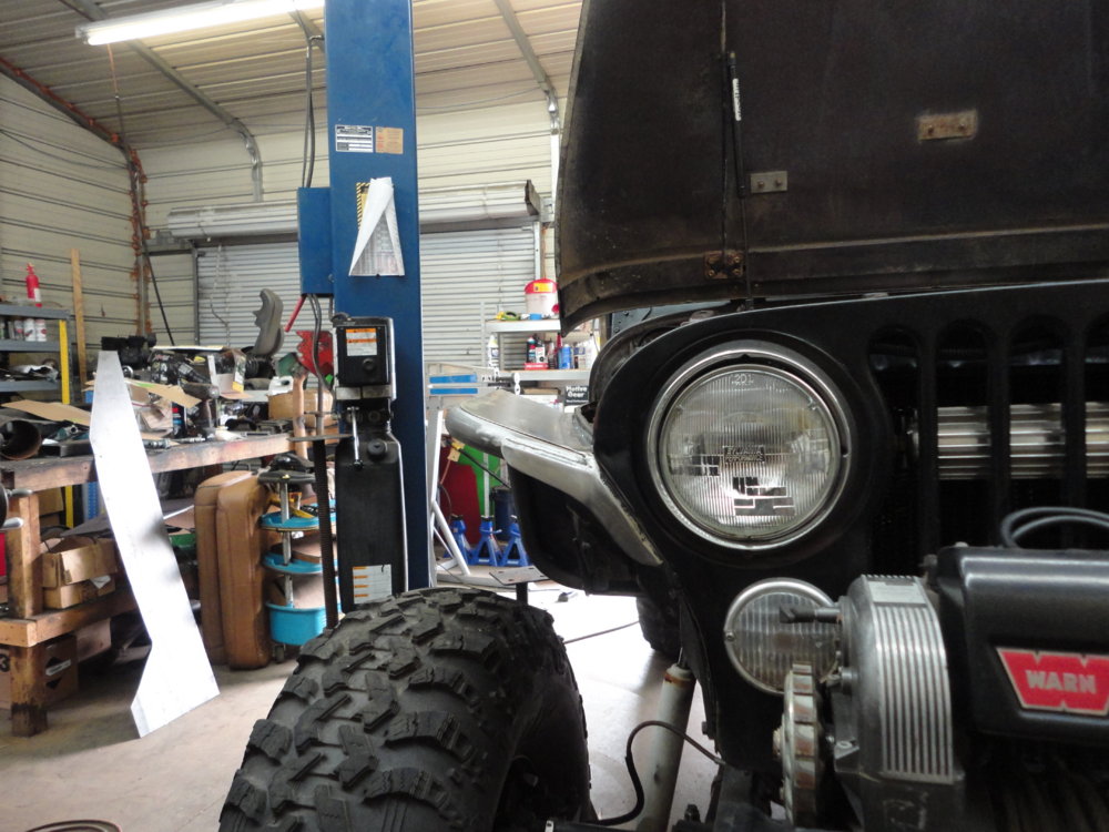

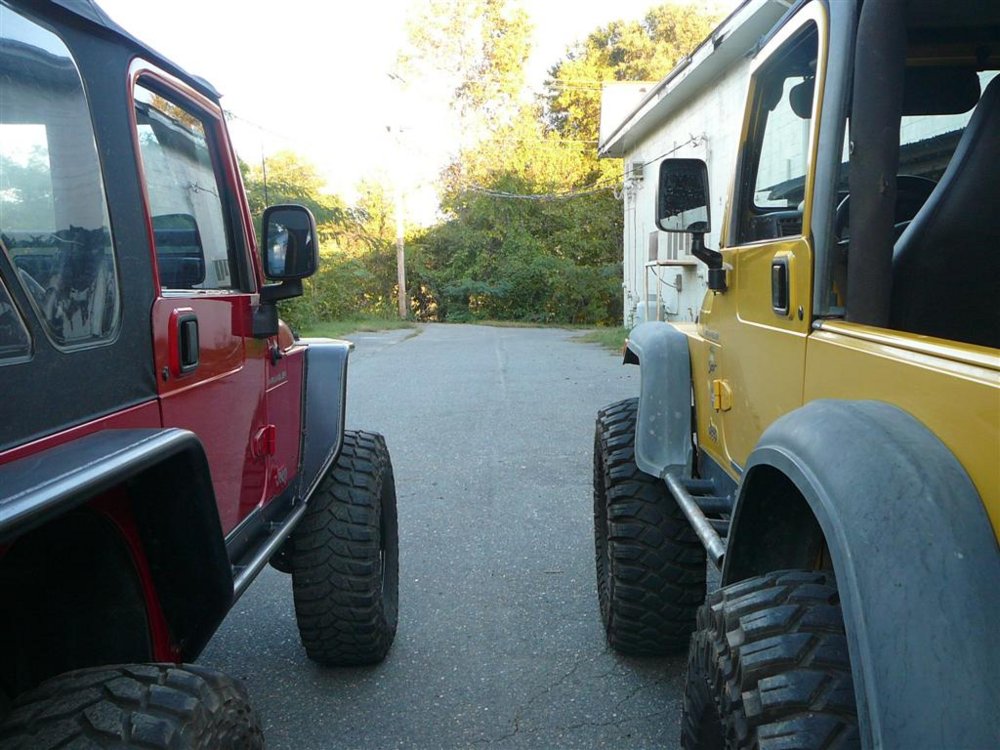

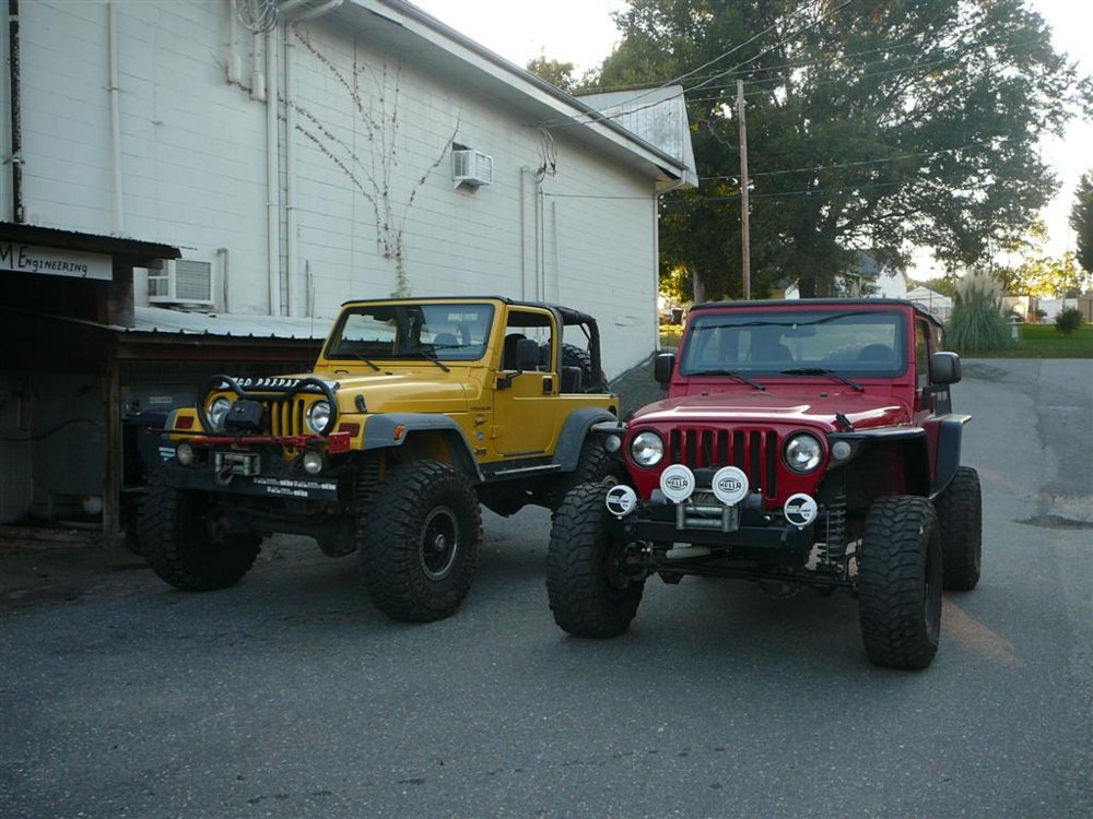

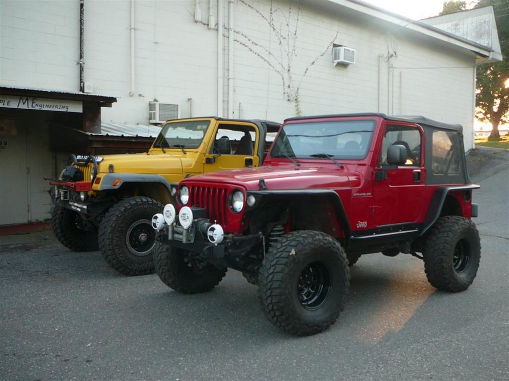

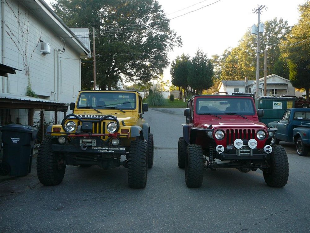

Cutting the hood is easy, don't let that intimidate you. The clearance gain is HUGE! Here's a couple pics of a hi-line I did on the red TJ with 3.5" springs, 1" body, 35's, sitting beside my yellow TJ with 4.5" springs, 2" body 38.5's (and Bestop 6" flares). If I remember right, I cut 3-1/4" off the hood, and used 1.5" tubing for the edge of the fender/flare. So compared to stock, you would gain at least 2-2.5" of clearance.

Metal Cloaks give 2 5/8" above the typical tube fender (non highline), so it is very close to the same gain that you got, with no cutting needed.

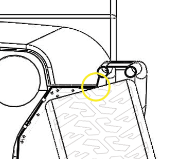

The Metalcloak ones definitely are better than a standard flatfender, as you really don't gain any clearance with a standard flatfender. But they are more limited when compared to a highline because the seam gets raised 3" also with a hi-line, not just the outer flare. They even kind of show it in their diagram (2nd yellow circle):
I personally don't like the look of the Metalcloak's, but if you like them, they are definitely an easy way to go that provides good clearance.
I cut the stock hood with a 3" air powered Harbor Freight cutoff wheel, but it could easily be done with a 4.5" angle grinder too. The keys to success were pretty simple: 1. Don't cut too much, you can always cut more. 2. Mask off the surrounding paint so when the tool chatters or slips, you don't mess up anything else. 3. Slow and steady, a little bit at a time.
Basically, I measured how much I wanted to move the inner fender up, then traced a line that high off the bottom of the hood. Then I cut along that line, test fit, cut a little more, test fit, etc. I think it was 3 passes on the first side and 2 on the second. Next take a sander or flapdisc and knock down any burrs. Then I spray painted the bare edge with a touch up spray can from auto parts store, and put some type of door jamb trim or something over it, also from auto parts store. Honestly that part was pretty easy, relocating stuff under the hood was pretty easy, but the difficulty was moving the fenders up, and only because I was overly particular about how it was done.

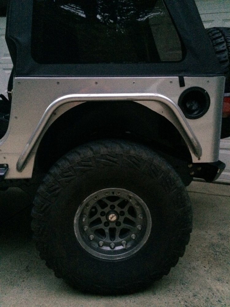

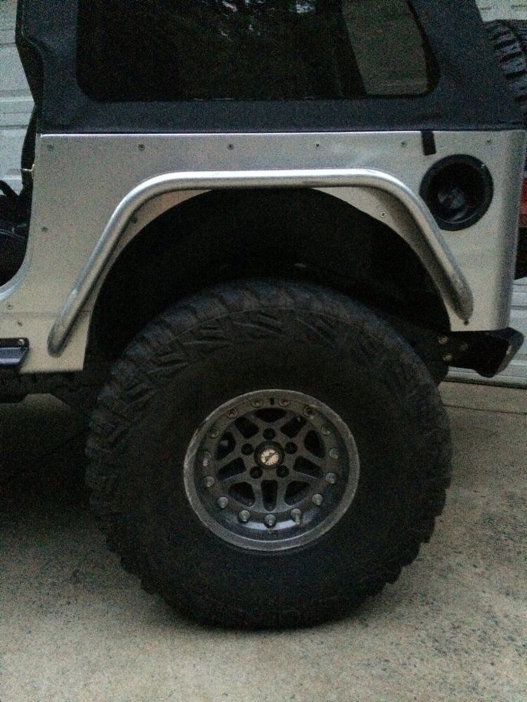

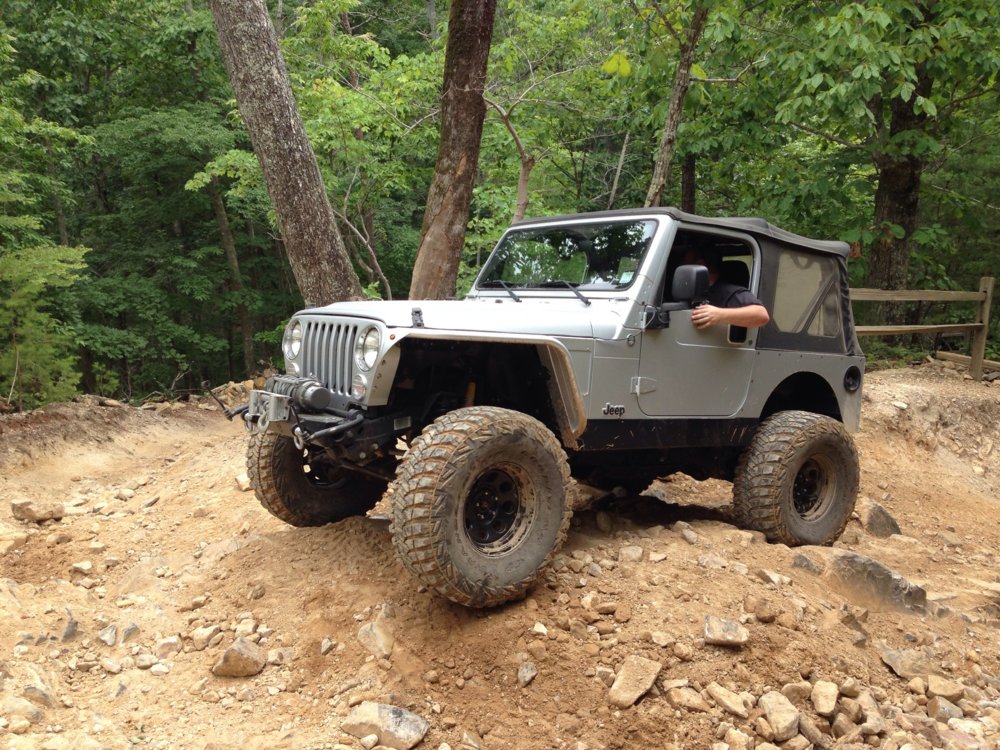

I'm running the same setup- 35s, ome susp, 1.25" body with tube hi-lines. I would say go with the highlines so when your 35s wear out you can go bigger!
What fenders do you have? I won't do bigger than 35s for a very very long time, if ever. Still going to use my 32s for daily use around town.
Genright.. Honestly 32s will look silly under these. Sometimes looking at mine the 35s look small

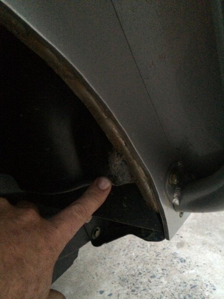

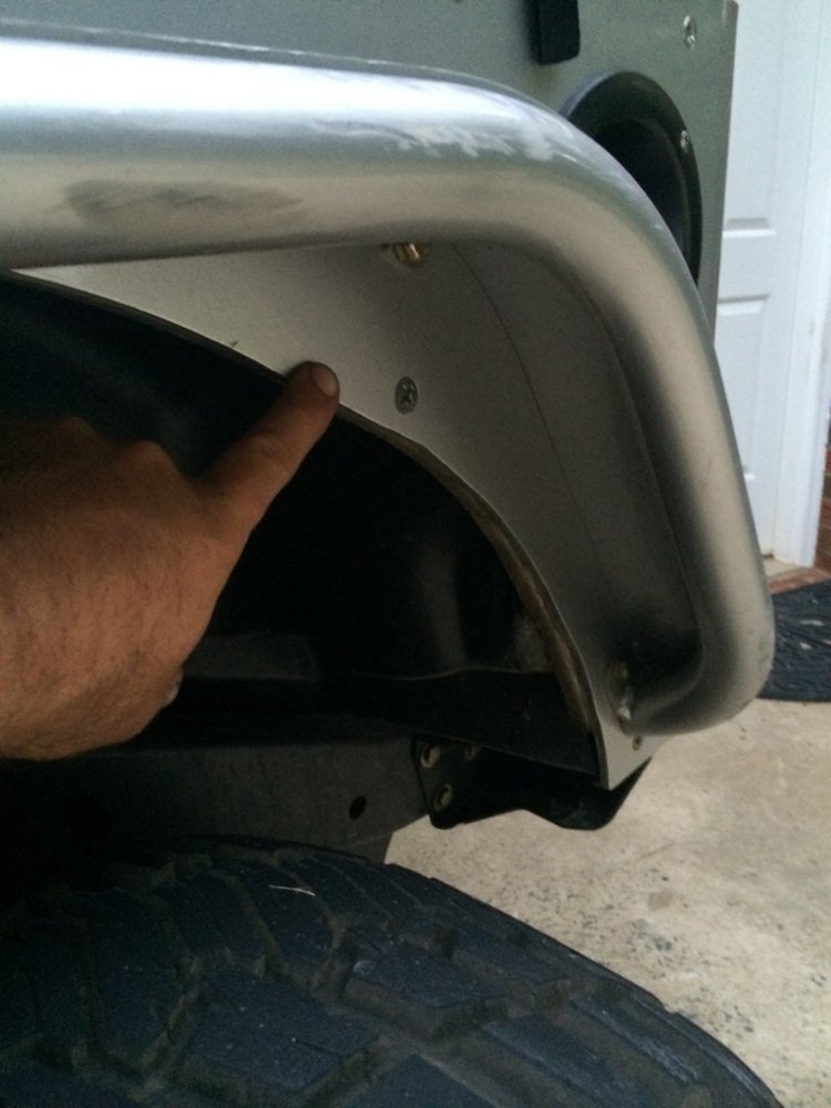

Semi thread jack. When you do the high line front fender, what do you do in the rear to keep the 35s from mangling something in flex? Bump stop like crazy?

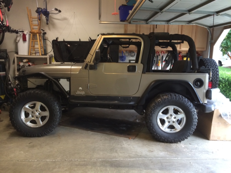

You will need to trim the rear of the fender well. I had to trim mine from where my finger is, down.
I saved the lip and tacked it in place so I could reuse the fender liner. Had to plastic weld a small corner.
