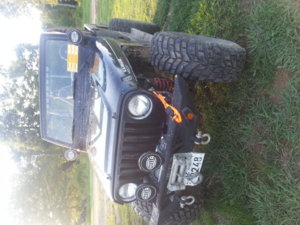

Hey guys, I have a 99 wrangler TJ Ive already cut the front fenders flush with the hood and installed hood pins. I'm considering cutting the rear fenders to match. I wanted to know a good way to do this. Ive seen pics and they mostly all follow the fender and go straight back. my question is how complicated is this? where would you relocate the fuel spout, etc.. and what are your opinions? basically im eventually wanting to do a full width axle swap and possibly slide the rear axle back a little.
jeep7.jpg View attachment 74690

Instead of cutting the rear now, id wait till you are ready to do the axle swap. You really dont need to cut more then you have to. Mine was cut from previous owner. I wish he didnt cut as much off.
