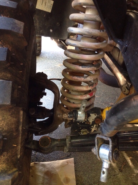

So what do you TJ guys do for disconnects on the front sway bars and what do you do to hold the sway bars when discoed? I ran no sway bars on my old ZJ so this is new for me.
Here is a pic of my current setup, not sure what kind of discos they are, but the top end links have been broken and welded back together and not sure about all the washers on the top of the end links
A common way to keep the sway bar out of the way is to rotate it all the way up into the fender, Zipt tie it with a large tie to the brace inside the fender well that it is close to. This will keep it out of the way and keep you from puncturing a tire on it as well Most all disconects of whatever brand are similar to what you have, all function abou the same, I think there are a few out there that come with these crappy brackets that the sway bar ataches too to keep it up out of the way. Time for an antirock sway bar(torsion bar) install it, set it, forget about it.
