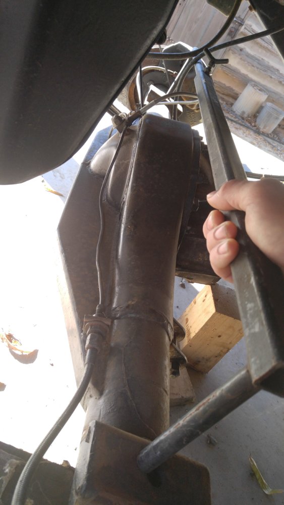

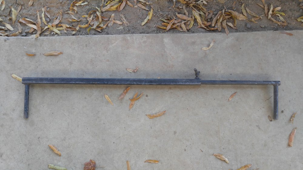

Went and snapped a pick of a tool I made years ago to help layout axle brackets regardless of width. Helps measure and transfer components without the diff throwing things off.
Your welcome to borrow it. Similar could be built out of most anything.
Set width, center, mark, repeat. I set it in the center pin hole. Center and done.
