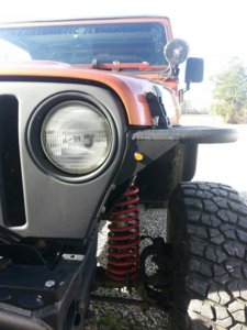

I used JK signals on a customer's jeep, and if I ever do mine, I'll do it the same way:

The jk turn signals 2014 and up are clear lens too I believe. I used cj signals in my tj and they leaked water in the housing, I think they were cheap knock offs though. I put mine in the grill with a holesaw.

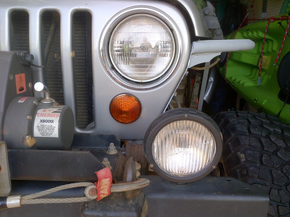

I used 3/4" marker lights in the tubes. I didn't think they were enough so I also put CJ lenses in the grill.
Thanks for the replies and pictures everyone. I did the JK turn signals and am well pleased. The 3-1/8" hole saw cost more than the lights!
