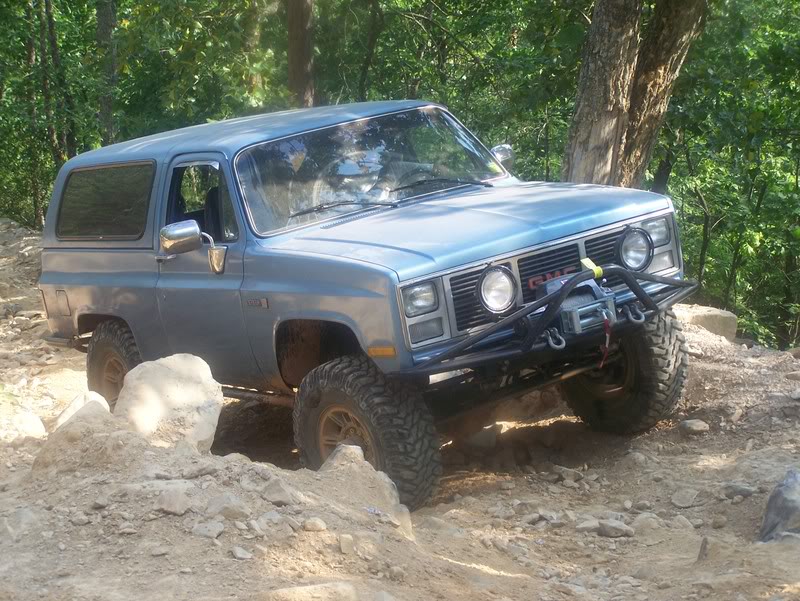

We're about done with the build on my 87 Jimmy and took a trip to URE with friends on saturday and tried it out!

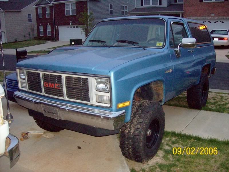

When I bought it (about a year ago, ignore the date, it's wrong, didn't know how to set up the camera date):
How it sits now (picture taken at URE):
I'm happy to be able to wheel it! :driver: I bought it a little over a year ago and the motor blew up in it two weeks after I bought it. Then, it sat for a while while I figured stuff out. Well, finally got around to building it, with a lot of help from friends!!!
Specs:
87 GMC Jimmy
stock TBI 350 crate motor
SM465 4spd w/ ORD 32 spline short output shaft
203/205 doubler w/ triple stick, 32 splines all the way, 1410 front yoke, flange rear w/ HAD e-brake with a custom crossmember and skidplate setup a buddy of mine built
Dana 60 front w/ 4.56's, ARB, 35 spline outers, Teralow hubs
Corp 14ff rear w/ 4.56's, Detroit, 1.5" spacers
ORD front low profile bumper w/ 9500ti
DPI sliders and rear bumper
3" Tuff country EZ rides up front, ORD shackle flip and RuffStuff swap kit out back Bilstien 5150's all the way around on F250 towers up front and custom crossmember out back (built by same buddy that did the t-case crosmember/skidplate)
37" Cooper Discoverer STT muds on 17" H2 take offs
Thanks for the compliments y'all! Yup, that was me with it on the trailer at Concord Mills, was running late to meet my GF to see a movie (she made me watch Sex and the City movie :() Yup definitely wanting to make a run to Rausch this summer, I am going to be living about 3-4 hours away from it when I go up for school (gonna be going to Wyotech in Blairsville, PA for 9 months). I love wheeling the Jimmy so far but, it is gonna take some getting used to a full size and manual rig! I was using the mirrors as tree feelers at URE! :lol: :driver:
