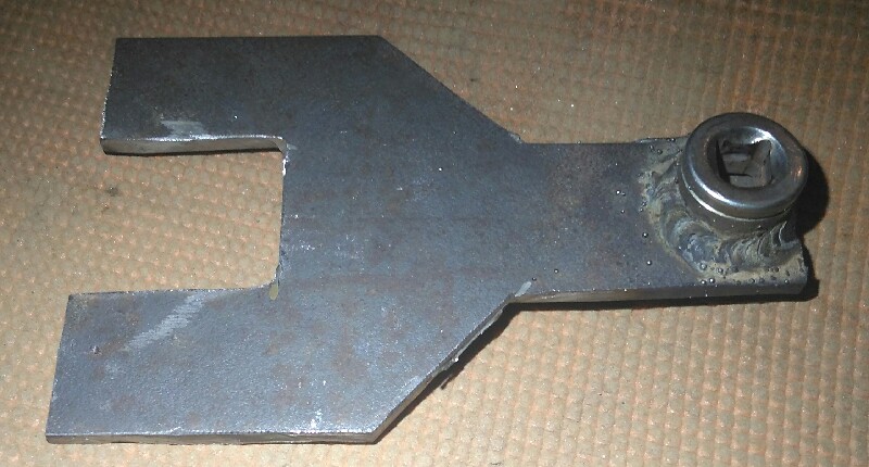

Fan clutch wrench (47mm, Ford 6.0, made today, overbuilt since the loaner tool flared on me.... don't mind my quick HF AC fcaw in a rush weld)

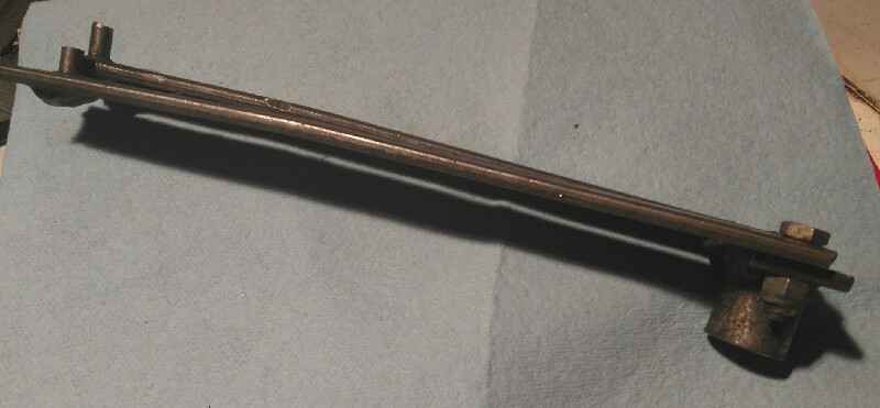

Spanner wrench (grade 8 1/4" pins from bolt shoulders, too big for some applications, made for hyd cylinders but found many more uses since)

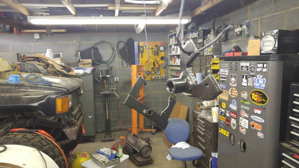

Sheave holders for my grizzlys. Still need to drill and tap them so I can keep up with the hardware to bolt them on

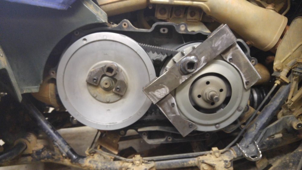

Built a tool for installing torsion keys. Welder some pieces of scrap and a few grade 8 bolts

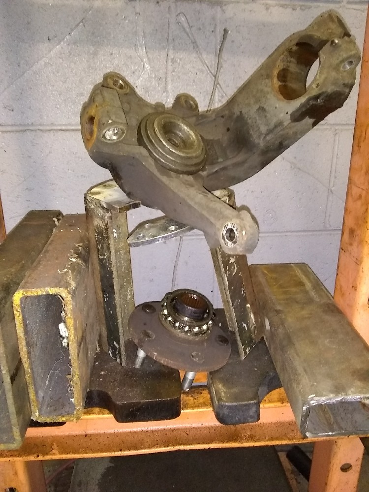

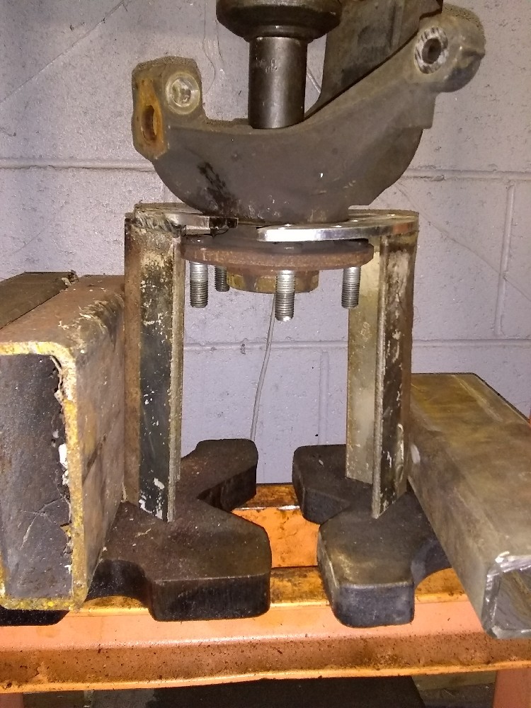

Wheel hub removal press adapter. Used to use a slide hammer with a lug adapter.. needed to remove a hub and forgot the slide hammer & adapter at the shop at home. Advance was closed. Hmm. Some scrap metal, some cuts and welds. I need to bore a hole at the bottom of both pieces of angle iron to permit a bolt/all thread to go through to prevent it from spreading at the base (thus the shims on either side) works great, way easier than the slide hammer.
