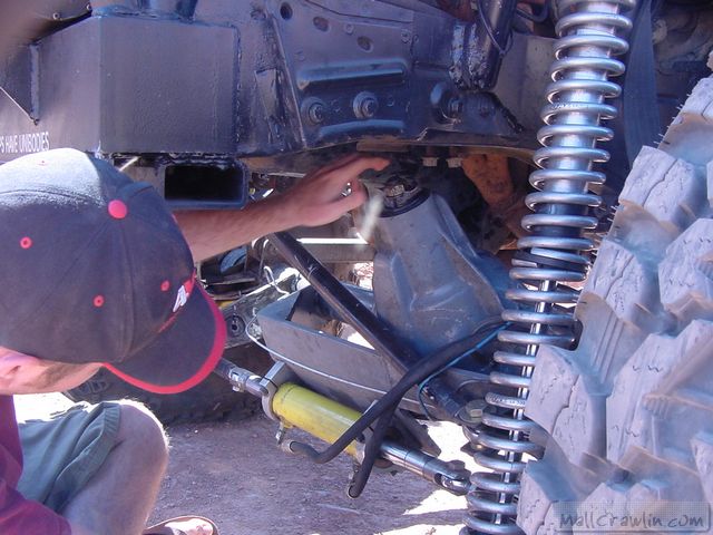

Just got back from Moab and tested out the new toploader D60. :lol:
In actuality this is a buddy of mines rig, he made the mistake of running one UCA with a M12 bolt on his D60. Well coming off of rusty nail there is a long straight away good for some baja action. After a little bit of air the bolt snapped and did a 90* flip. Broke off the coilover collar, the upper arm, one of the hydro ram hoses, driveshaft, and pinion yoke. It made a fantastic shattering noise. Pics of the entire trip can be found here.

I thought about running a single upper on a long arm set up a few years ago on my MJ....thank god my buddies talked me out of it, with my love of the right pedal I think I may have broken all sorts of shizot.

But moral of the story.... running one single upper (especially with larger tires) can have bad consequences.
M12.. Guess he thought that 8.8 meant is was a grade 8.. :lol:
