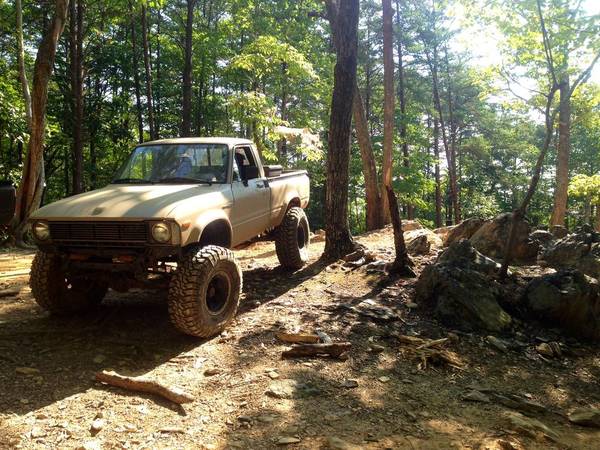

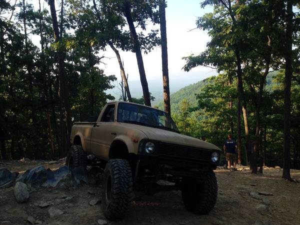

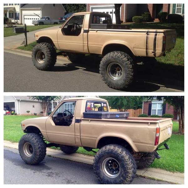

Been a lurker on the forum for a while and decided it's time to get a little more active and would like to meet more people to wheel with and whatnot. I've already done a lot so this will be a reverse build of sorts. I'll go back to the beginning and catch back up to now.

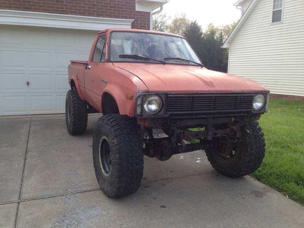

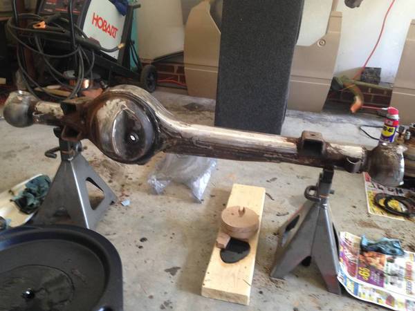

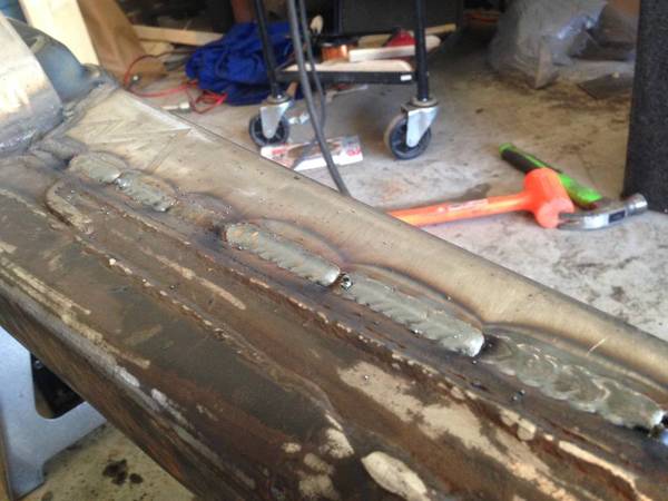

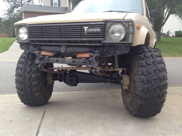

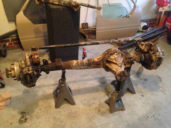

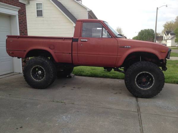

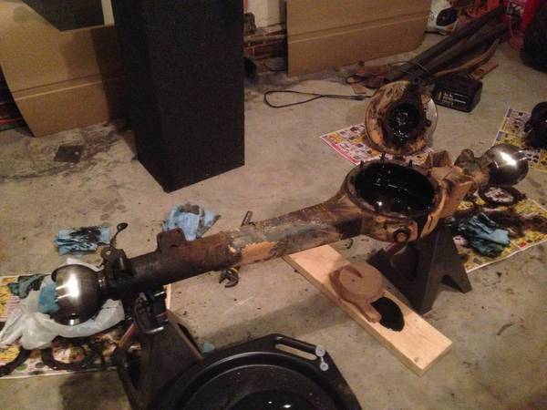

Picked the truck up about 9 months ago from a nc4x4 member. Already had rears up front, high steer, 4.70 case gears, welded rear, lockright front.

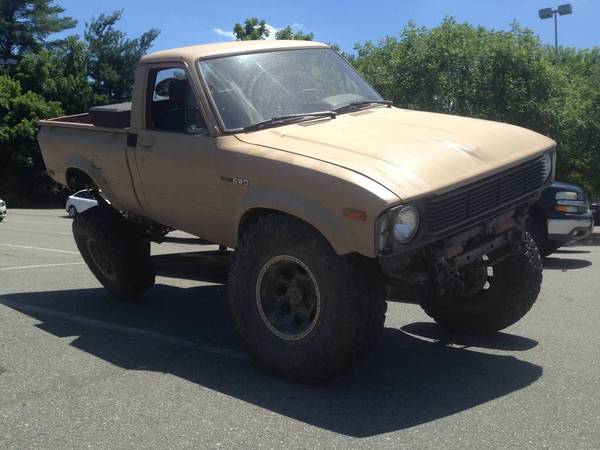

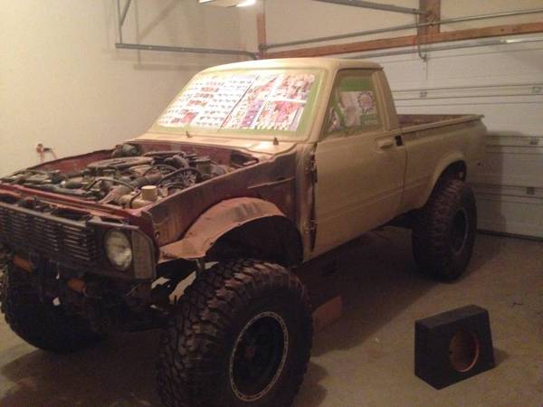

Decided to go tan. Walmart rattle cans and flat clear coated
Picked up some chevy 63's and swapped them in

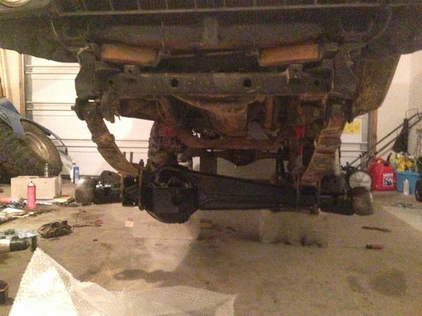

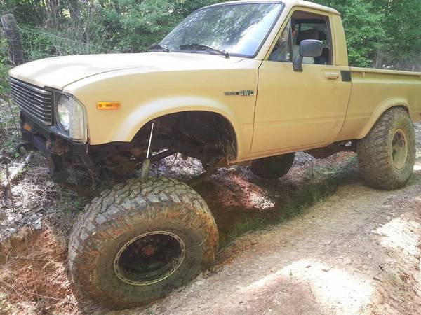

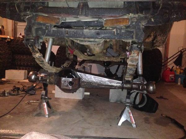

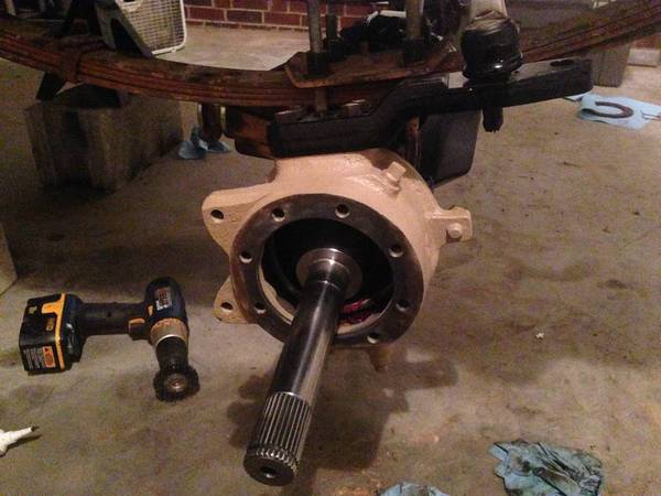

11" forward

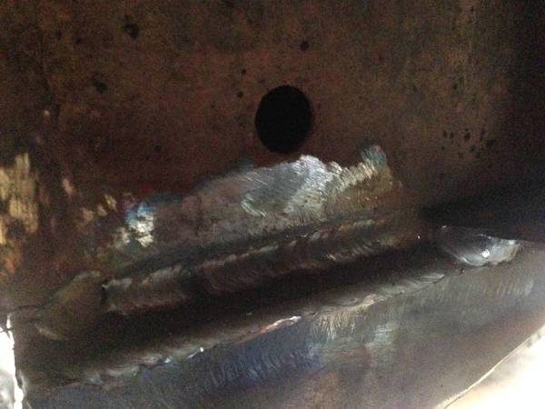

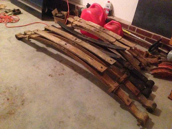

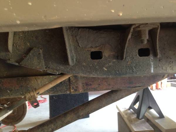

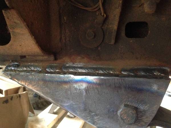

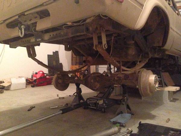

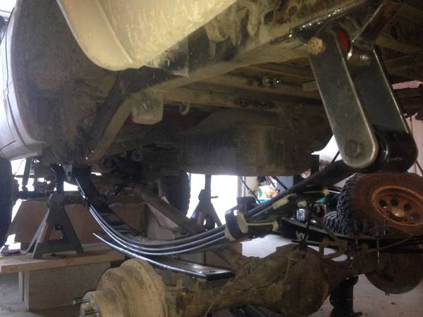

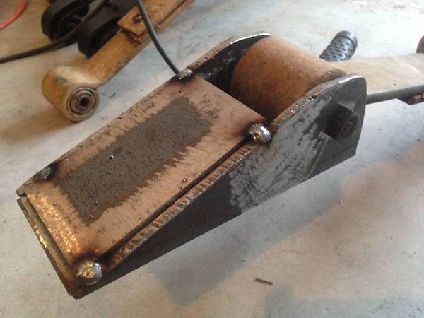

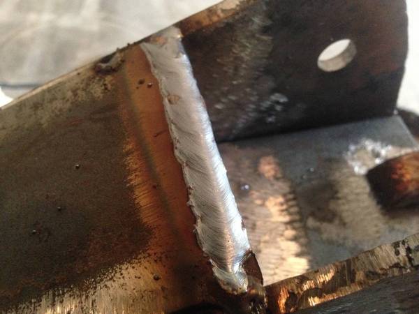

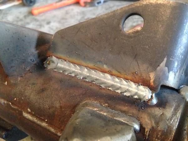

Front spring hangers

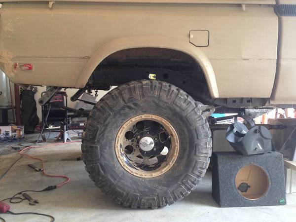

Placement in the wheel well

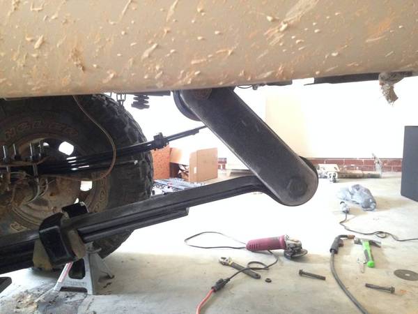

Shackle angle at ride height

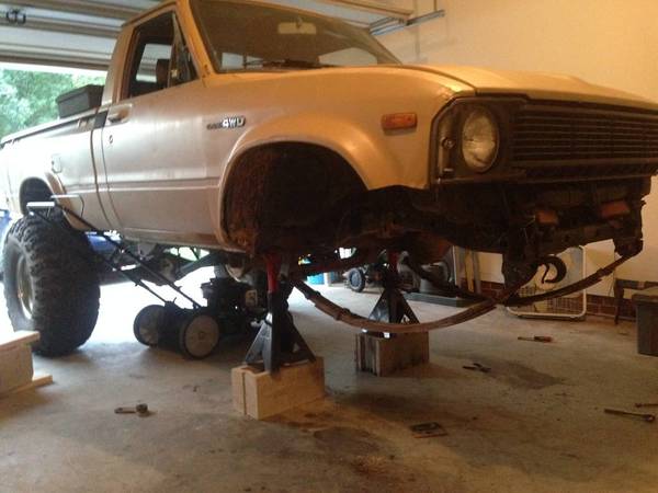

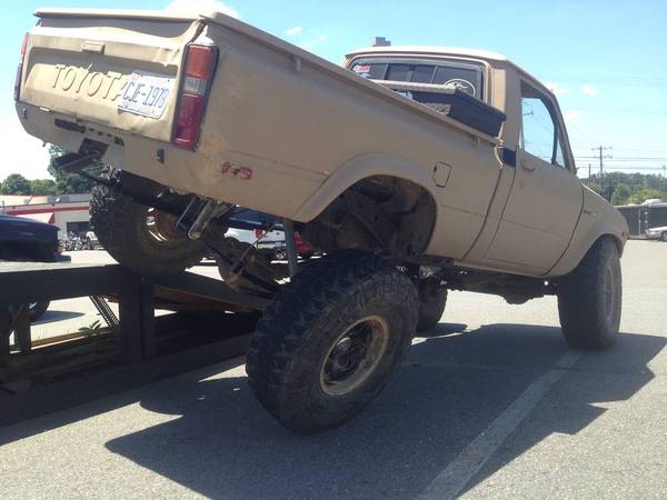

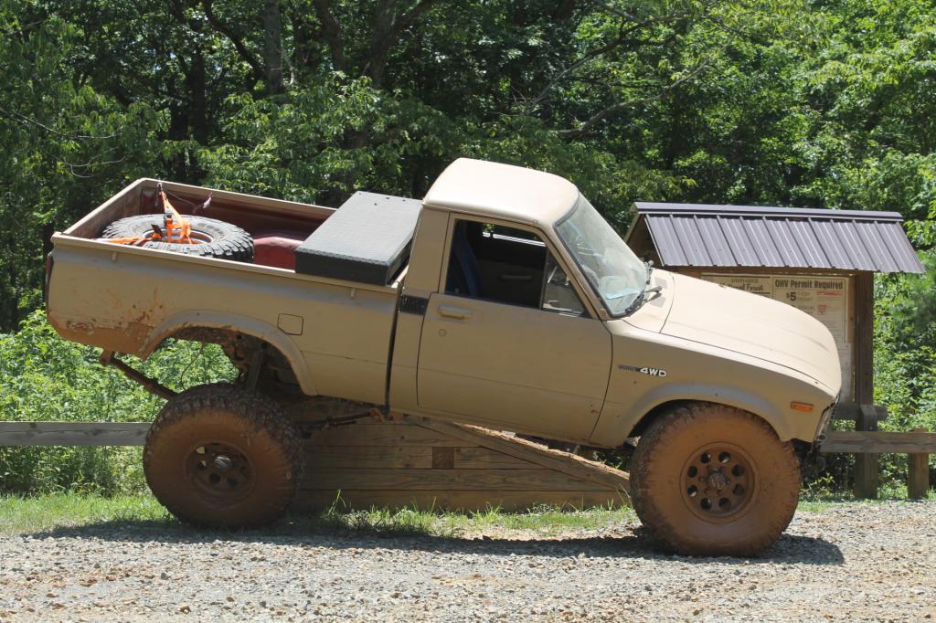

Testing on a sketchy ass loading ramp

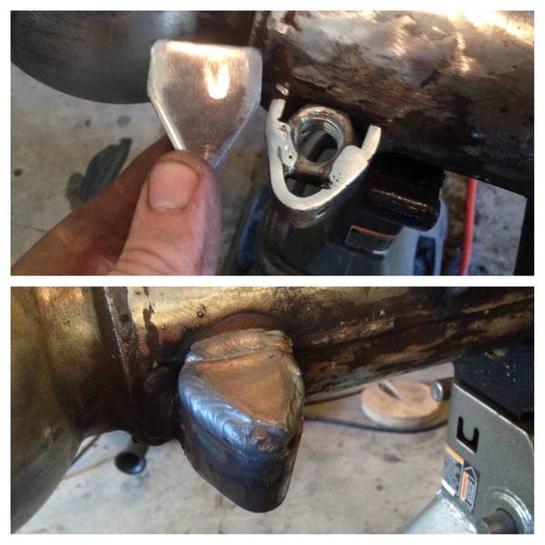

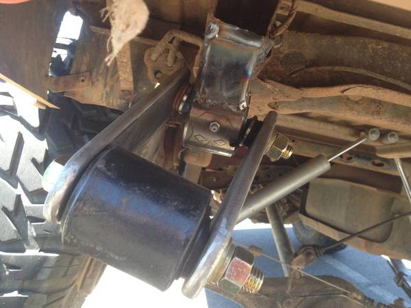

Ballistic joints

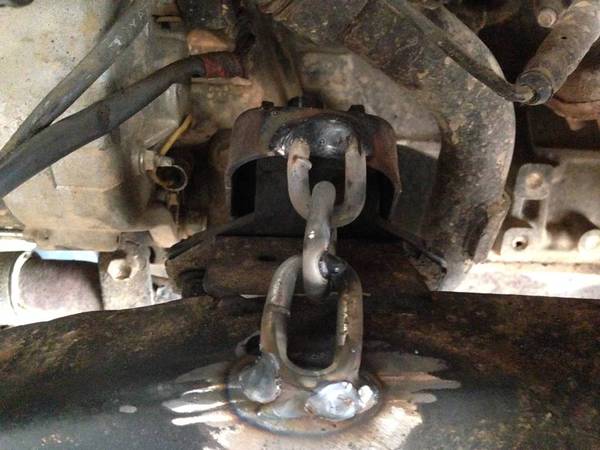

Tore both motor mounts my first time at uwharrie so I picked up a junkyard set and chained the driver's side

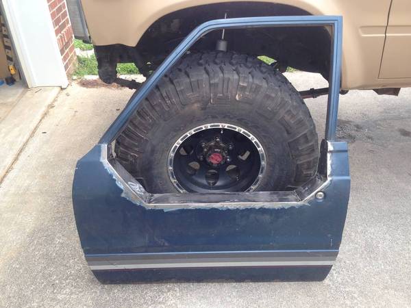

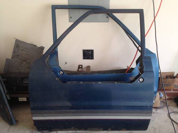

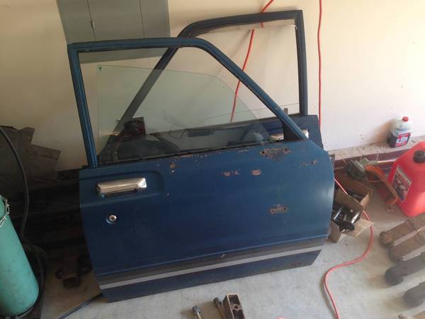

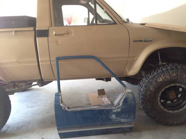

Finally found a first gen in a junkyard so I picked up the doors and started cutting.

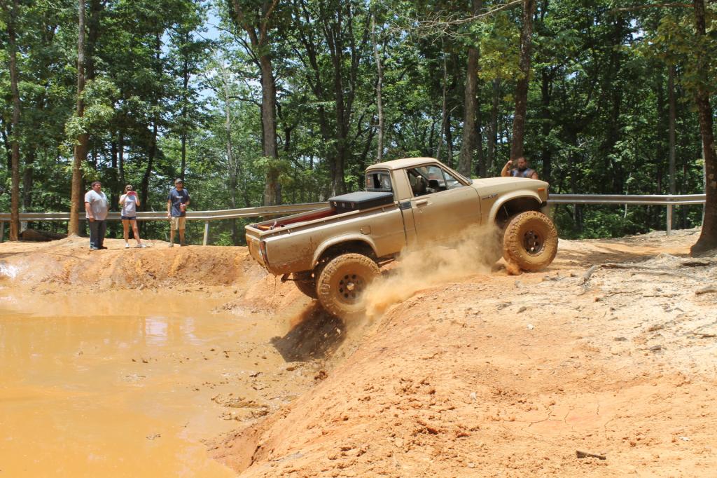

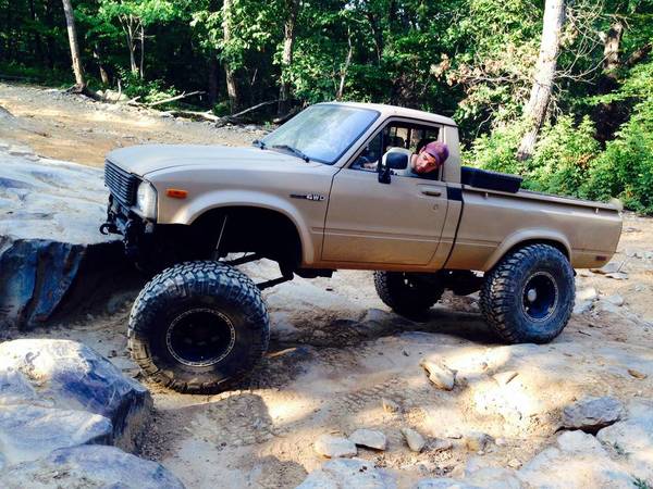

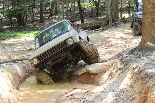

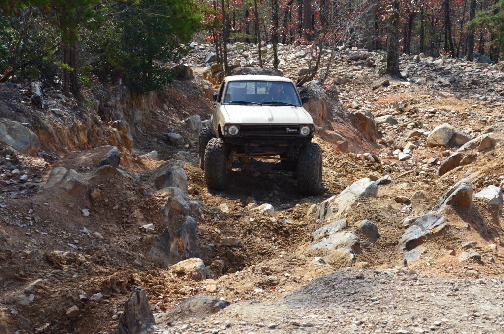

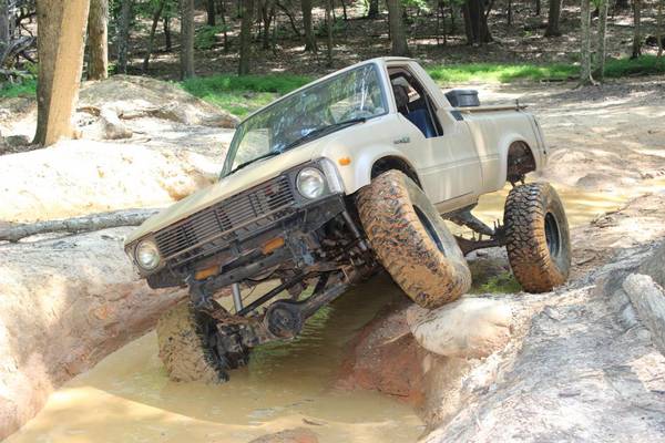

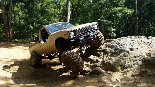

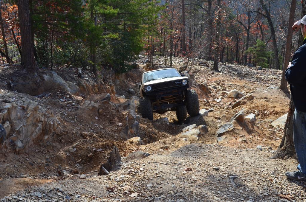

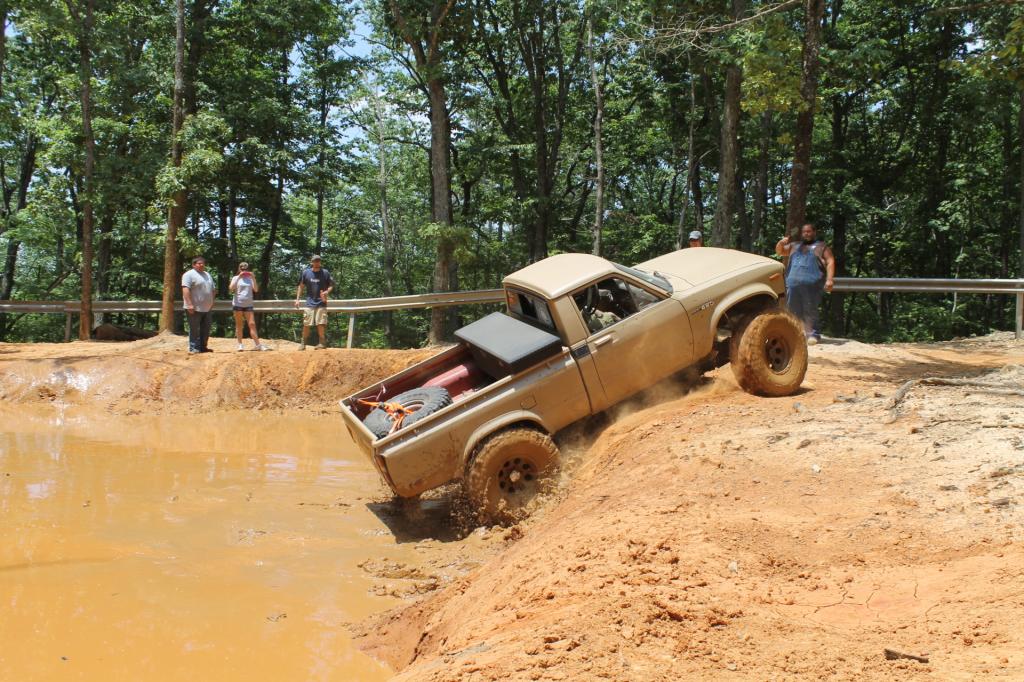

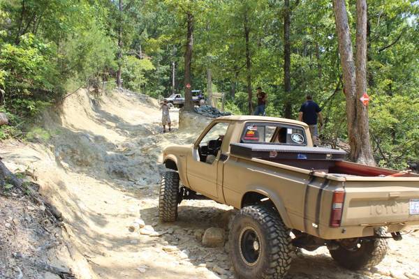

Some wheeling pics

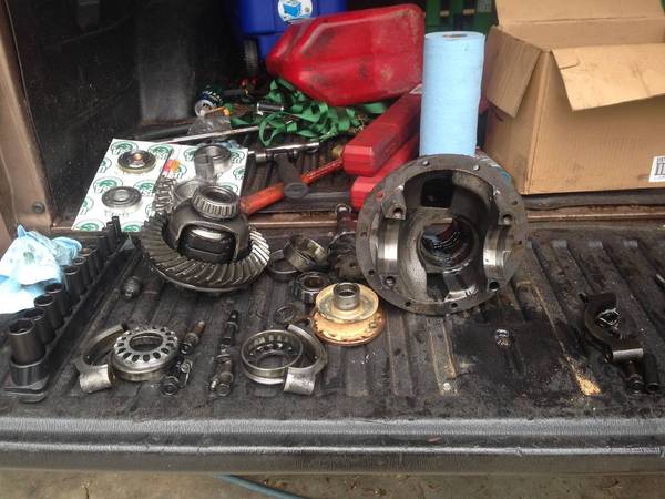

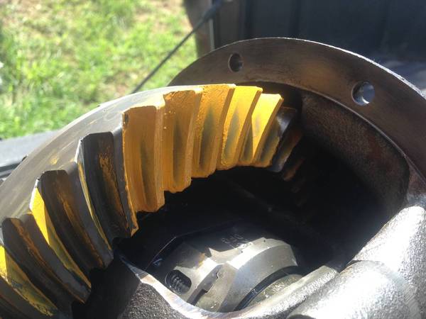

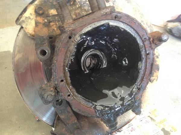

Ordered some goodies:

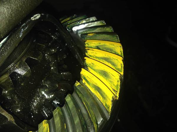

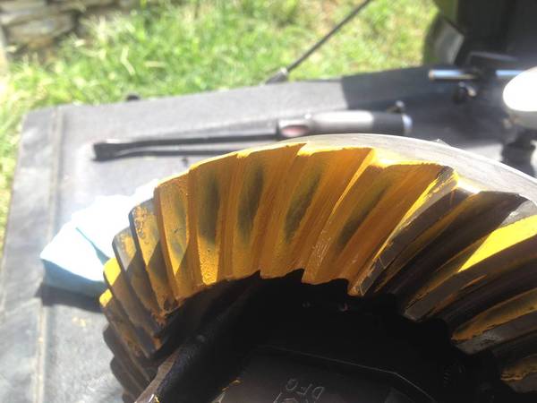

5.29's with solid spacers
30 spline long fields
Chromo inner and outer hub gears
Arp hub studs
Tg diff armor

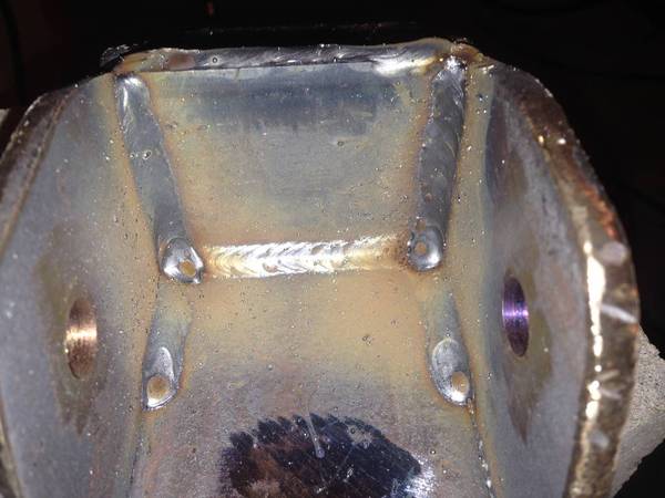

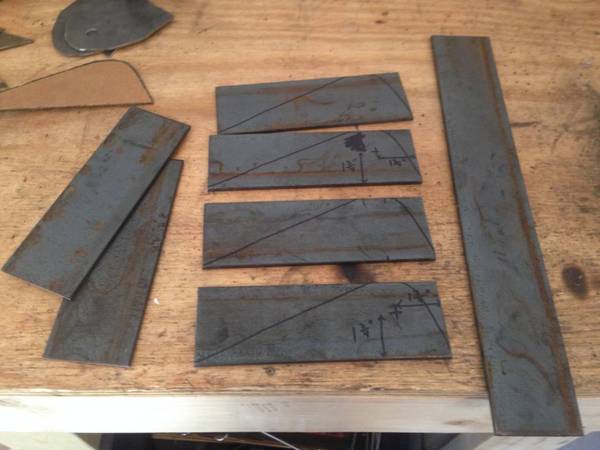

Knuckleball gussets
Axle truss
Marlin axle seals
Tg rock rings and wipers

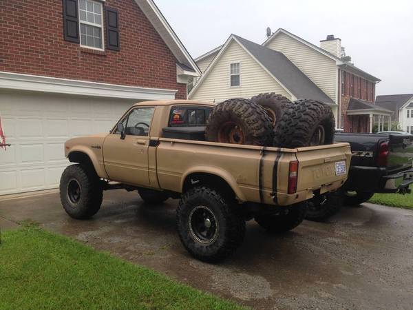

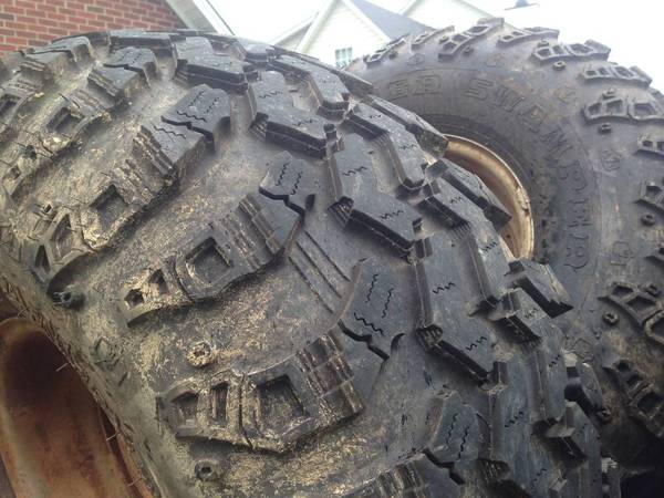

Craigslist special 37x14x15 Irok's on steelies

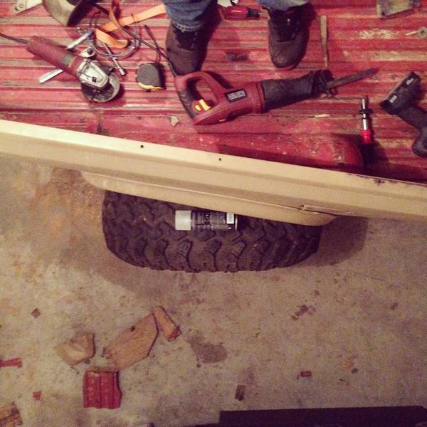

Next came an 8" bob
Pretty good fitment for a 4.5" angler grinder and some tape

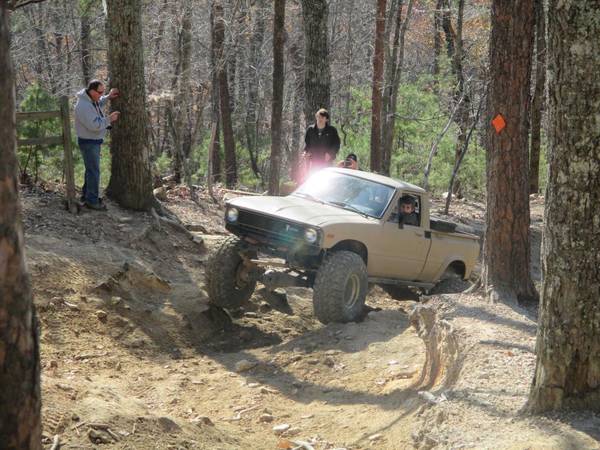

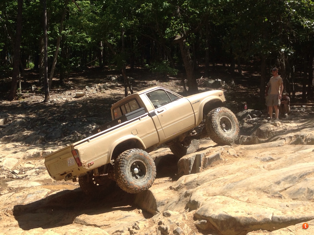

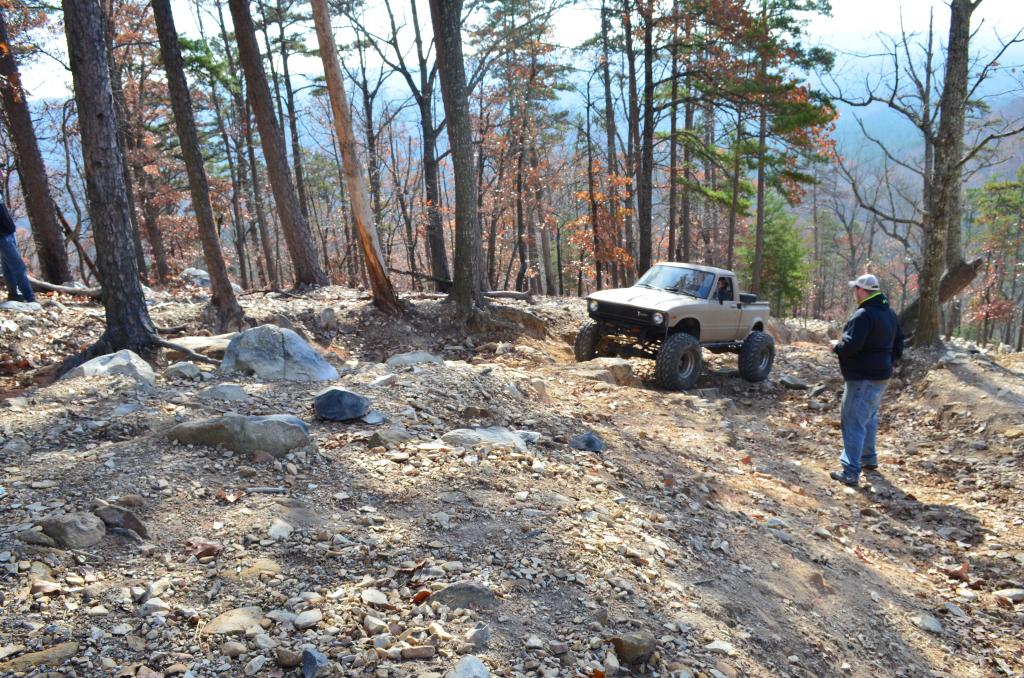

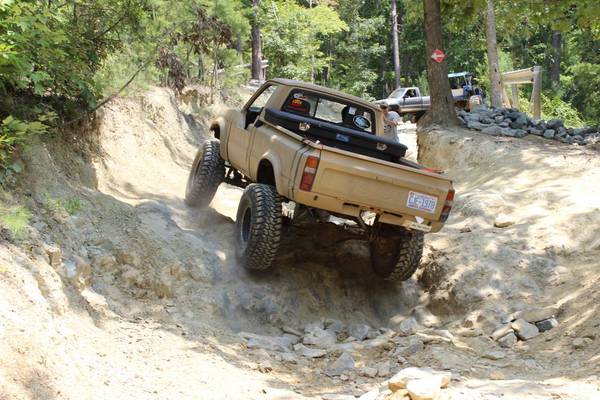

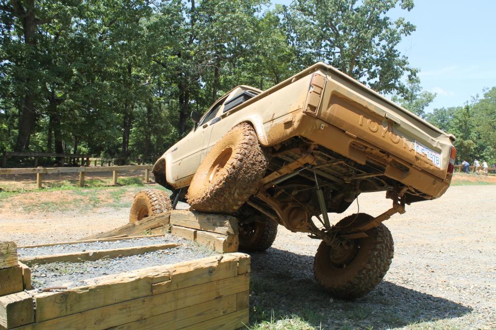

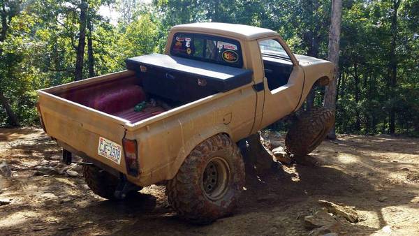

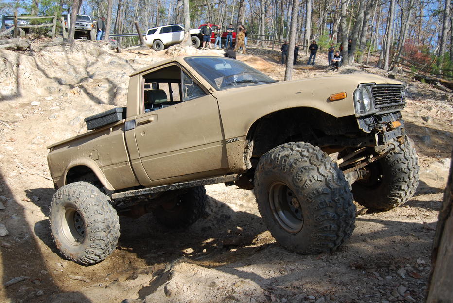

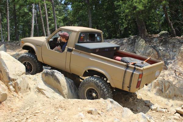

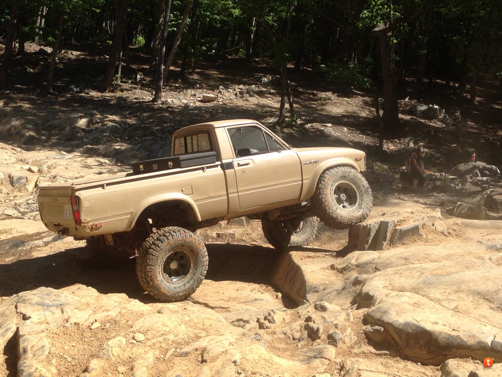

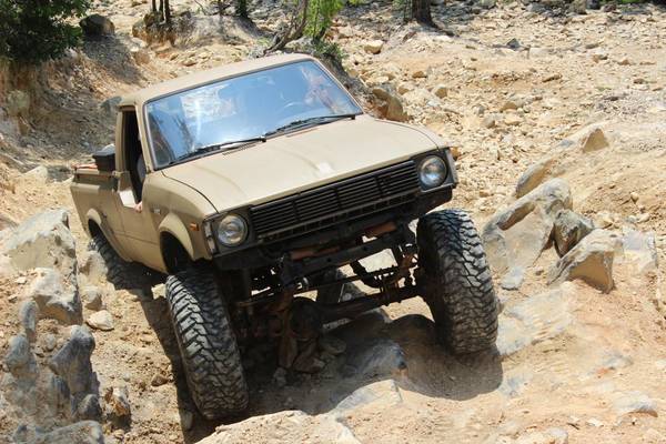

Couple shots from Uwharrie. This is full droop full stuff all 4 corners. Limiting factors in the front are the brake lines and banana shackle hitting the body mount on the droop side and I'm eating the fender and the shock is fully compressed on the driver's side. Rear is in the fender on the pass side and shock fully extended on driver.

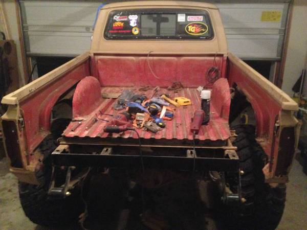

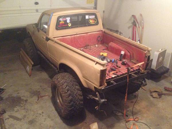

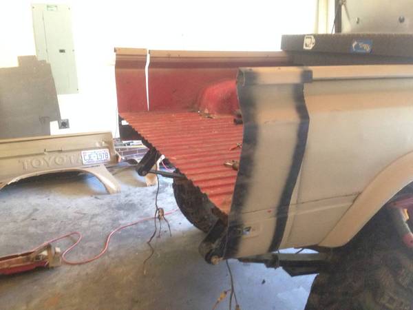

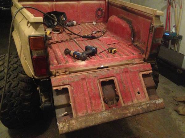

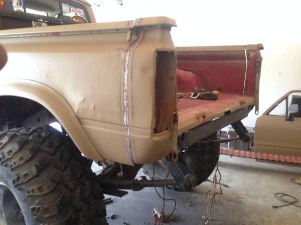

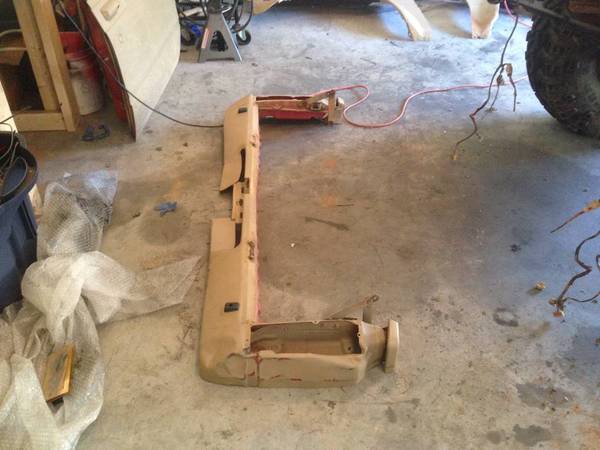

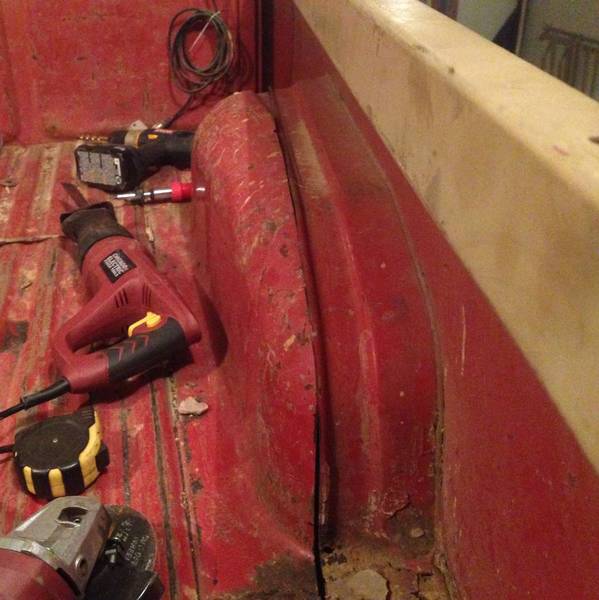

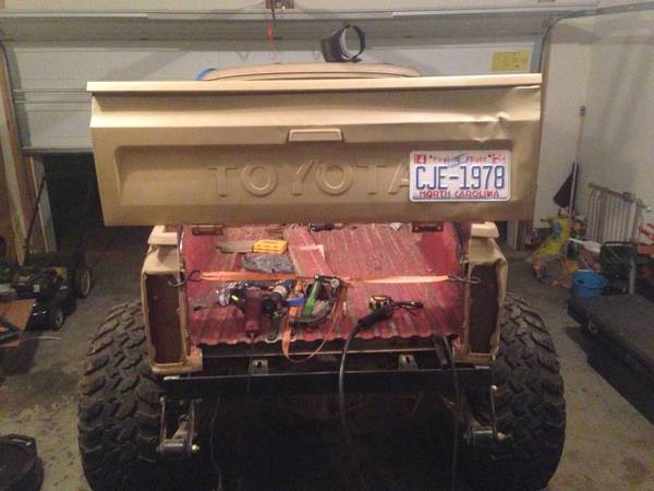

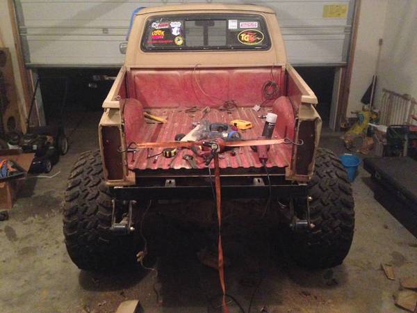

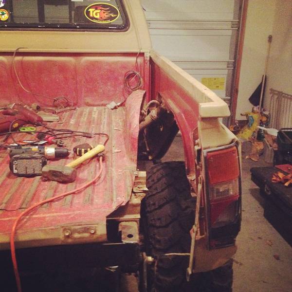

Got bored after a month or so and decided to dovetail 16"
Used a laser like you hang pictures with to get a straight line over the fenderwells
Worked pretty damn good

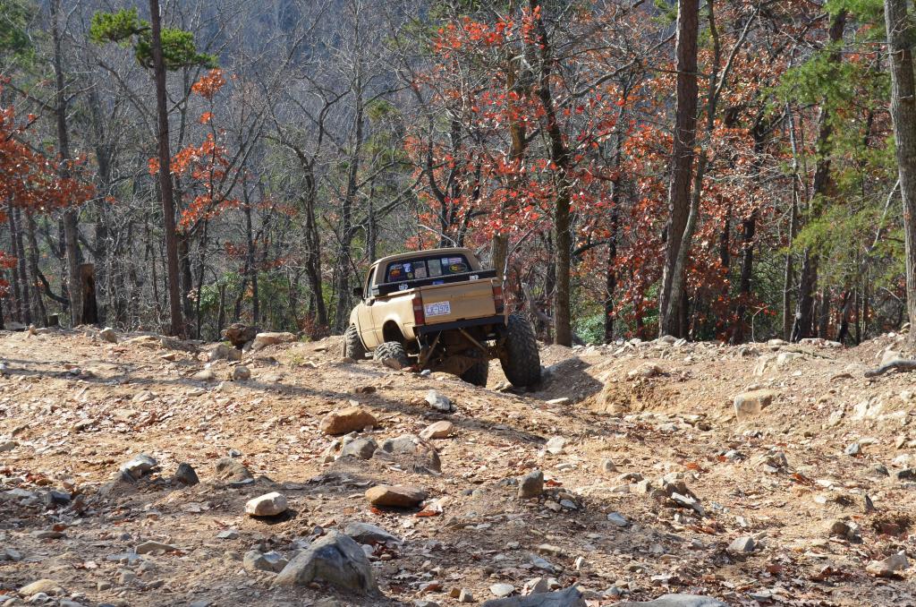

More URE

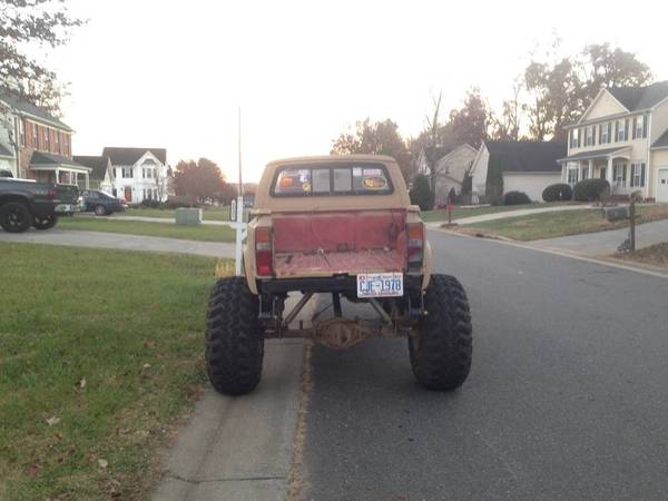

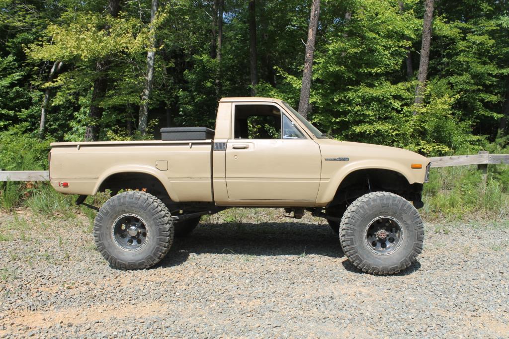

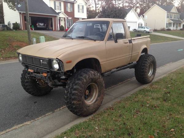

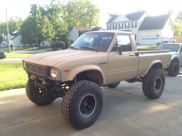

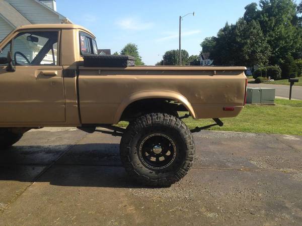

And that about gets me caught up. How it sits as of now
