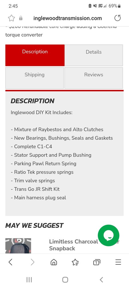

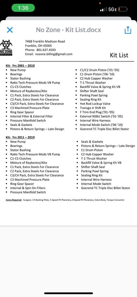

Just FWIW, here's a parts list comparison. Kinda follows suit too. Evan wouldn't really tell me much on the phone. I'd still buy from him if I needed to though.
With the same converter (Goerend DK), Evan's kit is 3745. The No Zone is 3630. So the prices aren't far off. You do get a whole new pump, wiring, and internal electronics though...which is nice.
