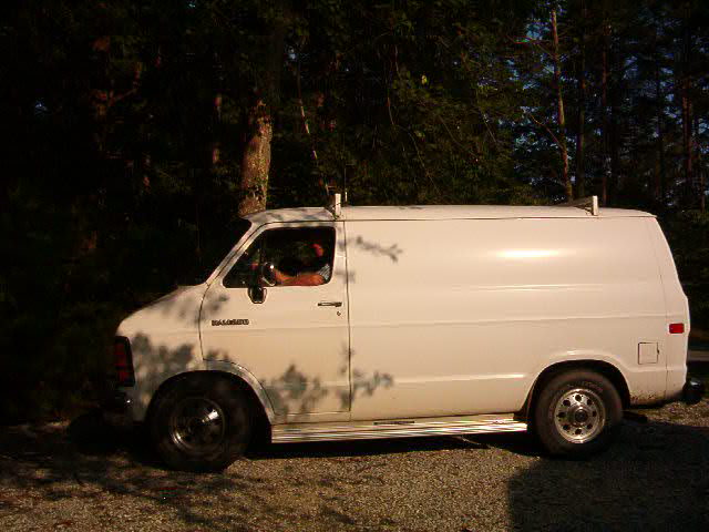

I am starting a business and need something that can pull an 18' flatbed car trailer with a car on it. I plan on rebuilding/flipping cars and need a tow rig.
By grandfather has this Ram Van 150 with the 3.9L V6 in it. He's selling it but no one is buying it, he'd probably give it to me if I asked.
It is a short 110" wheelbase panel van. Max towing capacity on it is like 6300lbs. I know he's towed a 41 Packard Clipper Sedan up through the mountains on a dolly with it with no problem.
Ideally I'd rather have one with a V8 in it, but the V6 in this is like 180hp/225tq which is about on par with a early 90s TBI SBC.
What do you guys think? I'd rather have a 70s-80s crew cab Chevy, but can't beat the price on this one.......

You know, now that I think about it, it might actually be a 250. He bought it brand new in 1992 for his electrician business, we've hauled all kinds of stuff around with the thing over the years!
Free candy.
Free candy.
I don't think they ever put a V6 in a 250 series Dodge van, but I could be wrong. I also don't think the 250 was available in that short a wheelbase, but again, I could be wrong. I can't zoom in on the emblem enough to see if it's a 1 or a 2.
I don't think the risk is worth it. Chip is right, it's not designed to do what you want to do and if you modify it you still have a short WB.
