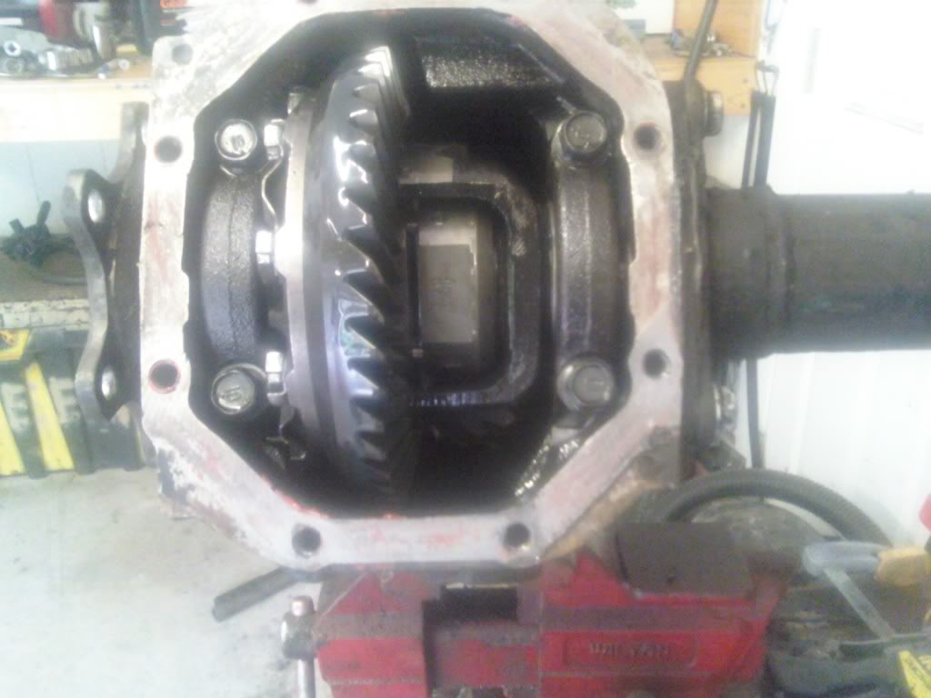

Dave, the half shafts have to come off anyways. Just 7 more bolts to drop the whole thing. IIRC, the carrier is a PITA to get out and back in. It has shims for preload instead of adjusters like the 8" thirds. Dont know how much this will help, but here is a pic from when I did mine.
Thanks, I installed one (this same one) several years ago, removed it when I started racing, I remember the shims.
