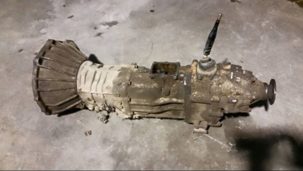

Looking to upgrade the four-speed manual in my 1980 Toyota to a five speed. Guy on the local for sale site has this but only knows that it is a five speed from an “early 80’s” Toyota truck. Can someone help me ID what model it is. He is asking 300 for the set up is that a fair price?
Probably a G series 52 or 54? If it' early 80's They aren't bad transmissions, but the w series seem to be more desirable.
I have been out of the Toyota world for about 15 years but bought a 1980 RN37 so I’m trying to get my head wrapped back around the good/bad/ugly of Toyota parts and try to flush out the dozen or so Jeeps I have had in the interim.

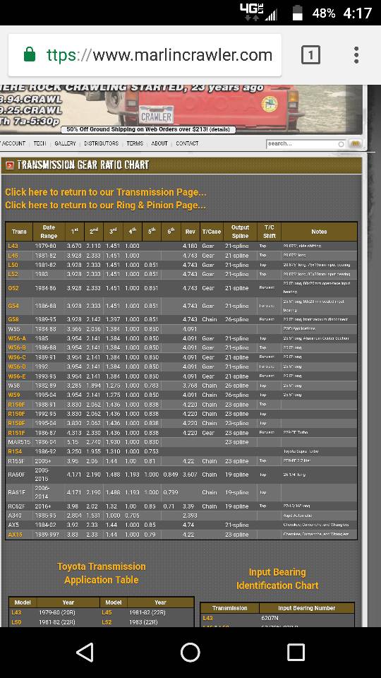

So talked to the guy some more and he had misspoke. It is from the late eighties. Based on the site that @Bhudgins posted and looking at the pics I’m leaning towards a w56b model. It seems to match the pic that Marlin has on their website. Most notably the top shift tcase not forward shift and also there are the hex plugs in the middle of the case halves. What say you? And, if it is a W series with the t case is 300 a fair price?
View attachment 260784 So talked to the guy some more and he had misspoke. It is from the late eighties. Based on the site that @Bhudgins posted and looking at the pics I’m leaning towards a w56b model. It seems to match the pic that Marlin has on their website. Most notably the top shift tcase not forward shift and also there are the hex plugs in the middle of the case halves. What say you? And, if it is a W series with the t case is 300 a fair price?
I’m with you. Looks just like my W56 in my 4Runner except mine is an A. I think 300 is alright as long as the case is good. I bought a W56C and case the other day for 40bucks. He thought it was locked up but it was actually the case. It looked like he ran it without sufficient lubricantion. Talk him down to 225.
