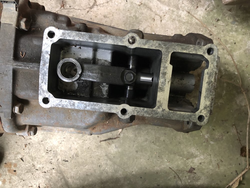

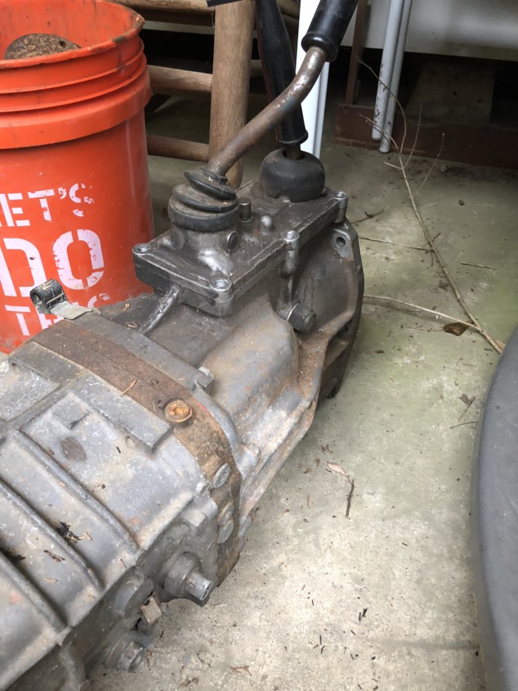

The 5spd trans I have0039DFB5-A1F5-4EBC-8A58-4CD711A92A53.jpegA73BBEAE-9430-4B7C-8C59-778003D8AB74.jpeg

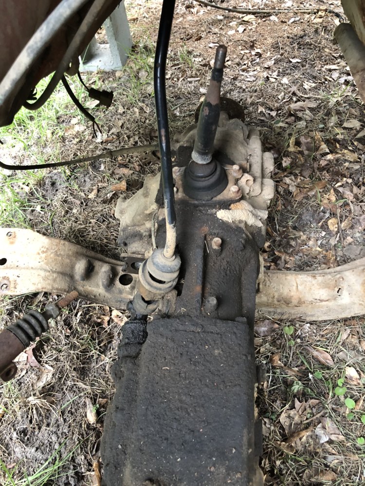

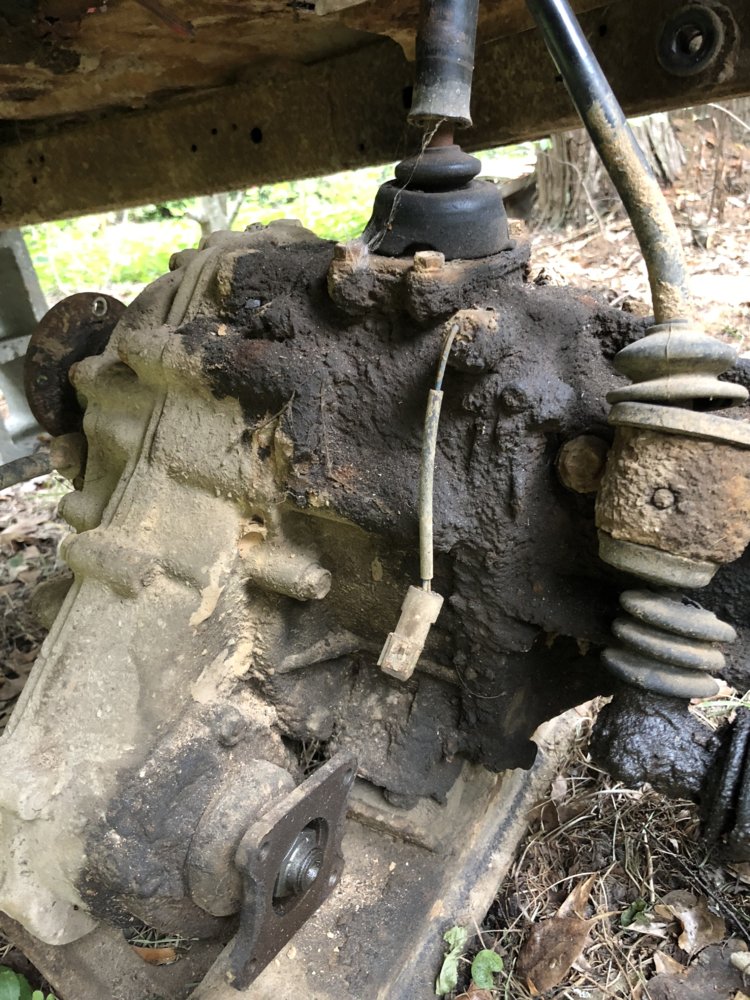

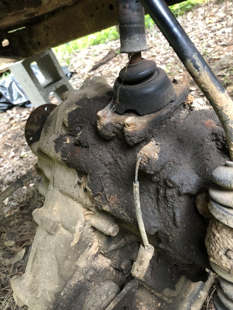

My old 4spd and tcase sorry it’s so nasty I wasn’t going to power wash it if I couldn’t use it
@BigGreenMonster do you think I could just pull the tcase shift handle out of the 6 bolt top plate and roll with it (given I’d seal the hole it left)?

I am pretty sure that is a g54... It is probably just as good as a w56.
I think what you can do, is take the fwd shift shifter and cut it off above and below the cup. Then reinstall it like it was whole. That will plug the hole. The top shift case should be self sufficient. I am fairly certain I did something like that for a brief time while I ran the g54 tranny... I think I had the shifter in there just floppin around. The mounting face and splines are the same.
